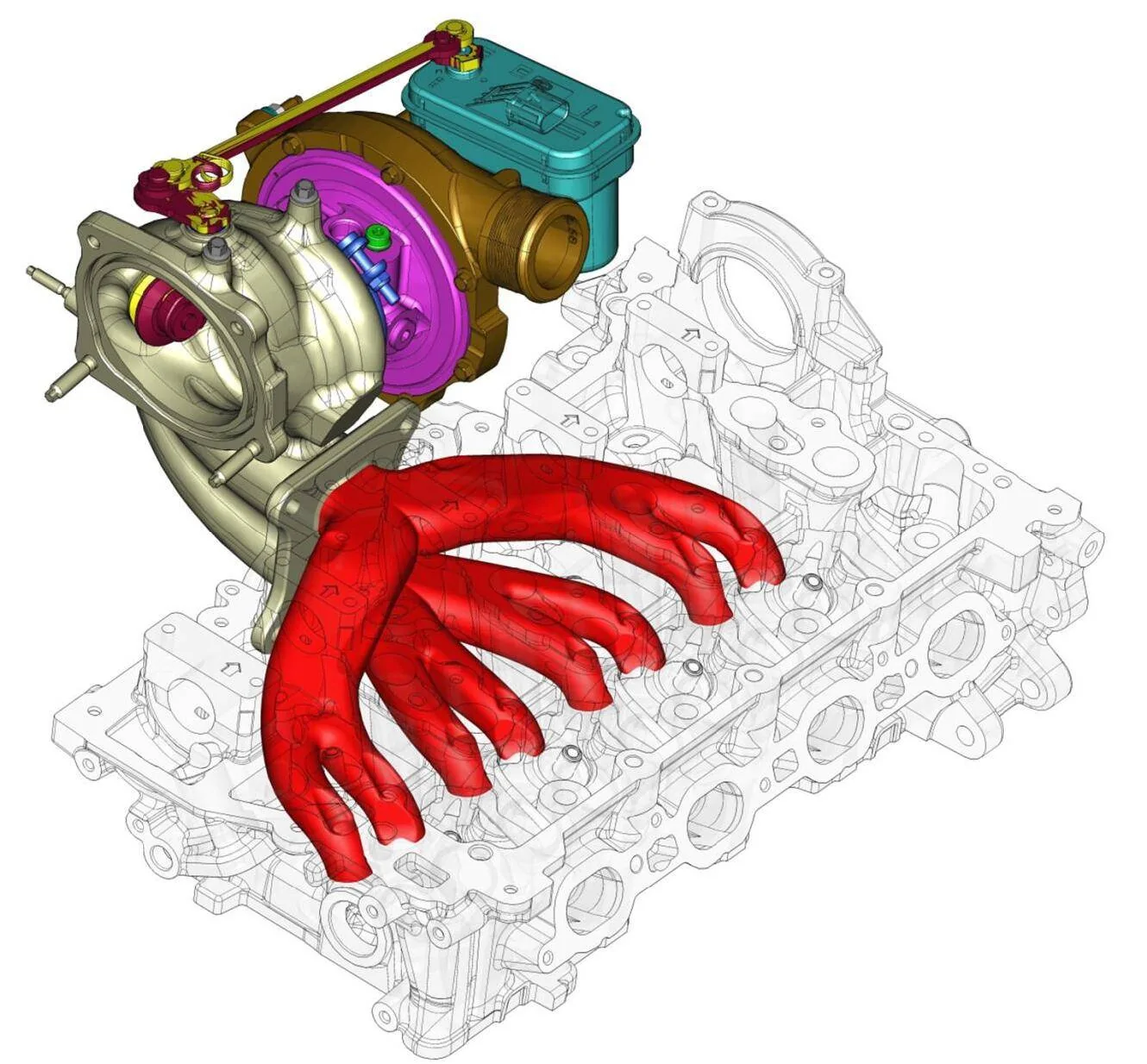

Where is the actuator located? My Jeep started throwing this error as well.
