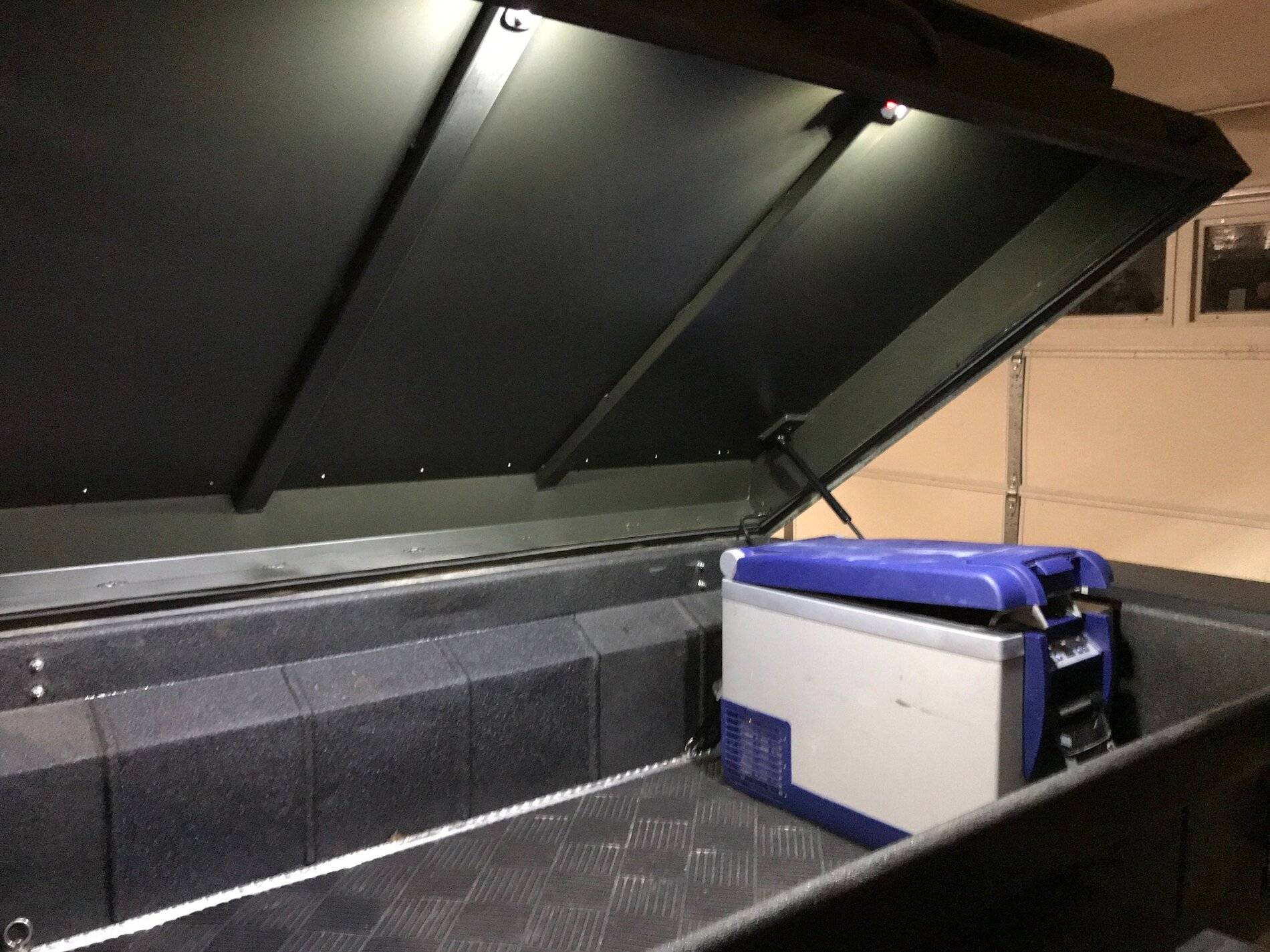

I'd recommend looking at M101 CDN (canadian) or M416. The M1101 is very big and designed for full size vehicles. I built an m416 up for camping and works great. Having weight up high has downsides but reversing out of a trail is a lot easier than with a trailer. I don't like having weight up high for the offcamber and low hanging branches I go thru. I have had some very challenging situations snow wheeling and reversing a long way down a narrow trail on an edge of a steep hill. With how many people i see struggle with reversing trailers (even people who tow them all day long like gardeners), trailers are clearly not for everyone.
An M416 is about 6ft bed and just shy of 3ft wide. With my lid I think I have about 2.5ft height (I can't quite remember if that height is correct). I have 3 young kids, a wife and dog(s) so the jeep fills up fast. For a trailer I prefer to keep is simple and have a special wiring set up so I can charge its battery thru the 7pin w/o needing separate connectors. All I run is a fridge in the trailer and some lights. I'm currently revamping it to match my JL, since this one was built to match my JK. I don't have many pics from the trail because I'm really bad about that, I get so wrapped up in the fun I don't stop and think about getting pics. All my shots are from the campsite or when I travel with someone and they got a shot for me (many back shots).
inside
pre-trip
one of my favorite shots, Mojave Road in SoCal
I'm currently building an M416 and it makes me appreciate how nice this is.

Thanks, it was a lot of work. But a work of passion to match a fantasy I didn't think I'd every actually do. Nice thing about a trailer like this is it doesn't take much work once done. Some basic hub maintenance and occasional cleaning. I like working on trailers, they're really simple and there is no CanBus or anything you have to worry about; its like working on old cars. Any electronics are just simple power draw calculations and tapping into other lines does not cause errors if you don't overload a circuit.
If I was going to 100% rebuild it, I think it would nix the axle and find a good set of those axleless suspension hubs (can't remember what they're called) that would hold up to offroading and have adjustability for spring weight and ride height.

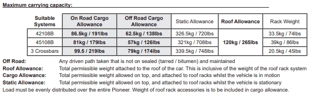

What I meant was that the Backbone mounting system + Pioneer Platform only supports a dynamic weight of 191lbs for on-road and 138lb for off-road.
The iKamper 2.0 is 160lbs and the batwing is about 50lbs..making it 210lbs total.
Jeep Wrangler JL Overland Jeeps 1644266759619
https://assets.rhinorack.com/Instructions/Parts/FittingApplications/RJLB1.pdf
Reason why I'm asking is because I'm shopping for an awning...and this is one of my worries.

Well all I can say is that I have had no issues with it. I’ve never driven this Jeep without the rack, RTT and awning so I can’t compare the handling or difference with the higher CG. The rack is really solid.
Here’s a video (I may have already posted?) of lots of similar iKamper setups. No one mentioned any issues being overweight..

I guess the manufacturer built in some tolerance. I wasn't worried too much about driving dynamics, but rather the structure integrity of the rack itself. Biggest fear would be cracked hardtop and the whole thing collapses in...LOL.

While the pioneer platform has metal support structure, weight is still on hardtop. The rack is well designed and good quality; I wouldn't worry too much about the rack itself failing. I would not push your luck if its going to be well beyond their declared loads. A few pounds, 10 lb maybe not a worry. 20lb over their advised limit would make me hesitant. My experience with aftermarket companies is their testing is not as rigorous as OEMs and with sun age, material derogation over time, etc you might get a lower strength reliance out of your roof that develops over time. just my opinion, doesn't have to be yours.

In your post on pg4, you said you have the pioneer rack (42108B).
So the on-road capacity is 191lb and off-road is 138lb.
Anyways, my initial question was really just asking if you ever worried about the dynamic weight capacity of the tent + awning combined (210lbs).
Based on your experience, it seems like there's no concern with your setup. So that's good news for people like me looking for a similar setup. Thanks.
