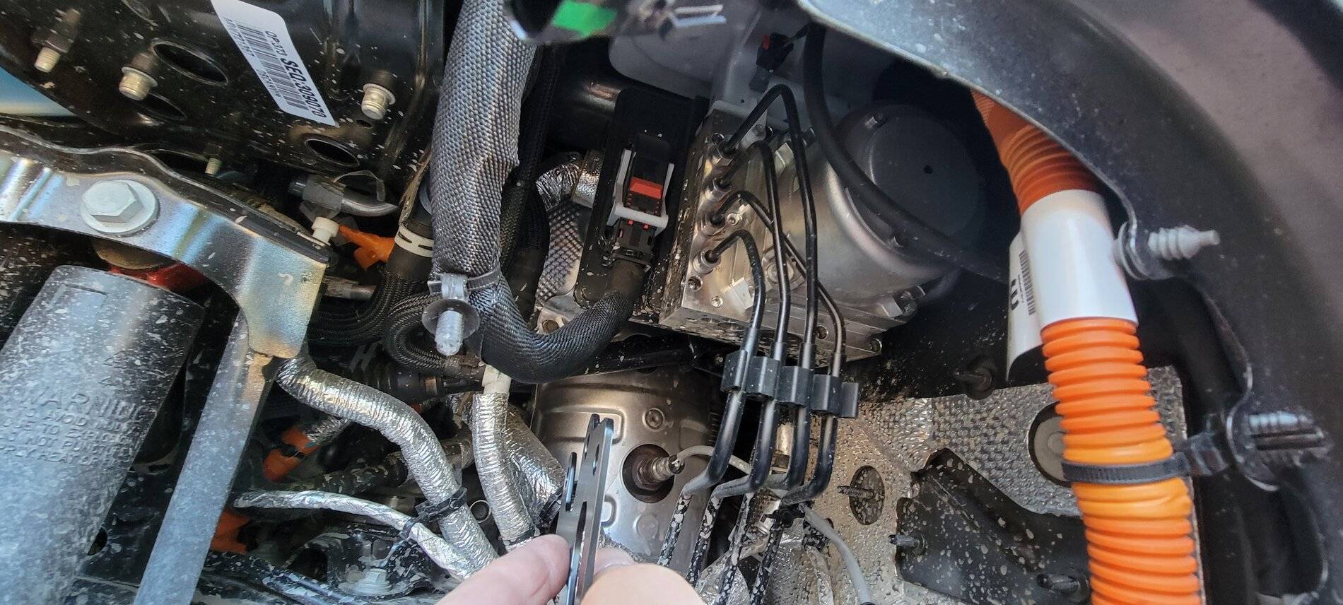

There is no way this bracket will fit without serious modifications. The biggest obstacle is the location of the brake lines. Without bending them both passenger side and skyward, there is no way to bolt the bracket to the firewall. In this image I am already encountering the brake lines and I am not even close to reaching the firewall bolts:
Jeep Wrangler JL Onboard Air for 4xe 20210821_181644
If you manage to bend the brake lines out of the way (without damage), then you would need to contend with the fact that there is nothing to mount to for the top of the bracket as the brake system is different:
Jeep Wrangler JL Onboard Air for 4xe 20210821_181715
This will be going back and I will be trying the ARB under seat mount instead!
