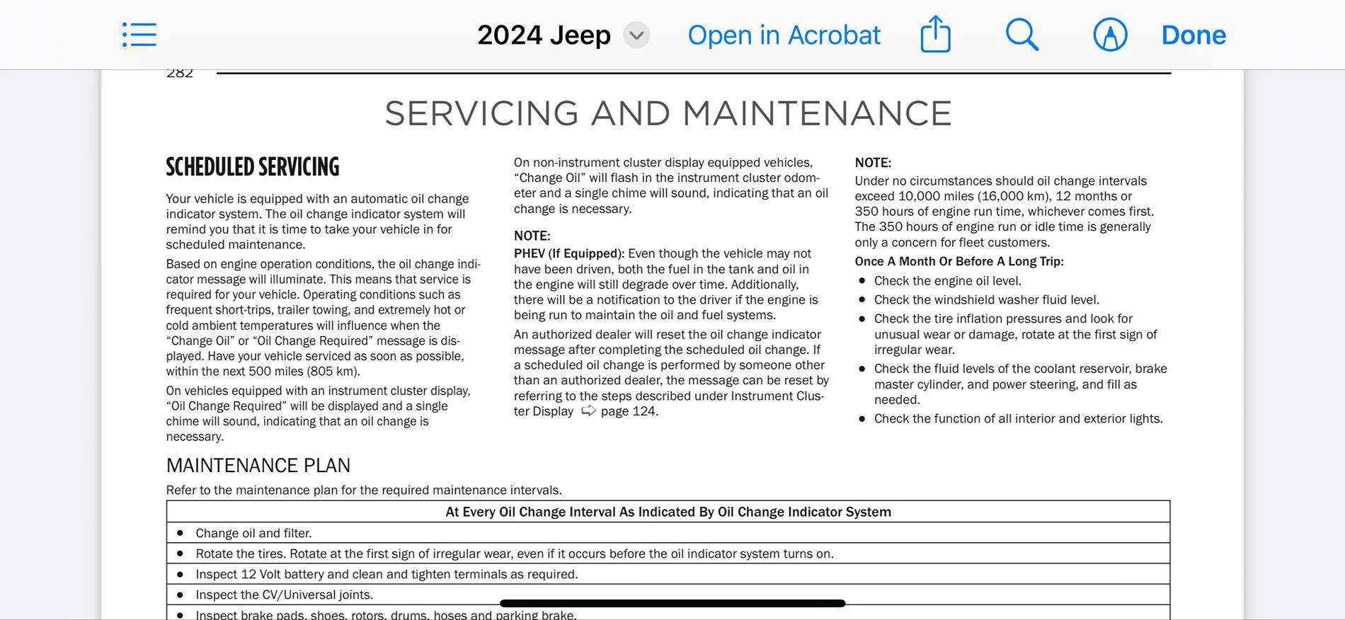

Change the oil when the computer says to, typically about every 10,000 miles per the owners manual. For the 392 it’s every 6,000. Others do it more often than this, but they are just throwing their money away but to each their own.
Jeep Wrangler JL "Oil Life" indicator? IMG_5517
Here we go the good old debate… there really is no one size fits all answer because of driving circumstances and use cases. So I don’t think people are by default just throwing their money away. Some are… some are not. Here’s another killer question:
Does it matter whether I go with Mopar oil or another brand?
I’m not sure why there is even a debate. Everyone thinks they are smarter than design engineers, but again to each their own. If those changing it at more frequent intervals than the manual states are not then testing the oil to see if it even needed changed then I can certainly argue they are throwing money away. I like factual data to make decisions.
