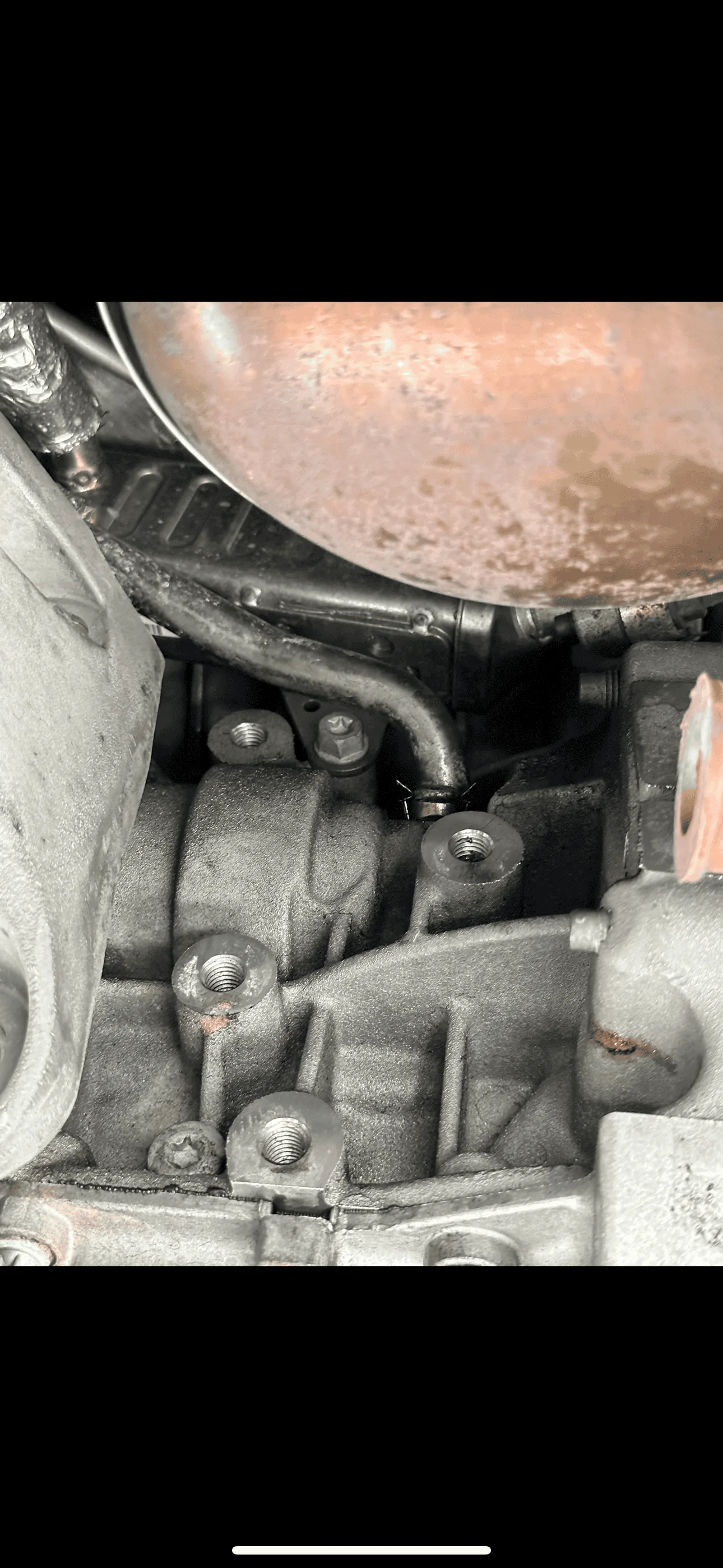

Is it leaking from the oil return line? Any photos where it’s coming from?
Mine was leaking from that tube, tightened the torx bolts and all was good.

The dealer checked to see if this was the problem stated it seemingly got worse, said the tube appeared to be cracked. Here’s hoping it fixes it!
