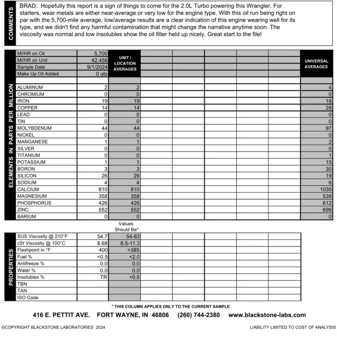

For our 2.0L I've just been using the STP filters from AutoZone...

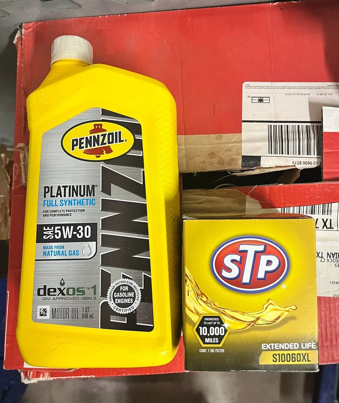

S10060XL or S10060? Looks like your oil holds up pretty well. What are you using?

Edit: Ditto on Pennzoil plat 5w30.

The oil would be the next thing to look at so thanks for sharing. I am curious how the 2.0T does on fuel dilution and Blackstone does not measure it accurately, but the viscosity looks good.

The STP XL is basically the same as a Fram XG, also similar to the Champ/Luber-Finer XL. All are 99% efficiency @ 20 micron. I run these filters in everything of mine and consider them among the best on the market.
If running Pennzoil in a turbo engines, I'd personally opt for the Ultra Platinum version.
