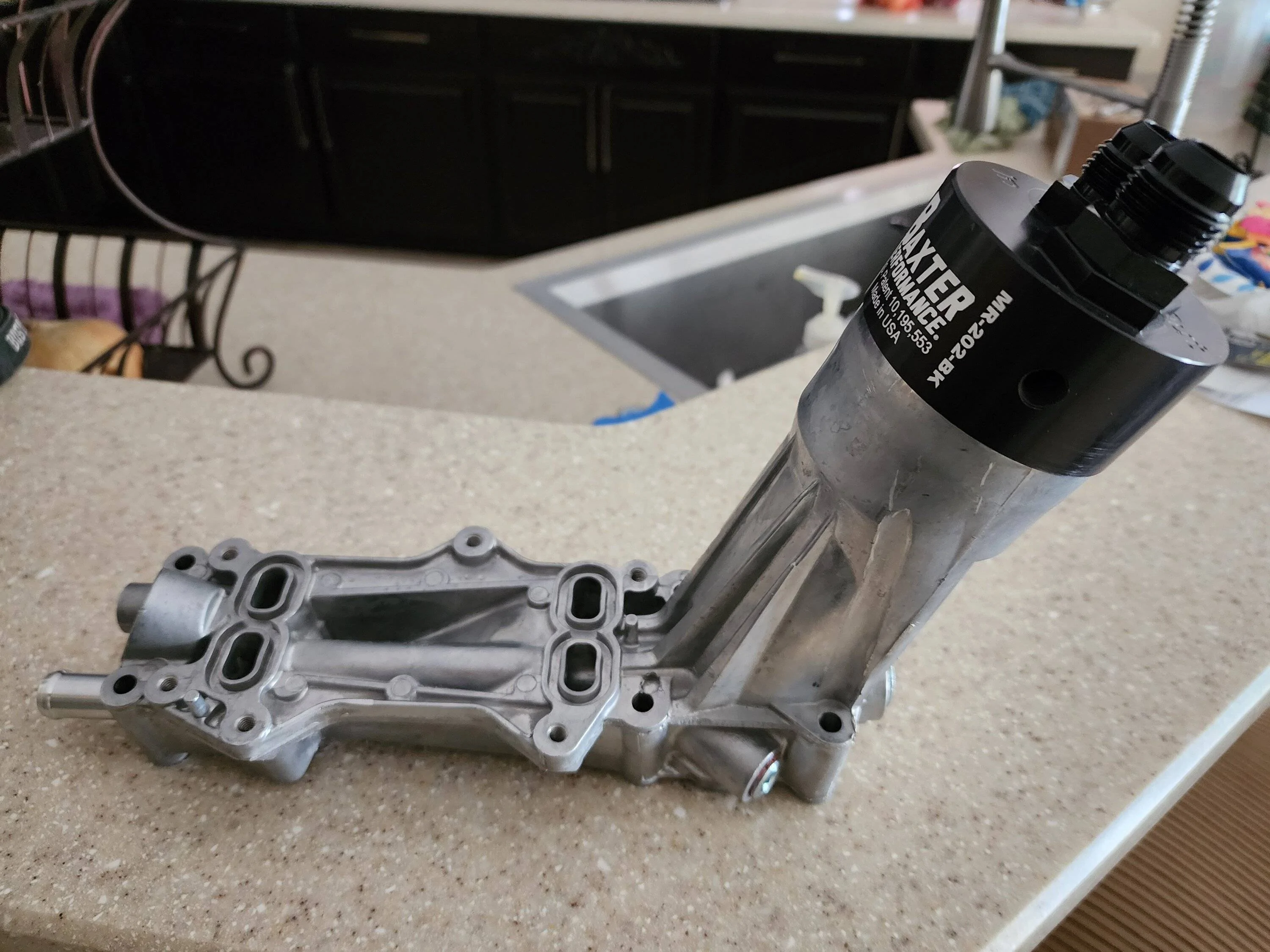

I am custom building the remote filter system using this in the oil filter housing:
https://www.baxterperformanceusa.co...er-mr-202-bk-cartridge-to-remote-adapter.html

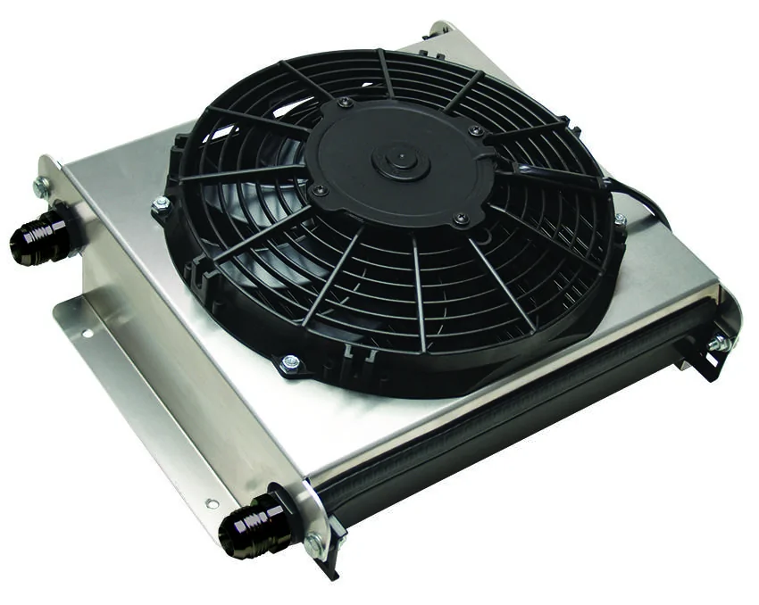

I will add a fan driven Derale 18 row cooler between the remote filter mount and the return line to the adapter.

I cant quite picture how that is going to fit there .. are there pics of it installed somewhere?
I can mock it up when I get home and post a photo. But picture removing the oil filter and the oil filter cap and screwing that in its place.

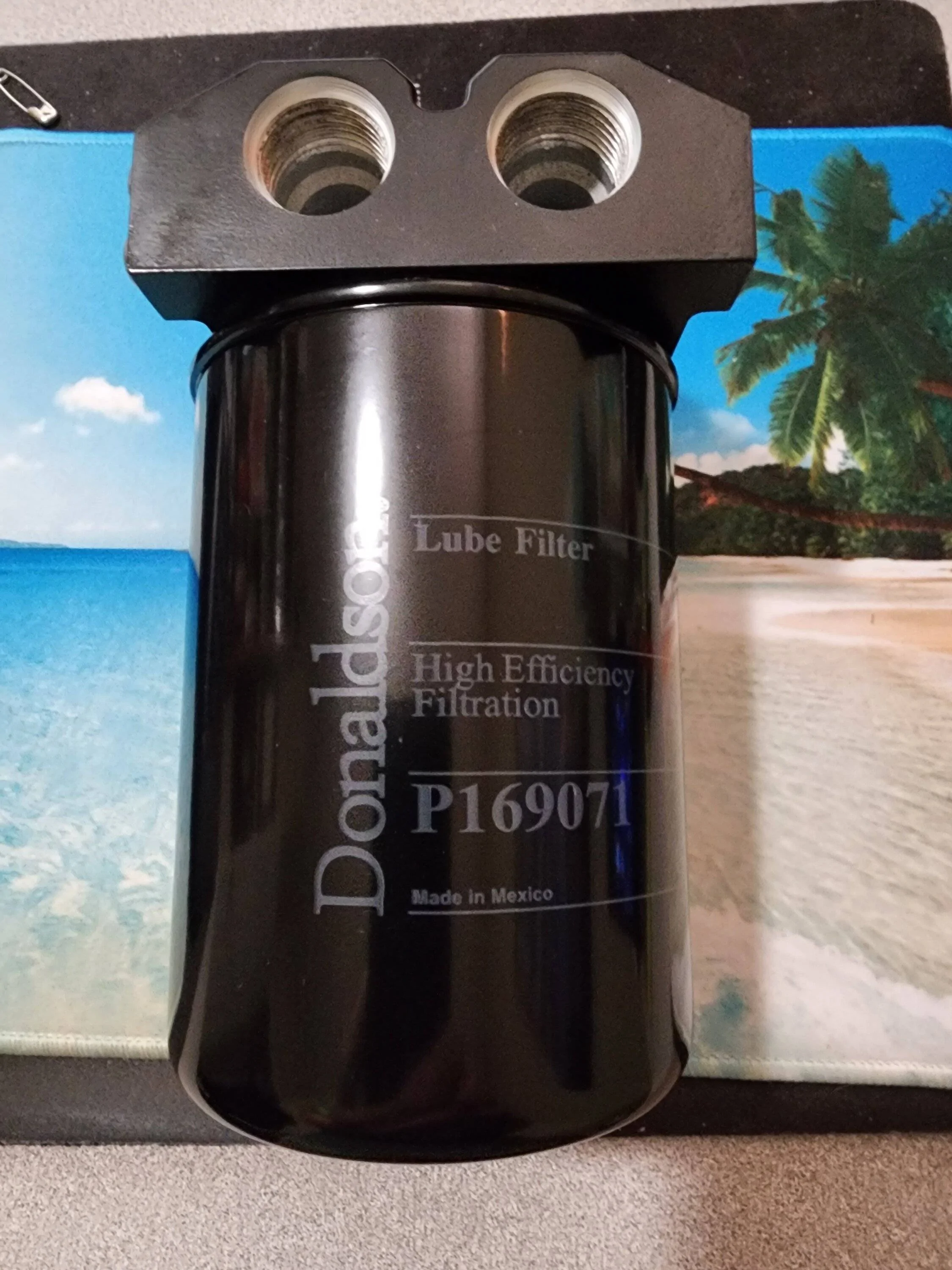

Hydraulic hoses would come off of that adapter and go down the side of the engine to the remote oil filter mount and from there over to the oil cooler and back again.
CarbonSteel
CarbonSteel
Jul 21, 2019
305
5,795
8,214
Here you go:
Jeep Wrangler JL Oil Cooler Replacement (and upgrades) 20230820_142902
You connect hydraulic hoses with -10AN fittings from the top of the adapter down to a remote filter adapter:
Jeep Wrangler JL Oil Cooler Replacement (and upgrades) 20230820_143356
From the remote filter adapter you route over to the oil cooler:
Jeep Wrangler JL Oil Cooler Replacement (and upgrades) 158754
Then back to the adapter. I am in the process of fabricating a mounting plate that will attach to the driver's side lower engine for the remote filter mount.
The next quest is finding a good location for the oil cooler itself.
The overall objective here is to increase the cooling, but also to never touch the oil filter housing again as I believe that over time the loosing and tightening of the cap/filter contributes to the leaks.

Here you go:
Thanks ...I'm sold ...nice ...where do you get the correct thread sizes and lines to plumb it?
