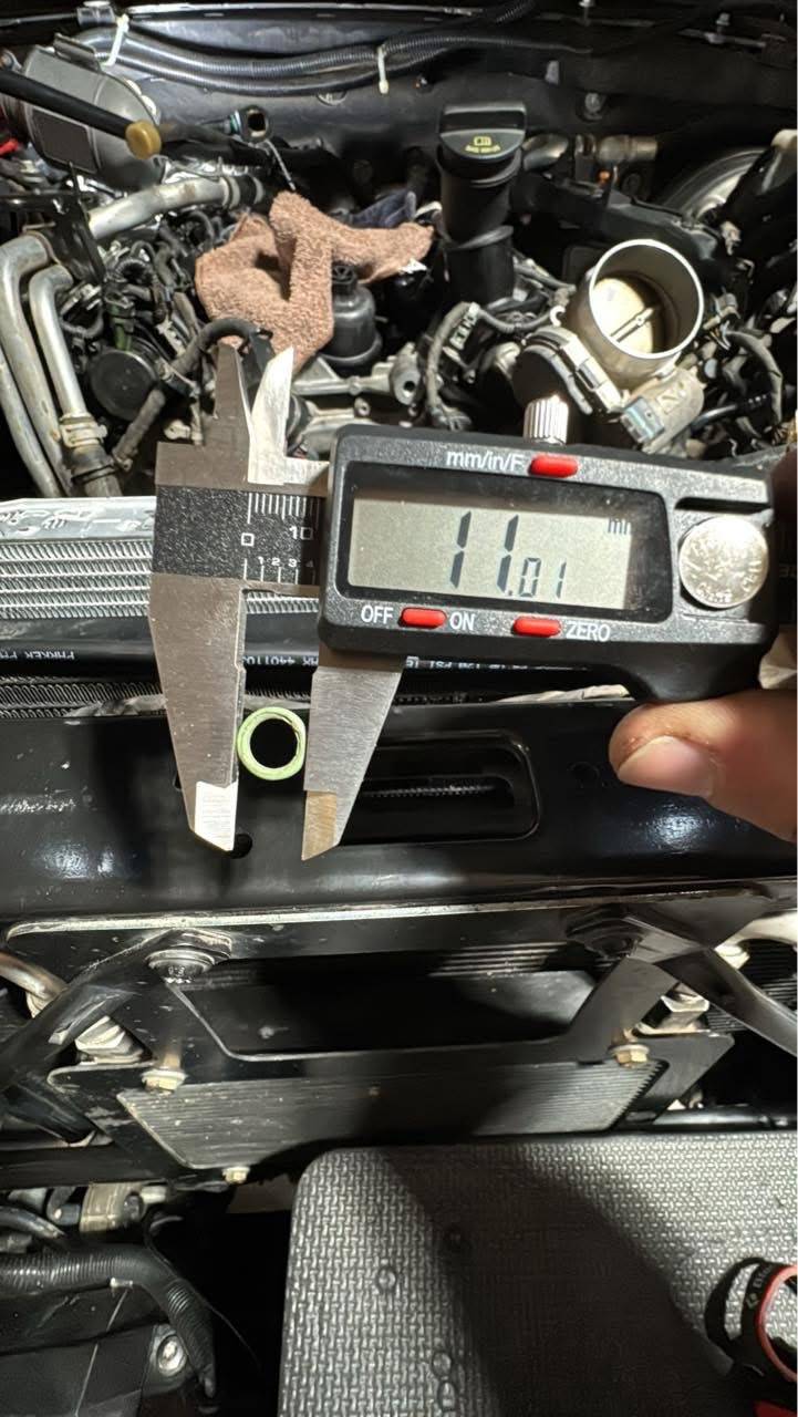

Hey, when you were doing this install and the cover seals did you ever come across this teeny tiny green o ring? I had a parts back order for many months and finally got around to finishing the job. I cannot recall where it came from. I placed it separate from everything else so it wouldn’t get lost, but I’ve managed to come across some severe brain loss.
Thanks!
Thanks!
Probably around the part that sticks *into* the block. Has a small o-ring around it like that

Those colored O-rings are usually on sensors. It may also be from an aftermarket oil filter tip.

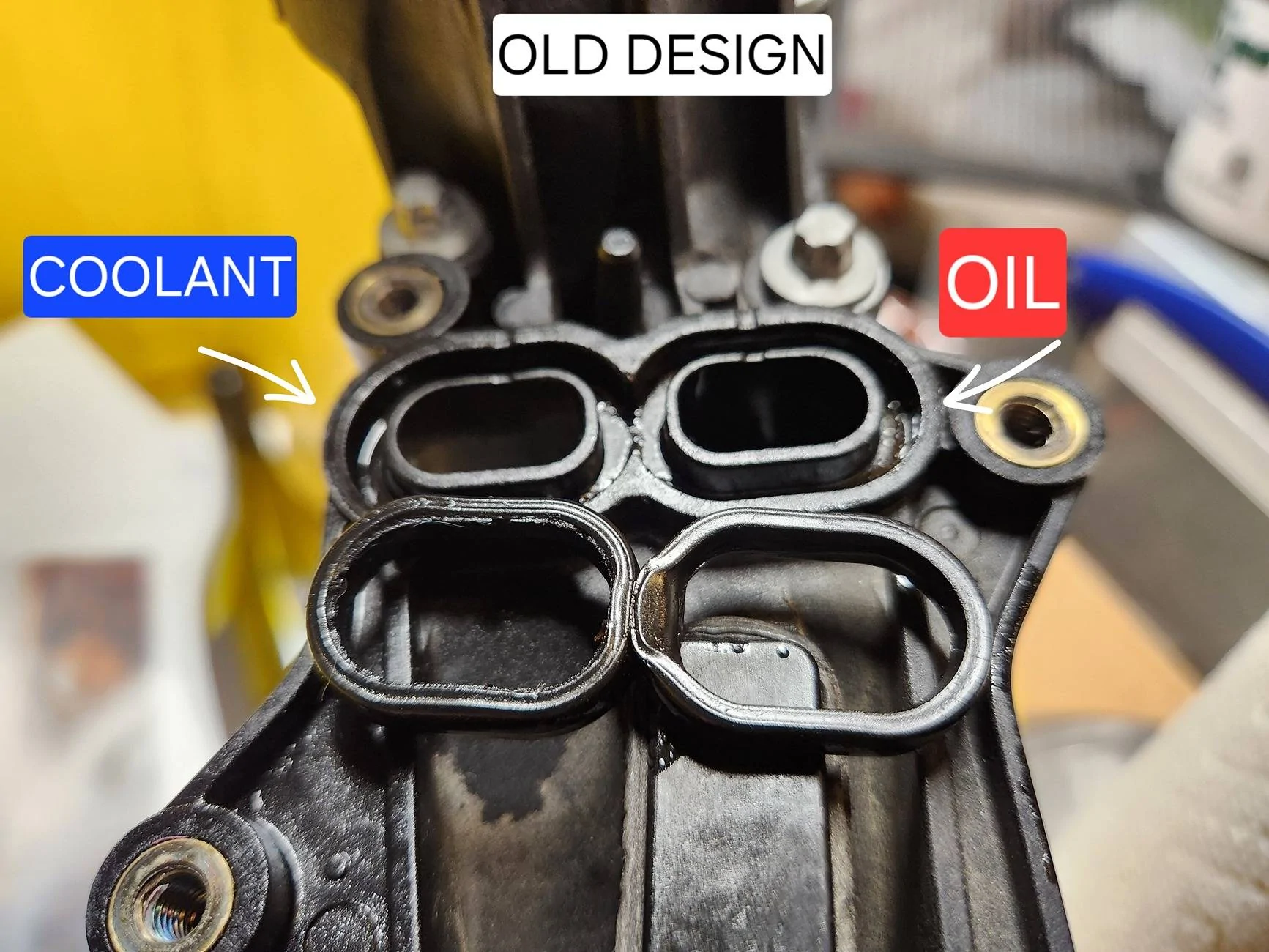

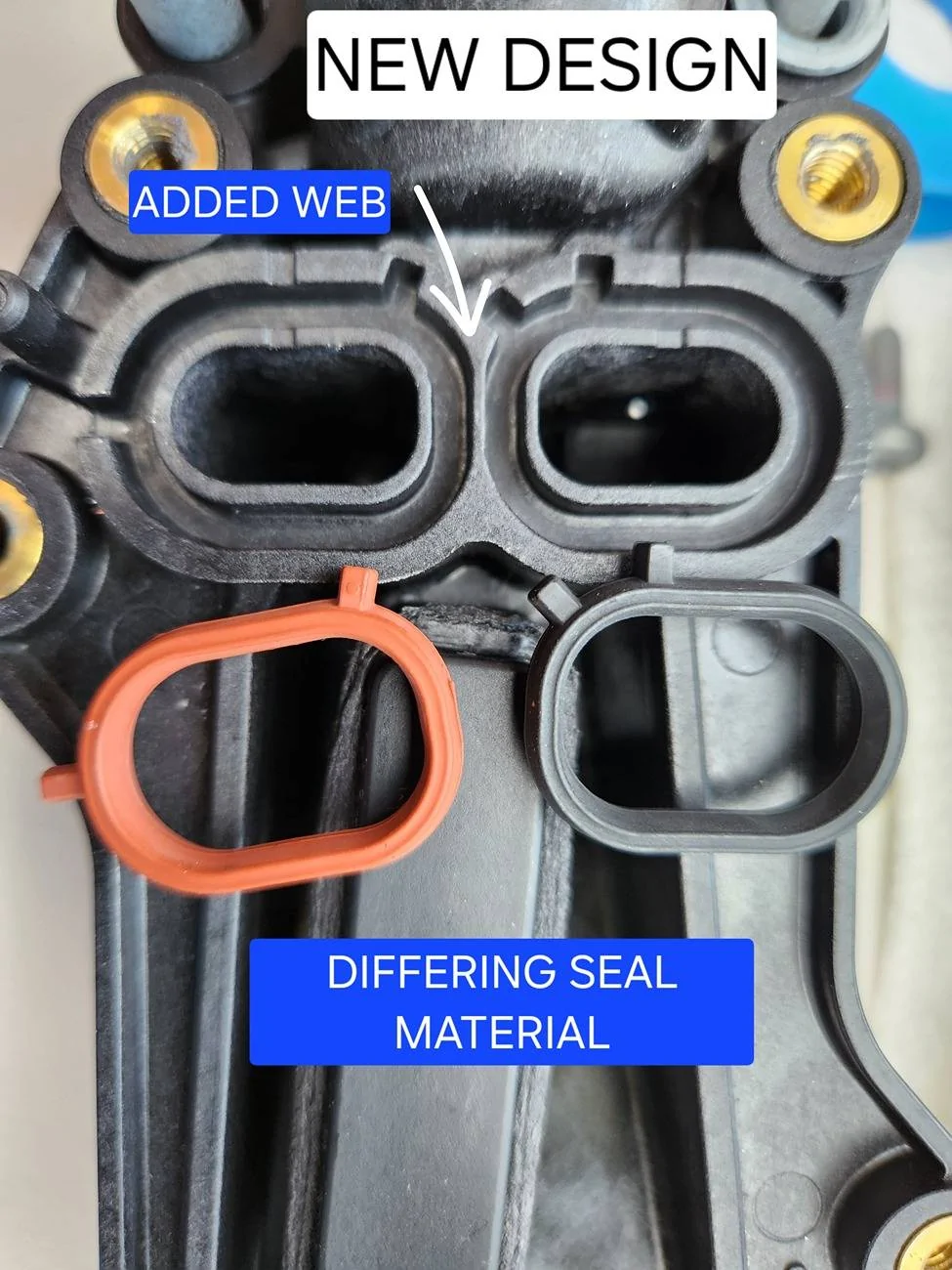

Sometime before 2024 models but I think after 2022, there was an important revision to the Oil Filter Housing. This change was implemented on the 2024 JT engine I installed last year. It had a different production part number, but it was physically the same as the over the counter repair part 68596318AB that has superseded the earlier part number. There is also a part 68596317AB with 2 sensor ports for the JK. Neither part now comes with the sensors, or at least as of the last time someone bought them on another forum.
The change to both of these parts is between the cooler and the filter housing. The old "figure 8" seals are replaced by separate seals and the housing mold has incorporated a solid web between the oil and adjacent coolant ports in the two locations. I discovered this when investigating why my oil had coolant in it.
The oil pressure breaches the seals and pushes into the coolant port. When the engine is shut down, the oil pressure subsides to zero pressure and the coolant system pressure remains at normal operating pressure until it cools (15-18 psi), which pushes coolant into the oil system.
The new style housing and seals prevent this exchange of coolant and oil back and forth.
The pictures below are of my old OEM 2018 JL oil filter housing and the replacement I bought in early 2024. It's a subtle, but important change, IMO.

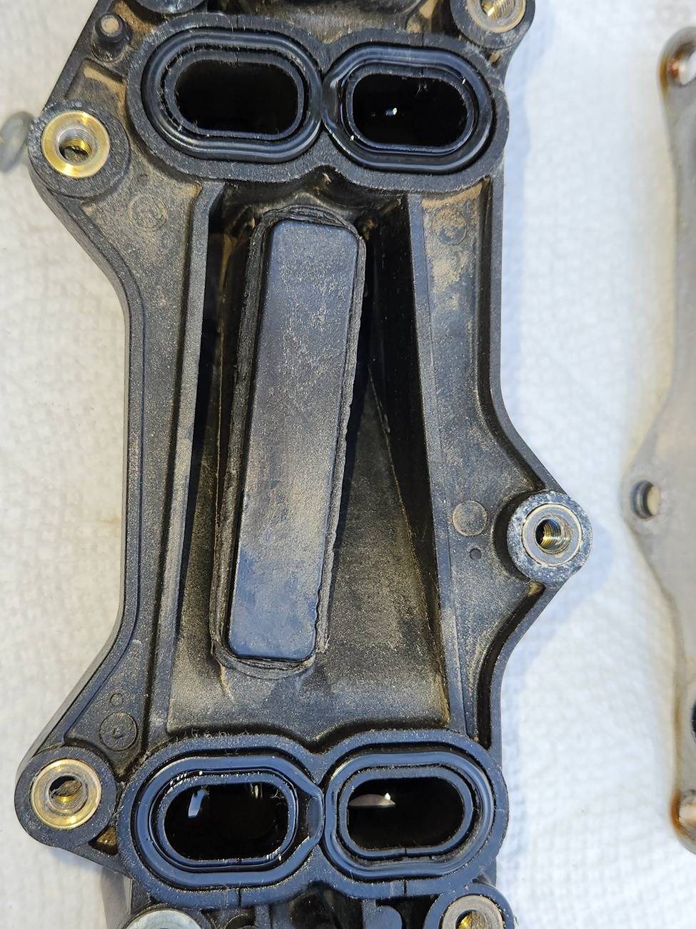

I don't think its a "gotta do it this weekend" job. But, don't put it off for months.
After you remove the old housing, zip the cooler off of the housing and inspect the seals for the leak between the oil and coolant ports. Please post your pix. Not many people have investigated this when they replace these.
