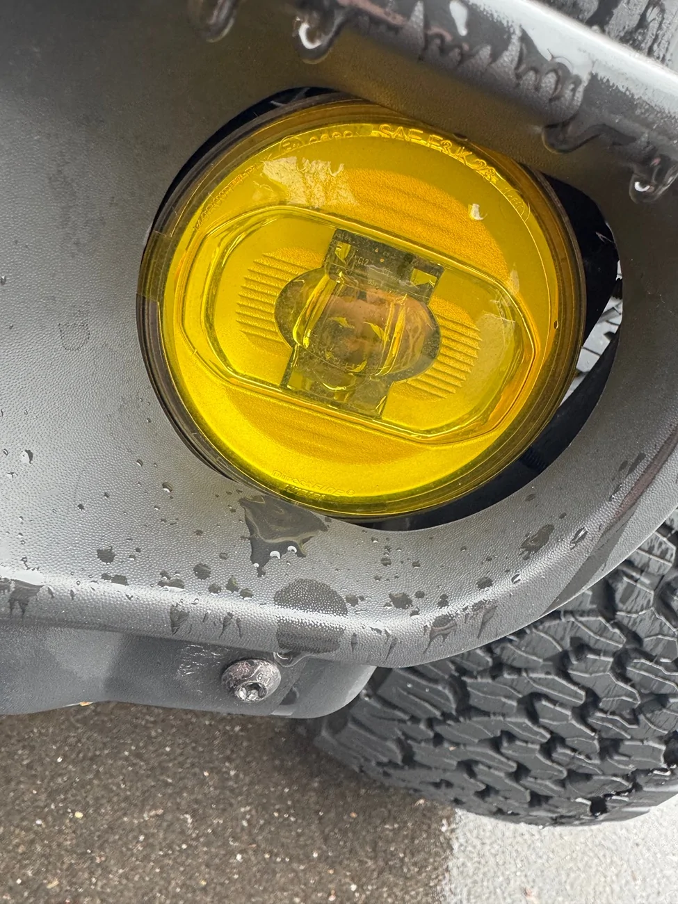

These are the Laminex covers on the OEM fogs.It was recommended that I get the "Amber" ones instead of "Yellow", since the LED's looked more yellow with the amber, and more greenish with the yellow covers.

I wondered about these but have been kind of worried they would not lay completely flat on the curved surface.
They are thicker than I thought they'd be, but curve and stick very well. Good surface prep, took my time, and did it in the sun on a warm day. You can use a hair drier to help, but it's not needed if the lights and filters are reasonably warm (I wouldn't recommend a heat gun. These are remarkably soft and pliable for how "thick" they are.)
On my plastic sport bumper, they could be installed without removing the bulbs, but I took them out of the bumper while I had it off to do other things. That made the installation VERY easy. Less than 5 minutes per bulb...
