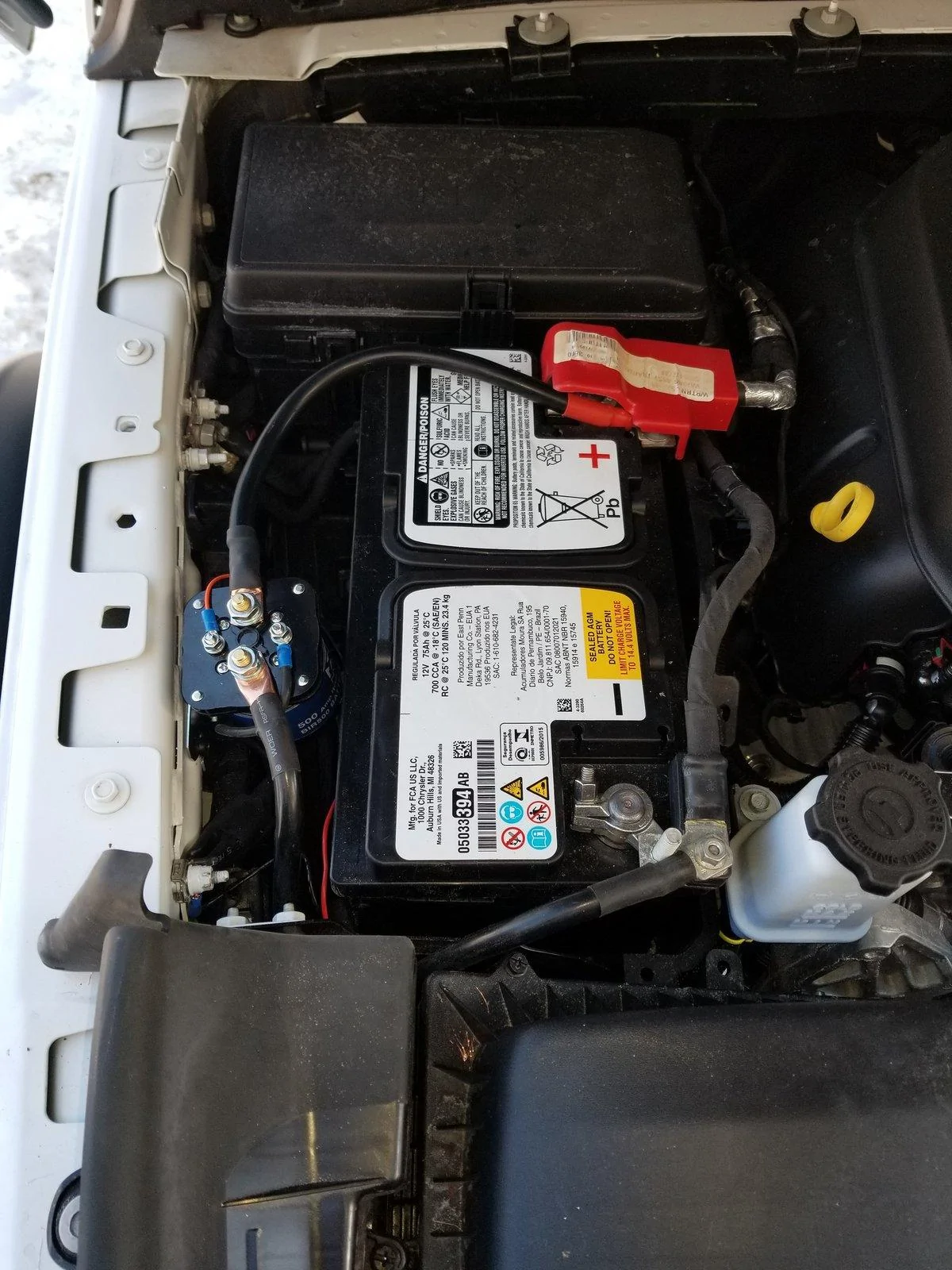

Just wanted to share my battery isolator for anyone else who might want to be able to turn on & off the power to the Winch. NVX BIR500 is a 500 amp solenoid. I have mine wired onto the AUX 4 switch. On current is supposed to be <1amp, Well with in the 15amp limit of the AUX switch. Allows me to have some peace of mind that I didnt accidentally leave the winch powered on or that random passerbys or my children werent monkeying around with the switch leaving me with a dead battery the next day...
Install is pretty basic... Positive In from battery, Positive Out to winch, Ground and positive trigger(aux switch). Space is at a premium under the hood, but there is just enough room on the passenger side of battery(in my 2.0t). I removed the battery to give room for drilling holes for the mounting screws. There is a plastic conduit full of vehicle wires directly below the NVX, leaving just enough room for everything to fit. The AUX wires are also right here. Use the shortest possible screws you can find. A right angle drill will help immensely.

I just received my NVX 500 in the mail. Just to be sure, which aux switch wire is that in the photo? It looks like it's solid red?
Nice, but I would add a fuse before the solenoid. I've had a winch melt down and you do not want direct battery power in such a situation.
Something like the below which is available up to 400A as close to the battery as possible. If you are under 300A you can go with a terminal mounted fuse which is even better (shorter unfused run).
