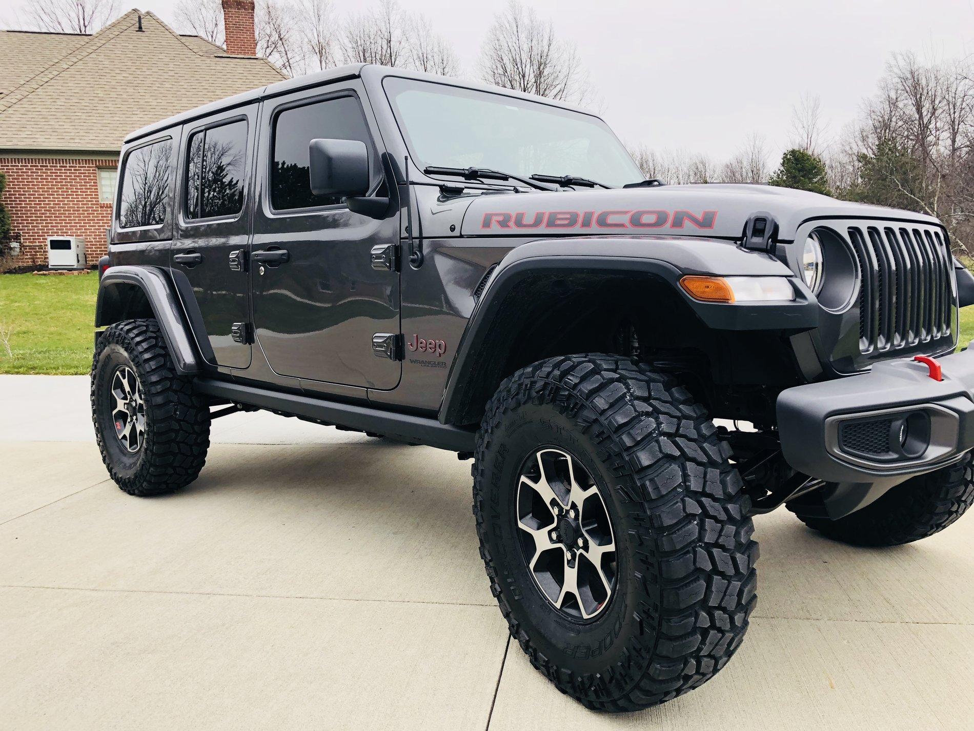

started on 35s then 2.5” lift with 35s and now 37s. Stock wheels and 1.5” wheel spacers. Haven’t had a chance to flex it but I’m going to bet it rubs just a little but may not be too bad.

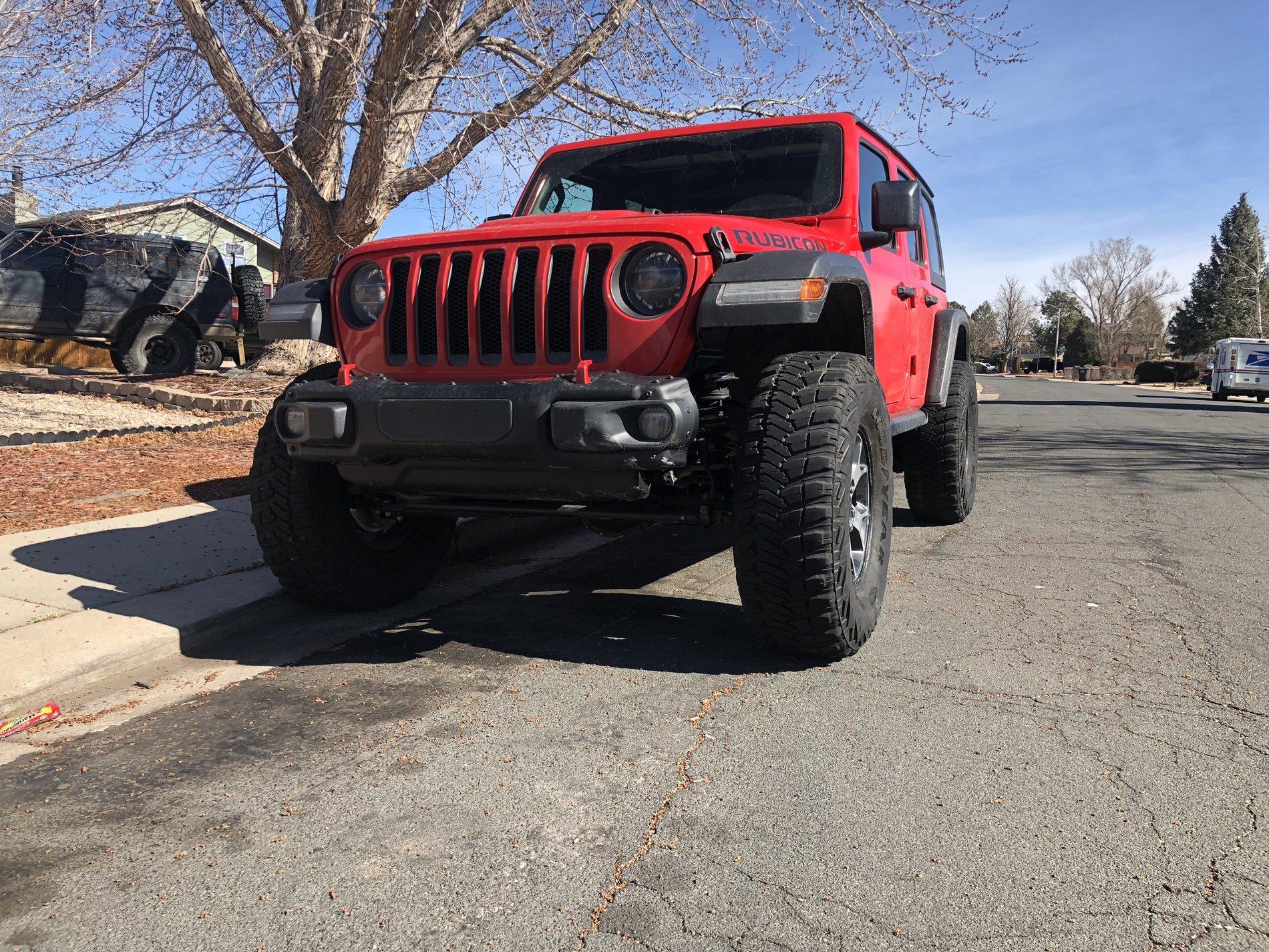

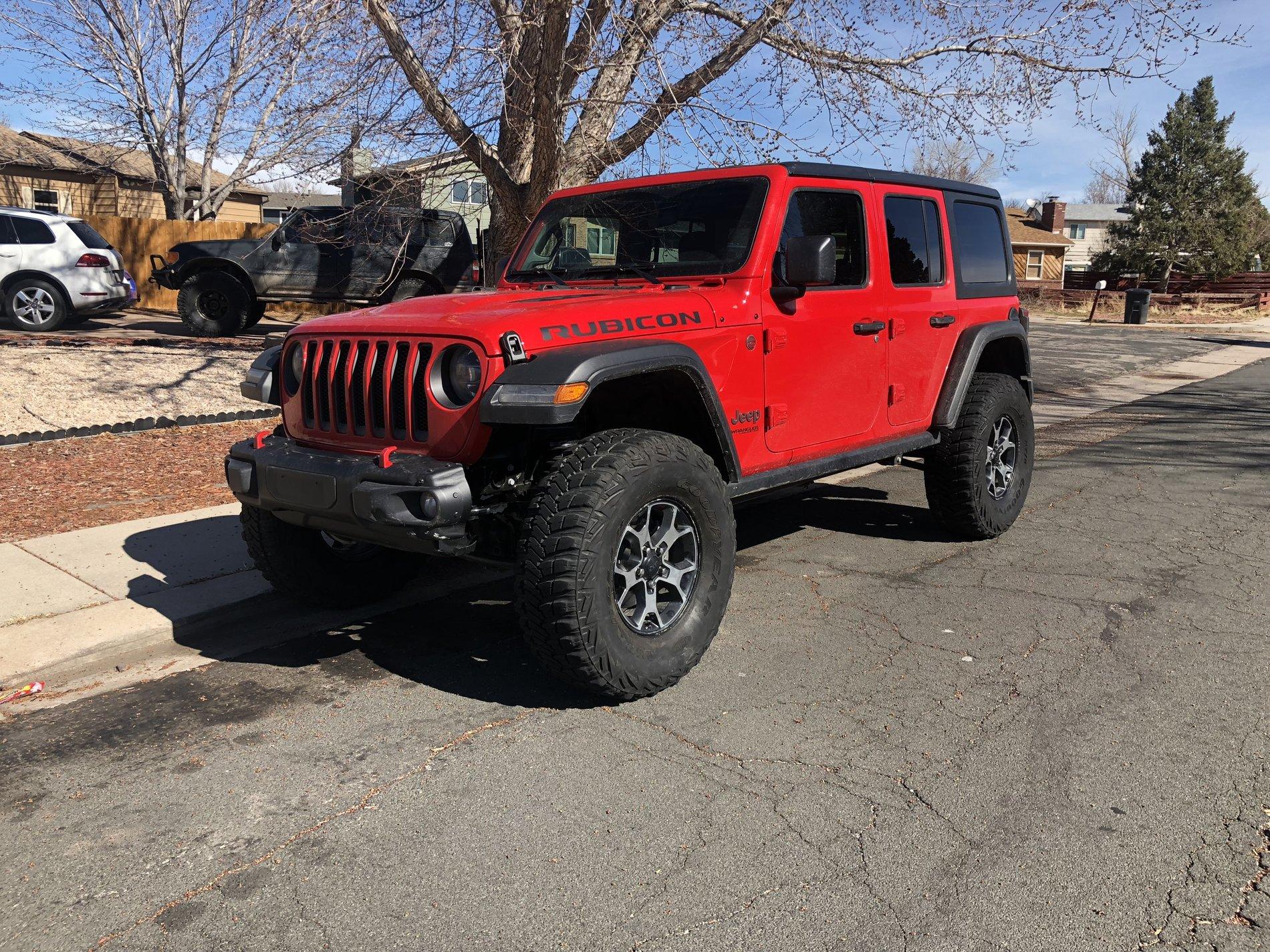

Took the other beast out

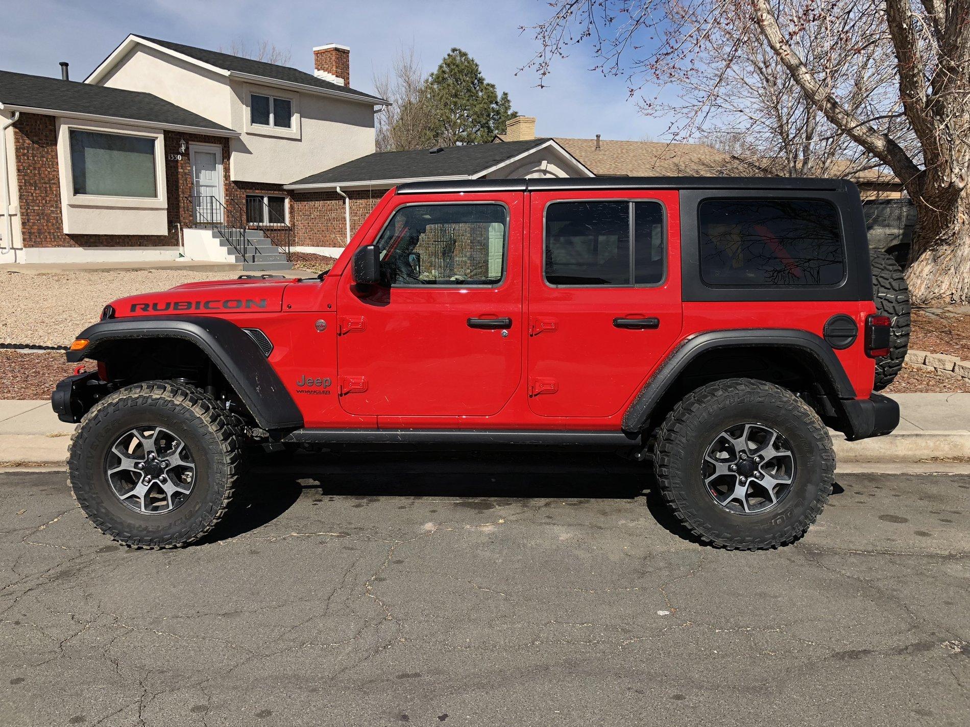

I ended up going with the spidertrax 1 3/4 spacers since I could have them overnighted since Extreme Terrain listed some that would work but didn’t. Went with the mopar 2 inch lift. These spacers gives it a nice stance and very happy with them. No need for after market rims. Here she is with 37s STT Pros.
Thanks! Your rig looks great!!

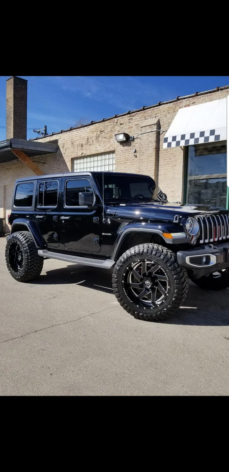

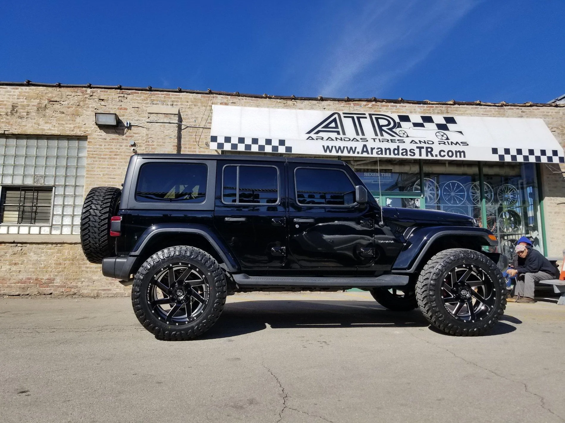

Here's the Sahara with 22x12 and 37's. It has the 2.5 Rough Country lift.
