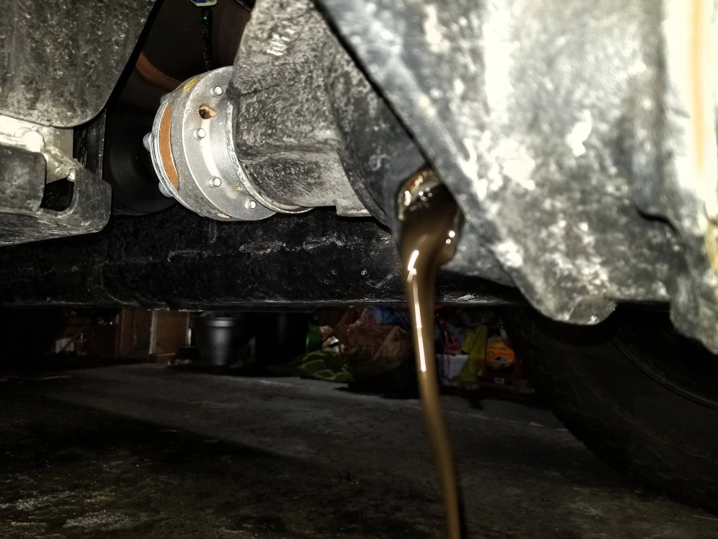

Have at it
I’ve done it before, drilled and used a tapered tap then plumbing plug. Turned out exactly like the way it’s done at the factory.

I was about to change the diff fluids today, only found out there's no drain plug on both the front M210 and rear M220 ... I was very surprised.
Can you share the specs?
