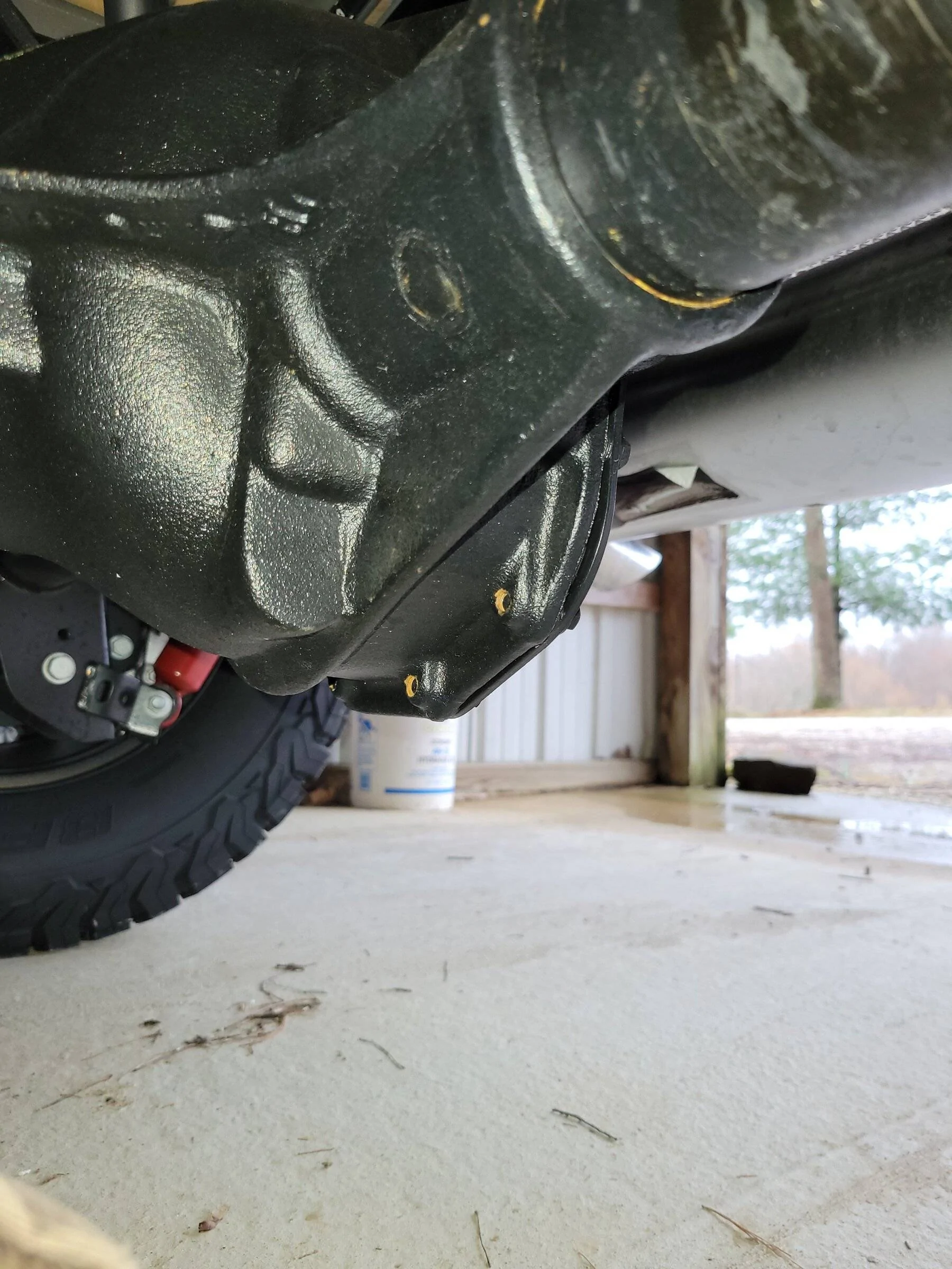

Yeah so that way if you damage it you have to do serious repair/replacement of the whole axle. Brilliant.
How do you damage the side of the axle?? That takes some real asshatery. If you've ruined this location, a plug is the least of your worries. Jeep could add a spot on the cover too, instead of making everyone go aftermarket.
Never cross-threaded a plug huh? It's also not that hard to damage that area in the rocks.

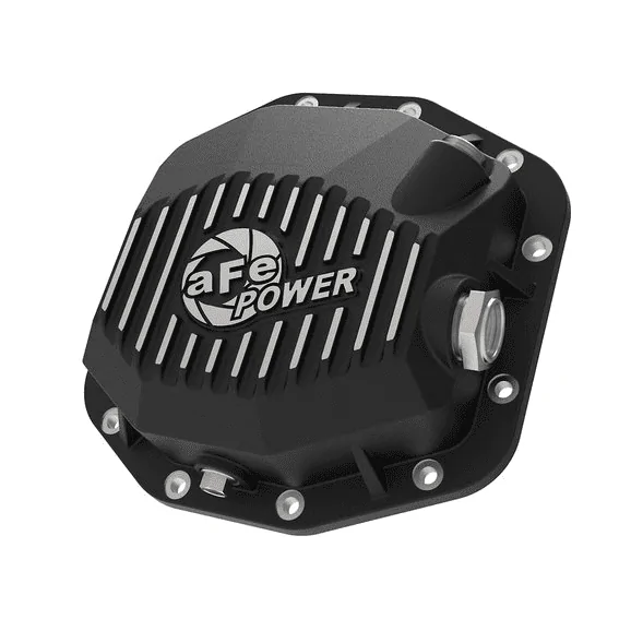

No, never have. I have come across a few that others have cross threaded though.
What about the 12 other chances to cross thread the cover bolts? Sure, any monkey can pull the cover and put it back on. But it seems pretty stupid when everyone and their brother makes a cover with drain plugs.
So get one of those and be happy. All I’m saying is it’s no big deal (any monkey can do it) to pull the cover to drain the fluid. Gives you a chance do do a thorough inspection as well.

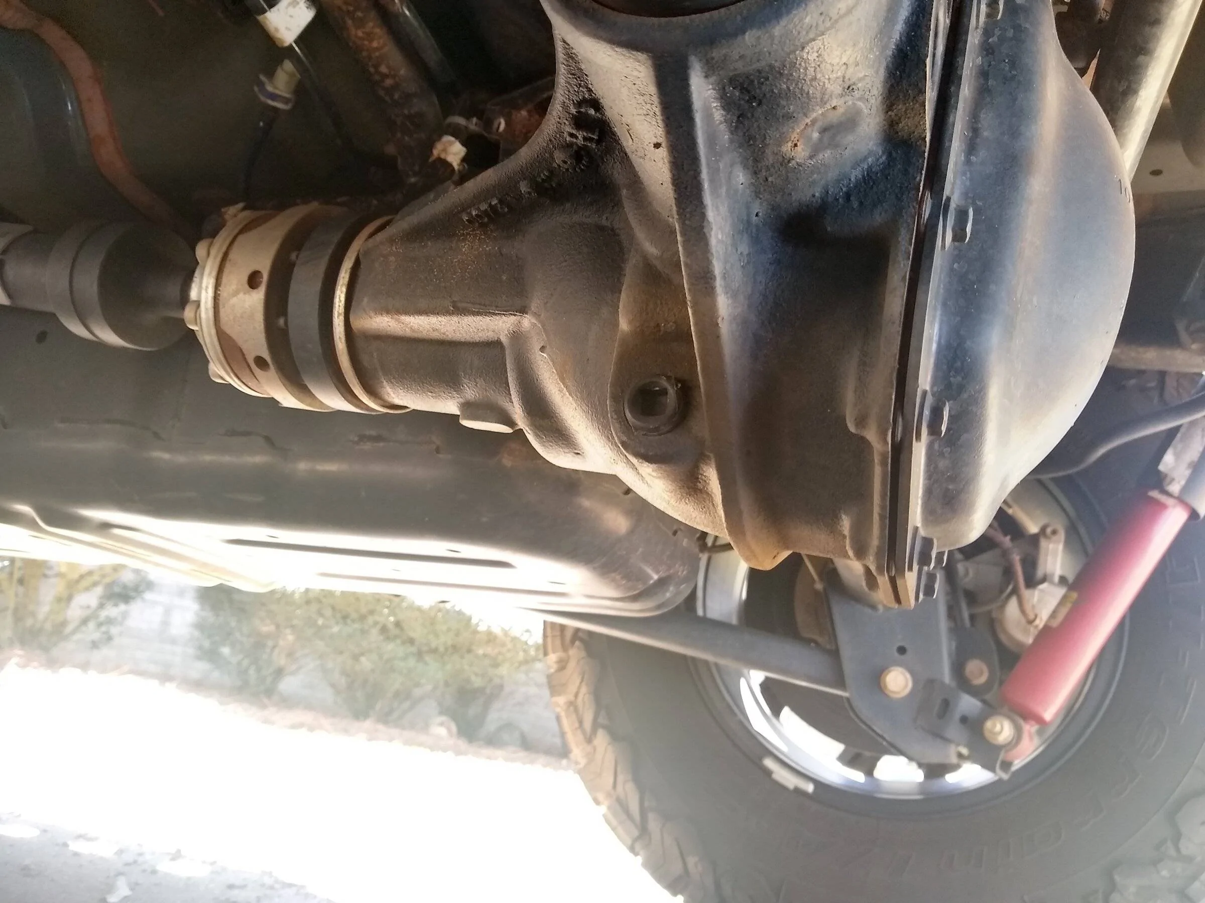

So the "boss" for drilling/tapping is there, they have just elected to save a few dollars and not do it from the factory. I sample or change my axle oil far too much to not have one.
You could drill and tap it or if not set up to do that, there are covers with drains at the bottom of the cover, though they are not at the lowest point and some oil + crud will remain. Pulling the cover is not that hard (not excusing FCA's choices), but at least you could clean the interior at the same time and the gasket is re-usable.

You’re going to tap a diff cover? Good luck with that.
No, drill and tap the housing right where the diff drain plug was on previous years.
