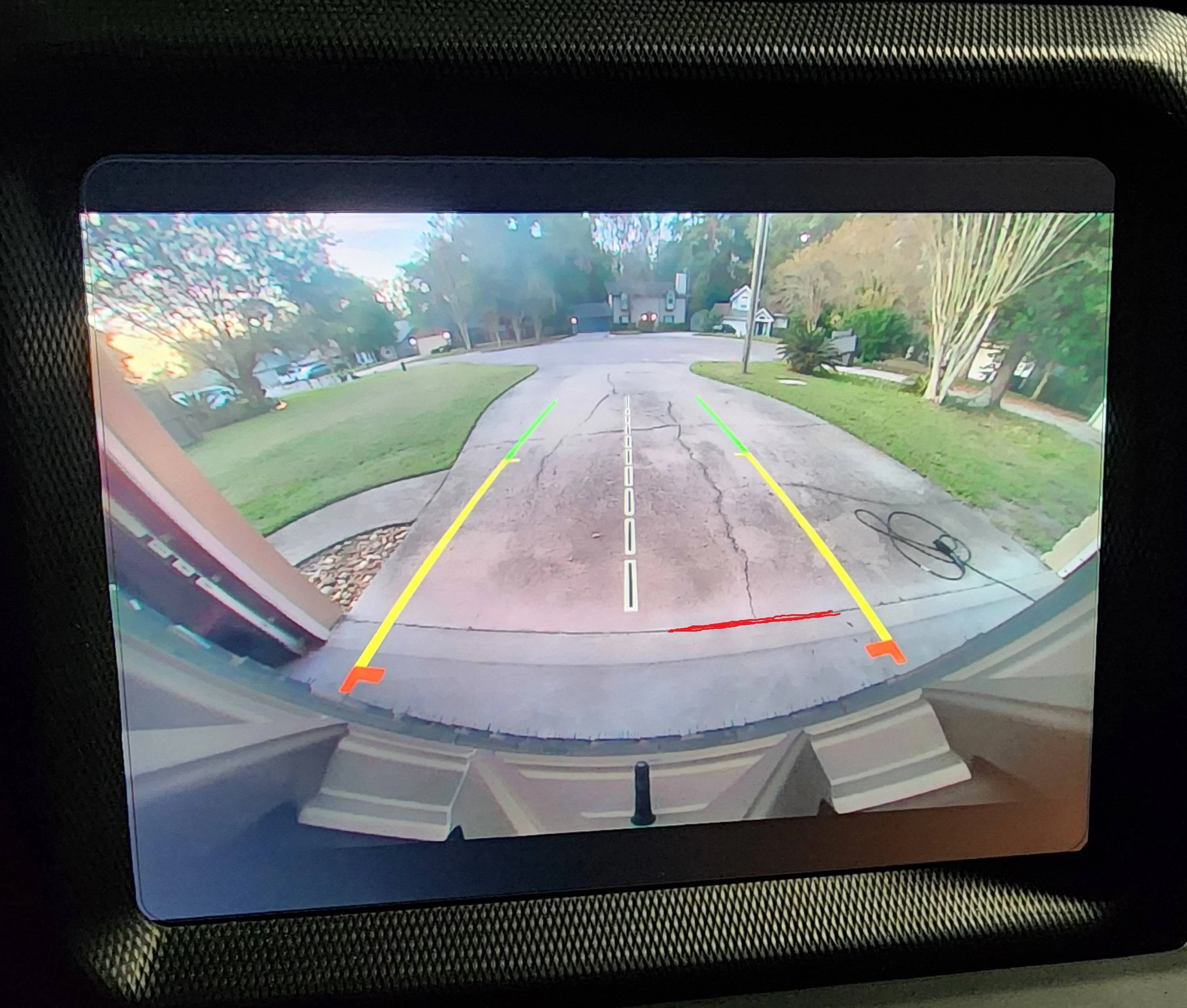

Your best best will probably be to swap out the tire carrier for the adjustable Teraflex one. With my 20x9 (-12) wheel and 35.1" tire, I was able to fit it nice and snug against the original rubber bumpers without any modifications. I originally had the tire in the middle mounting position, which tucked it nicely into the bumper cutout and gave great visibility out of the back window, but it was setting off my backup sensors. I moved it up to the higher position (each moves ~1.5") and that fixed it. I'm hoping that when I change out from the plastic bumper that I'll be able to reorient the sensors a bit so that I can move it back down to the middle.
The Teraflex carrier also has a slightly longer camera mount and gives a great view. I've attached a pic showing what I see. The red line that I drew along the concrete seam is 20" away, having put a level against the outermost point of my tire and dropping straight down.

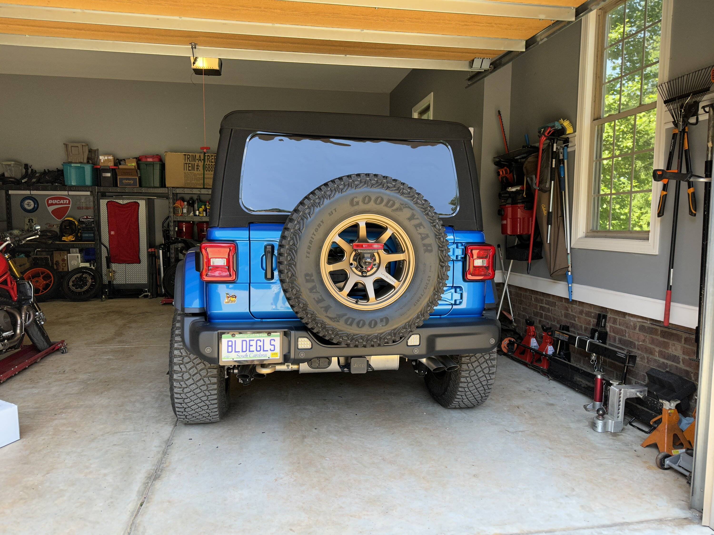

I'm assuming this will pull the spare in towards the body? I added the Teraflex carrier here... stopped the false positives. I have 9" wheels as well... filled out the fenders. No issues with the side mounts. I'm considering 37"s next but ... this combo weighs less than my 33" stockers. Think I'd rather be quick than meaty here.

Yes I did the Teraflex adjustable carrier without the upgraded hinge since I'm not exceeding the stock hinge 100# limit here. Camera works fine as do the backup sensors since you can pull the spare back up to the tailgate irregardless of wheel offset. I better not respond to anything else until tomorrow lol.
