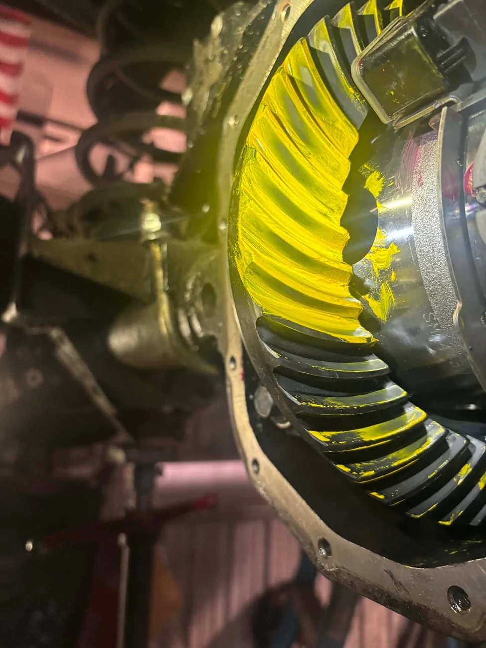

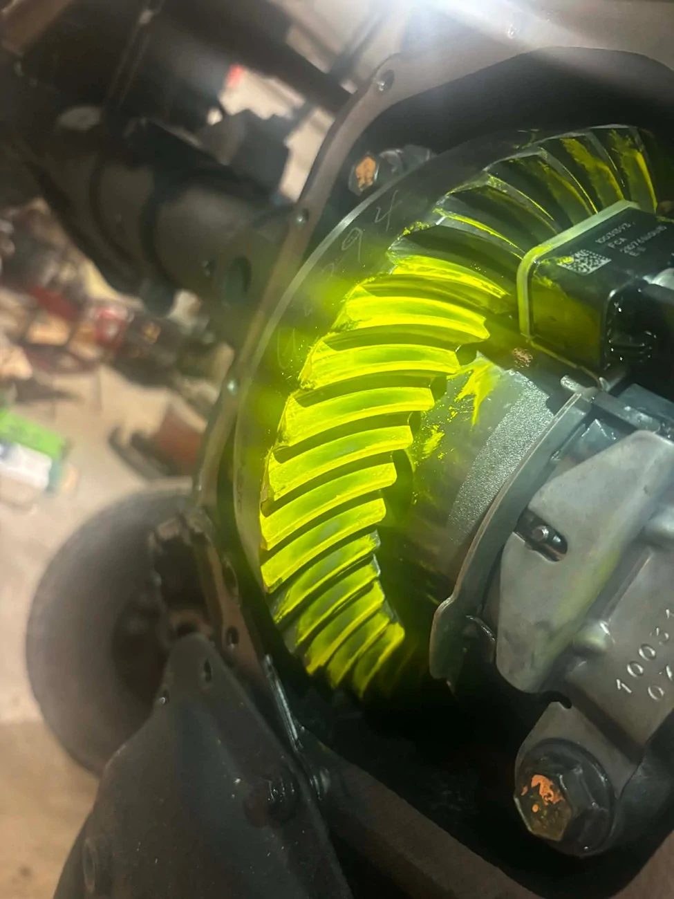

Full disclosure this is on a gladiator. I just had a set of 5.13 gears installed by a local one man shop (who has done many gear sets). Upon first drive I’m noticing some noise around 55 mph. The jeep was silent before and isn’t now. You can hear some whine that clears up once you get to 60. If you let off the throttle there’s a louder whine as it transitions to coasting. I have to assume this isn’t normal. I called the installer and he said he heard some slight noise but that it shouldn’t cause any issues. Idk I’m not sold and idk what to do.
Here’s the pattern photos. I do not know the details of how it was setup. EDIT: installer claims backlash was set at .006, revolution 2 cut spec is .004-.007
What do you think? First photo is front second is rear. Obviously the front won’t matter much at this point.

That noise should not be and IME it won't get better with time. Also would like to see gear pattern on drive and coast for both front and rear axles.

Those 2 photos were all I was given
