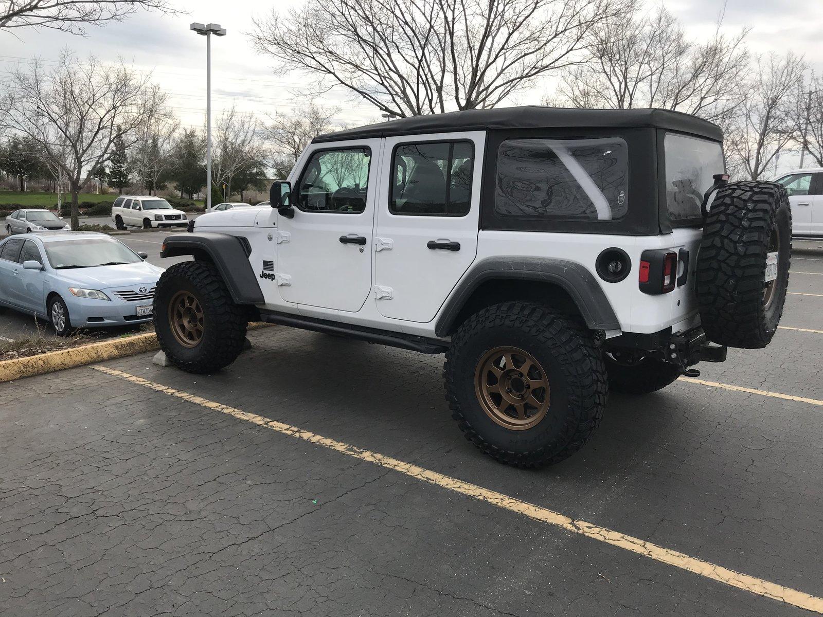

Unfortunately, only two of the five I ordered have shown up so far, but I’ll be joining the club shortly. I’m diggin the bronze.

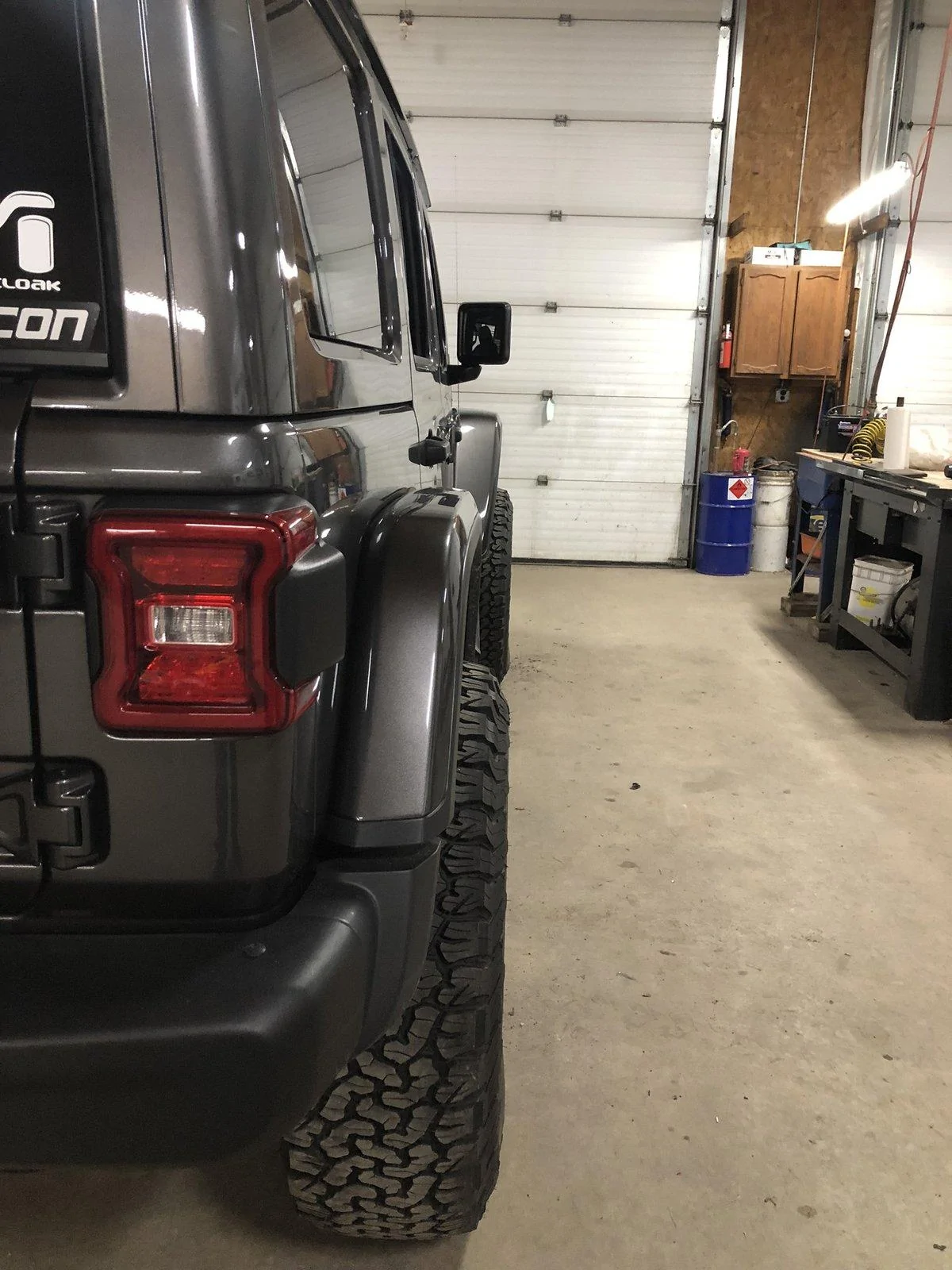

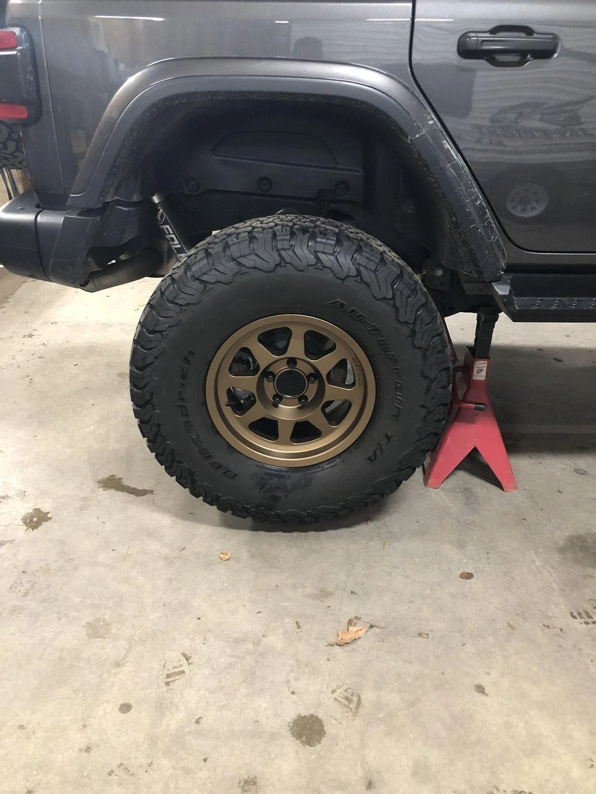

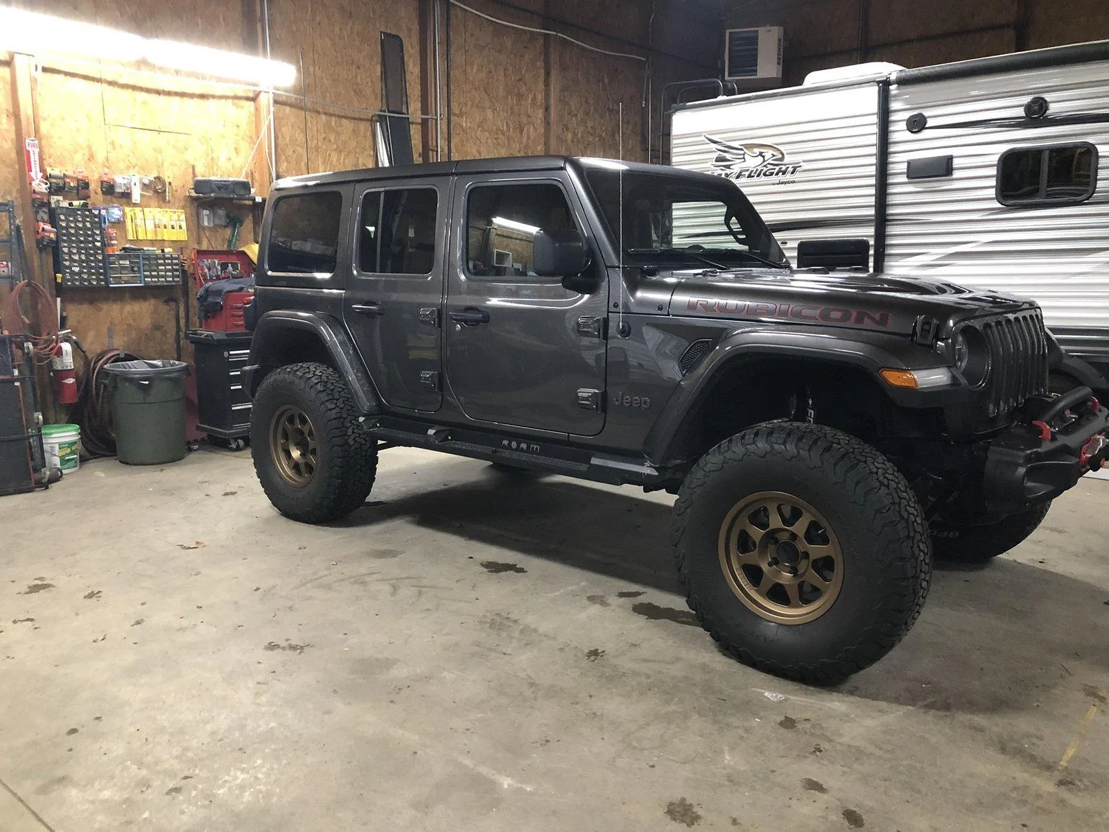

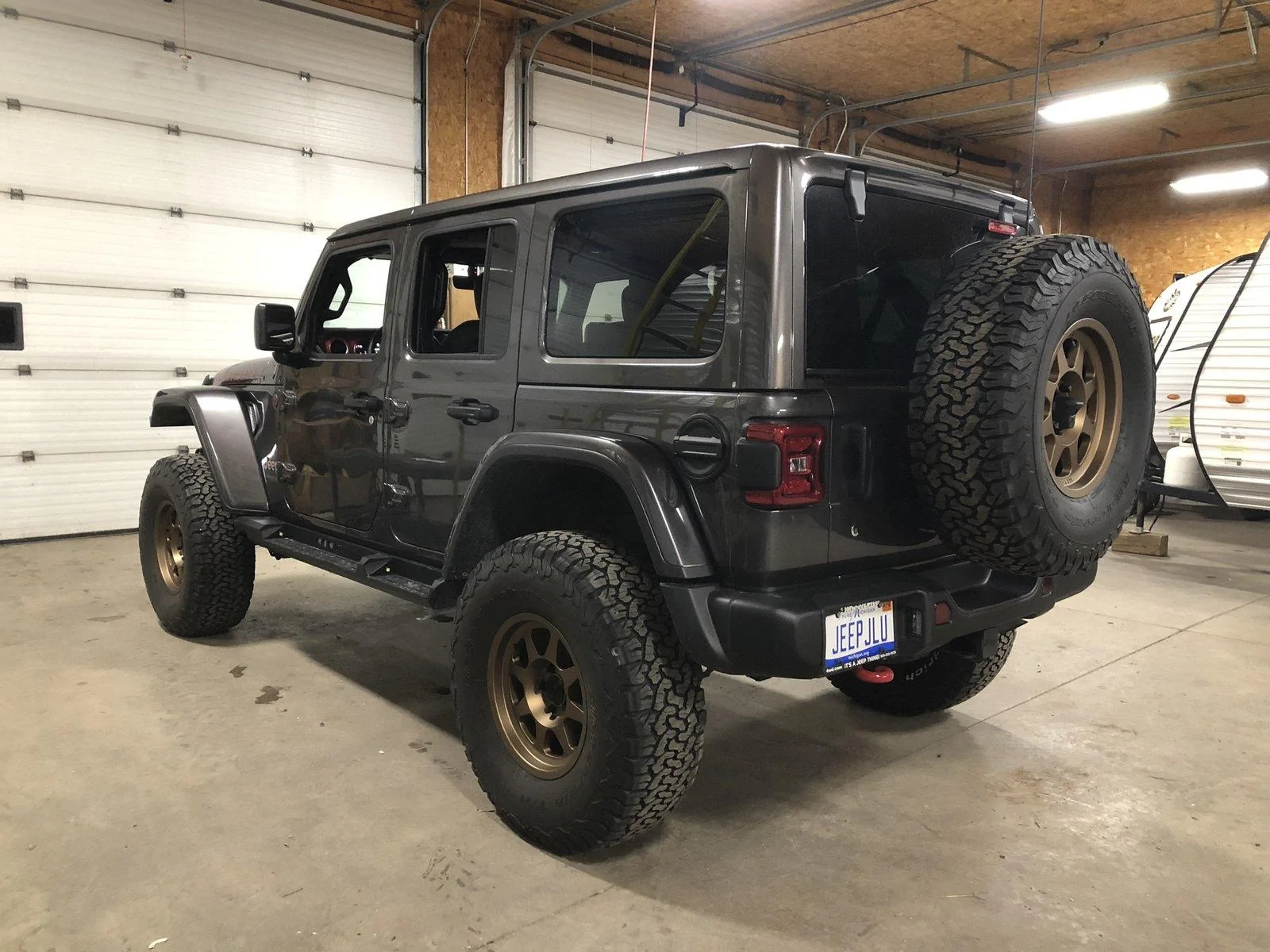

Just got mine mounted. 17x8.5 4.75BS 37X12.50 KO2s. Jeep is filthy but you get the idea.
I would like to add that these wheels require stick on weights (no lip on back) and small diameter valve stems. The "normal" stems that my shop had to connect to my sensors did not fit through the hole. I am running without TPMS until I can order some stems that fit and hook up.

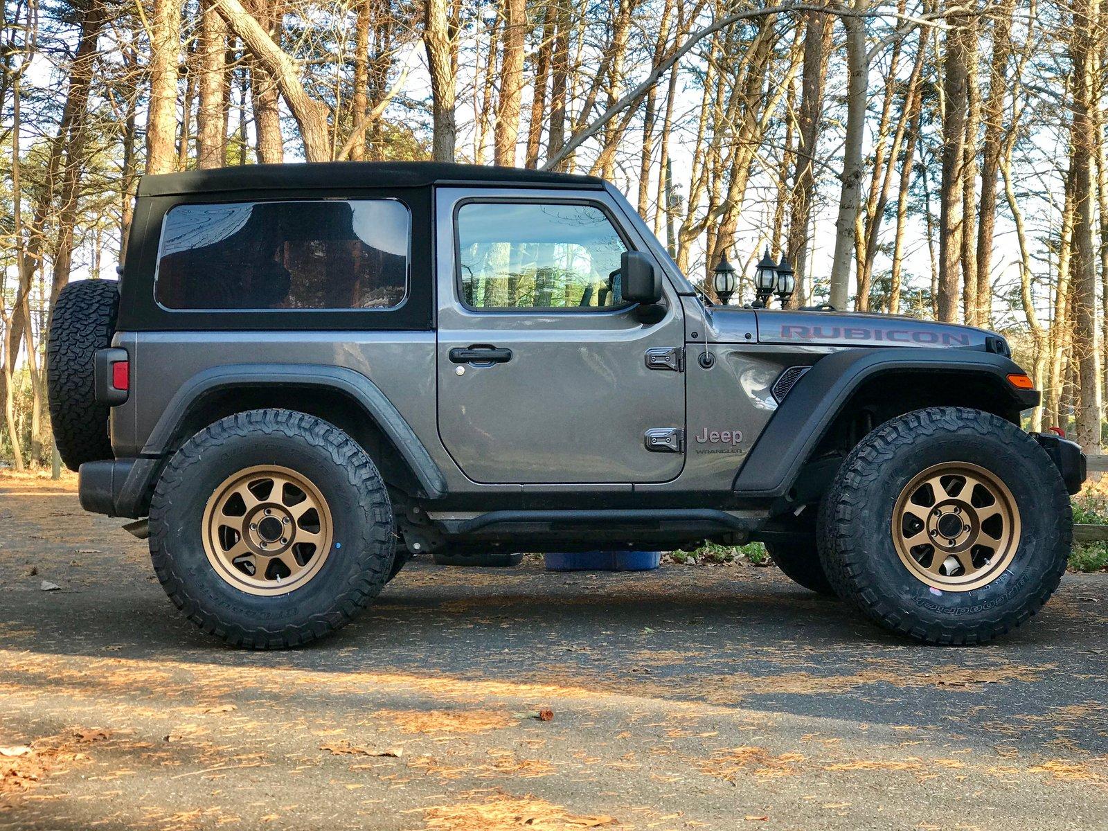

Bronze is beautiful, I’m jealous! So I’ve gone as low as 10. Anyone go lower? I’m tempted to try sub-10 at some dunes later :surprised:
My tires are E-rated and are really stiff (she said)... not sure what that means for exploring single-digit pressures yet
