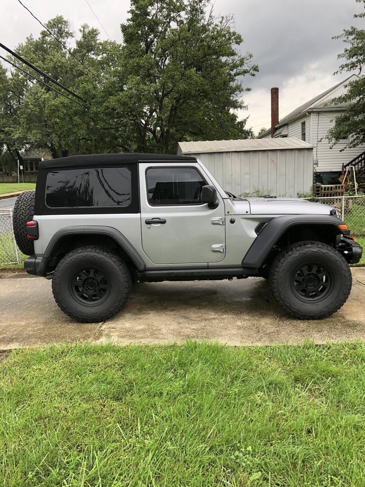

A special thanks to Marcus @River City Offroad for getting these to me quickly and at a good price.
@Kurtj29 here they are on Billet Silver!
30.7 lbs (approx)

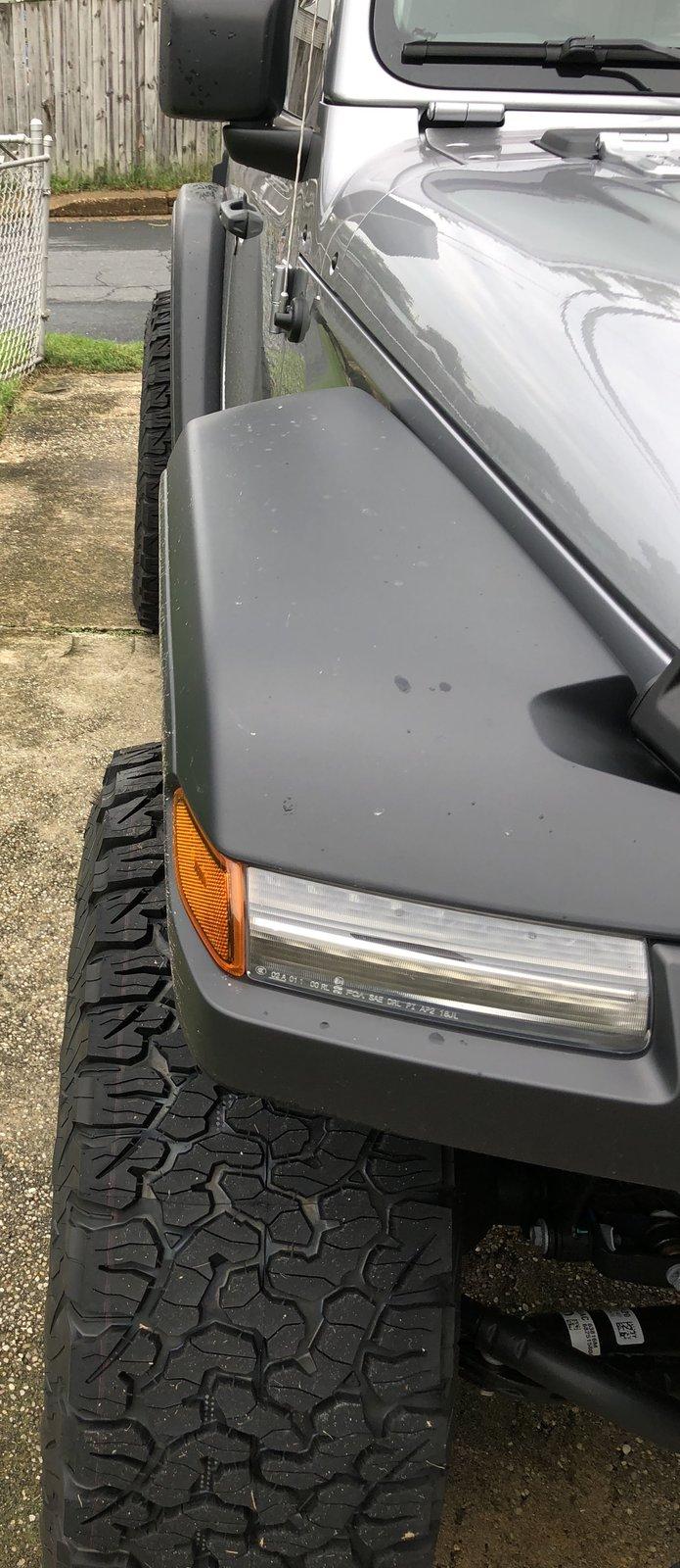

315/70R17 KO2s
No lift. Rubicon with steel bumpers.
It fits over the bumper with a slight rub. Camera works. Camera cover works. Park sense sees the tire as an obsticle and has to be turned off until my tire riser gets here.
New thin lugs needed. Hub centric.
I like the matte black very much. It is muted but not dull. I've seen other flat and matte wheels that look as if they are covered in brake dust.
The valve stems are set way back and recessed a decent amount to afford protection.
Three people at 3 different shops catering the Jeeps/4x4s said the bead grip technology really works and is not a gimmick. If I get to test this out, I'll report back
