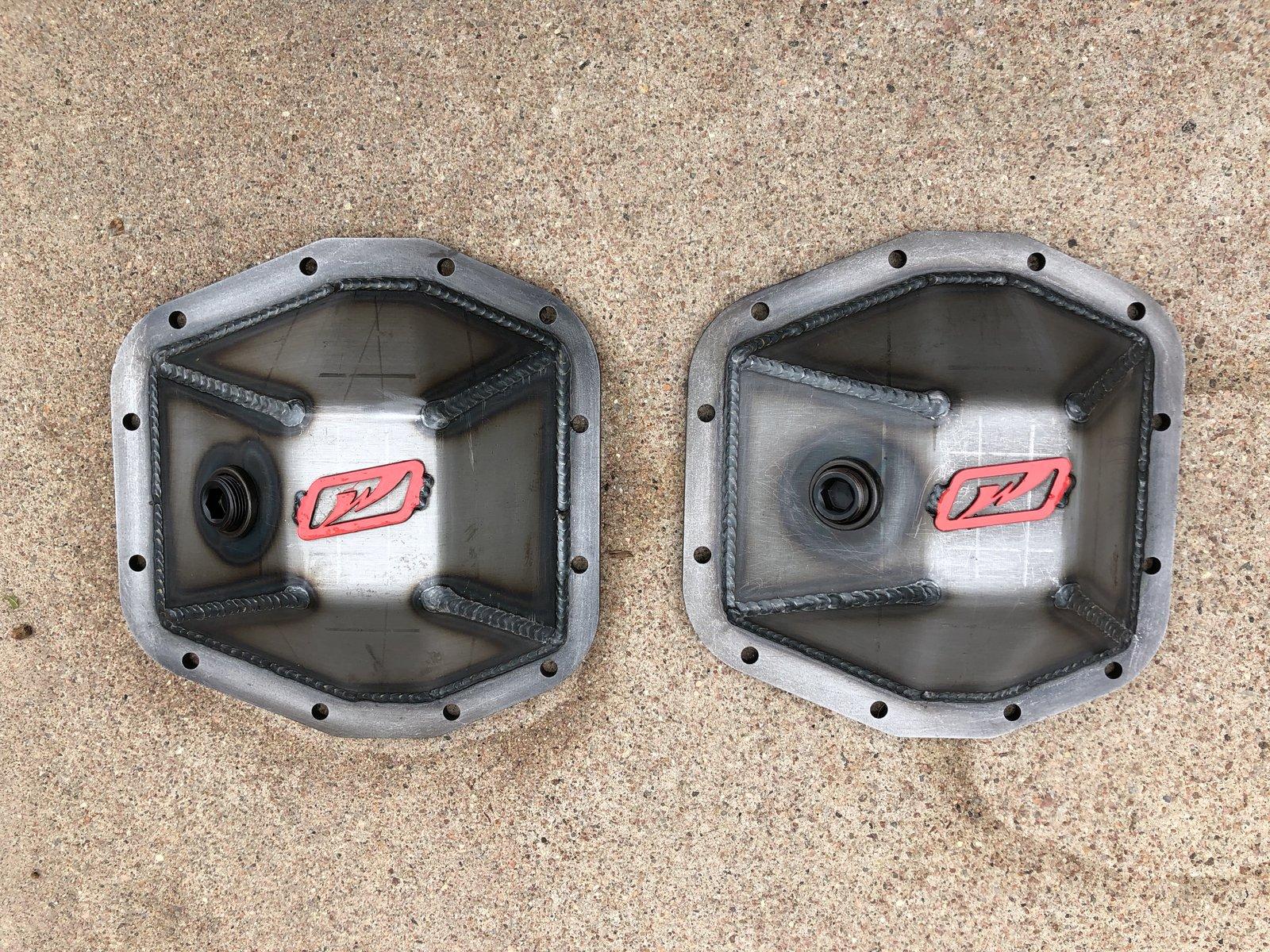

New diff covers installed. So beefy

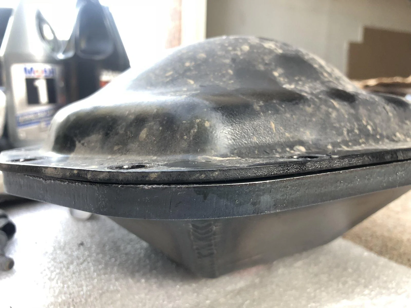

Remember that the thicker flange on the covers means you want maybe 5-10mm longer bolts.

Derp! Didn’t even think about that! Thanks!!
Measure the thickness of the OEM and your aftermarket cover and add that difference to the length of the OEM bolt.
