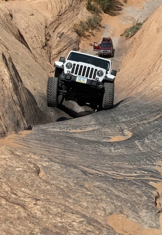

I’m old and my search function skills are not on point so here it goes. Have a 2025 JLU Willys. we traded our 2020 JT Rubicon to get it. I know I put 37’s on the JT and added a lift a couple years later when we took a trip to Moab. For daily driving the non lifted JT on 37’s did not rub. Can I do the same in the Willys? What backspacing should I be shopping for rims? we put the Mopar 2” lift on when we headed out to Moab. Can I expect the lift to perform the same on the willys as it did on the rubicon? I appreciate the knowledge, thank you in advance.
