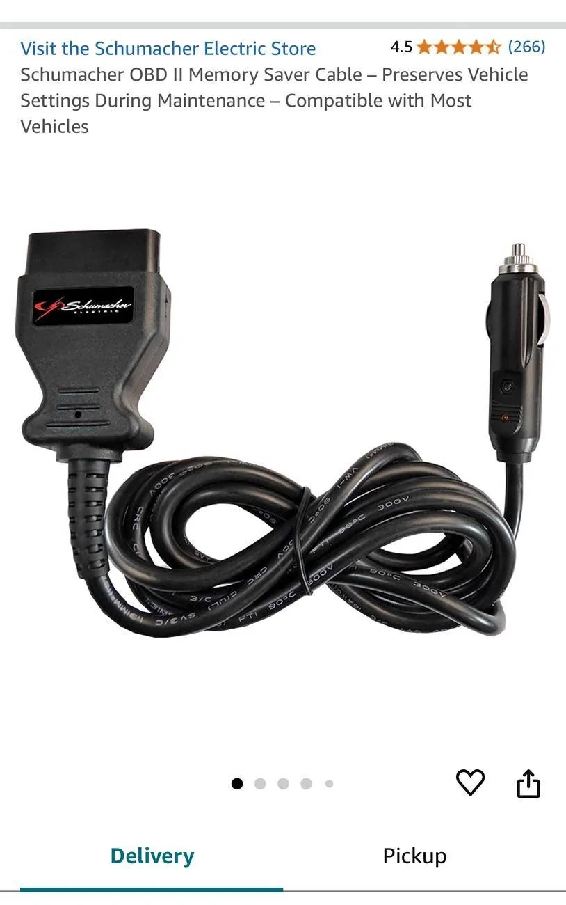

Mine was only disconnected a few minutes, I asked about it and was told to keep the system powered, suggestions were an OBD2 plug in that connects to another lighter plug, use jumpers from another battery to the cables, even a 9V battery connected to the cables was said to maintain the electronics. I won’t make the mistake again even though $110 got the security code, something else may not like it.
Before the next one I liked this idea
I have a 9V-powered memory saver for that exact purpose. I forgot to use it when changing the Jeep's battery, but didn't have any issues, thankfully.

Ignorance- change battery, security code required. I went to Jeep parts with the vin# - nope, service writer tried, called a tech out - nope. Said they had to pull it for the serial # , $110. Sure glad I saved money doing it myself 🙄 I’ll have to look into the 9V saver, OBD2 ?

Mine plugs into the cigarette lighter. Easy peasy.
Would require the ignition in “run” position for the plug to be “hot”, or is it “acc” 🙄 no issues ?
