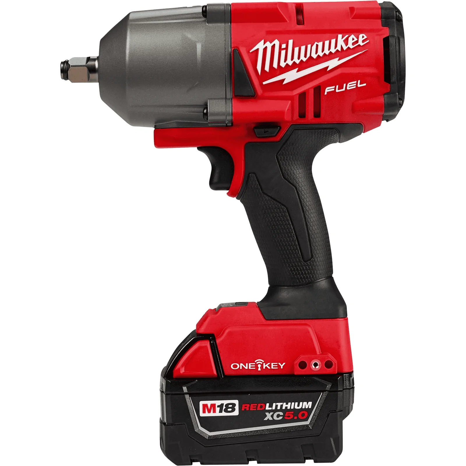

Must be the person rotating your tires used this on the highest setting.
It's not only over tightening, but far too many "techs" don't believe in starting a piece of hardware by hand. Especially lug nuts. They load the lug nut into the socket and aim the gun in the general direction of the stud. AAA did just that to my wife's Honda civic about 5 years ago. We had to eat a new hub and aluminum wheel for what that nitwit did. Tire shops are notorious for having guys that think they're too slick for hand starting lugs. When I can't take mounted and balanced wheel/tires out of a shop loose, I tell them that I'll do the final tightening and torque myself. I dislike having to do that, because after so many years in the repair industry, I'm all too familiar with having annoying pigeons around. But I also know how saturated that industry is with hacks.
