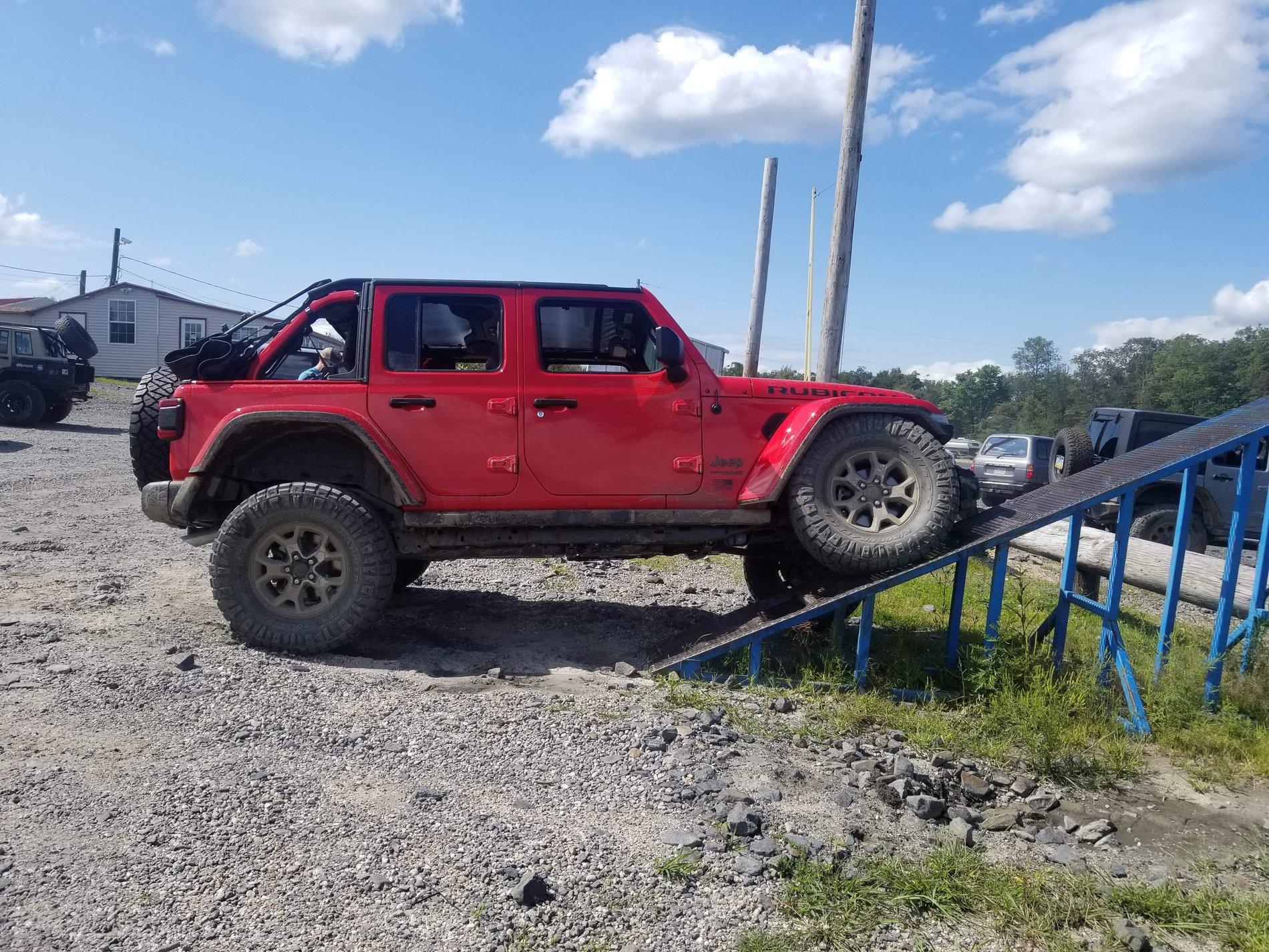

I have JLU sport with Mopar Lift and 35s. When the sway bar link is disconnected, I get a lot rubbing on the front inner fender when the wheel gets stuffed. Has anyone used longer bump stops? Any recommendations?
I am attaching pictures on a ramp to illustrate the problem Thanks

Hmmm...after looking more closely at your pic....bumps aren't going to fix that. You need more lift. You're stuffing a couple of inches up in the fender. You need to either trim the fender (which is what I'd recommend) or lift it higher. When steering, even with a pretty big bump stop, you're going to hit. You'd probably need at least a 2" to stop that while steering.

I would first check and make sure the bump stops that came with the kit were correctly installed. Second, how much is "a lot" of rubbing and if you weren't rubbing, could you have gone further up the ramp before your rear tire lifted off the ground? If you can get a picture of the suspension while on the ramp that would help. Can't tell much from the pictures included.
The bump stops look ok, I checked. The rubbing gets really loud at times when off road and therefore I stated " a lot of rubbing" Thanks
Yes it looks like I will need to do some trimming. Thanks for the suggestion

I guess another option is don't disconnect your sway bar.
Sway bar makes a huge difference off road. I am attaching a picture on the same ramp with the sway bar link connected. I was not able to get as far as with the sway bar disconnected. The rear wheel lifted as well. I do not have lockers and it makes a big difference in traction. Thanks
