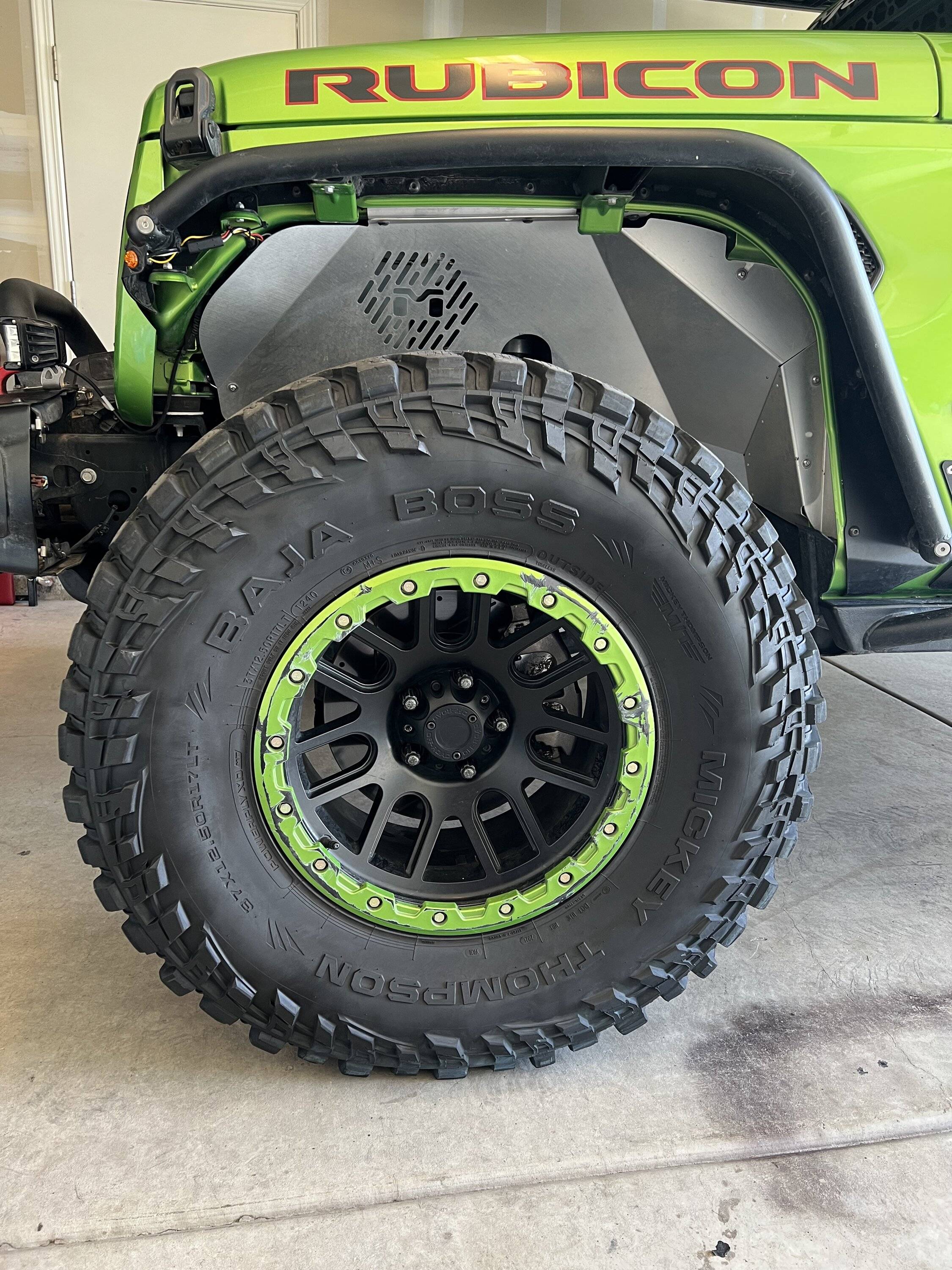

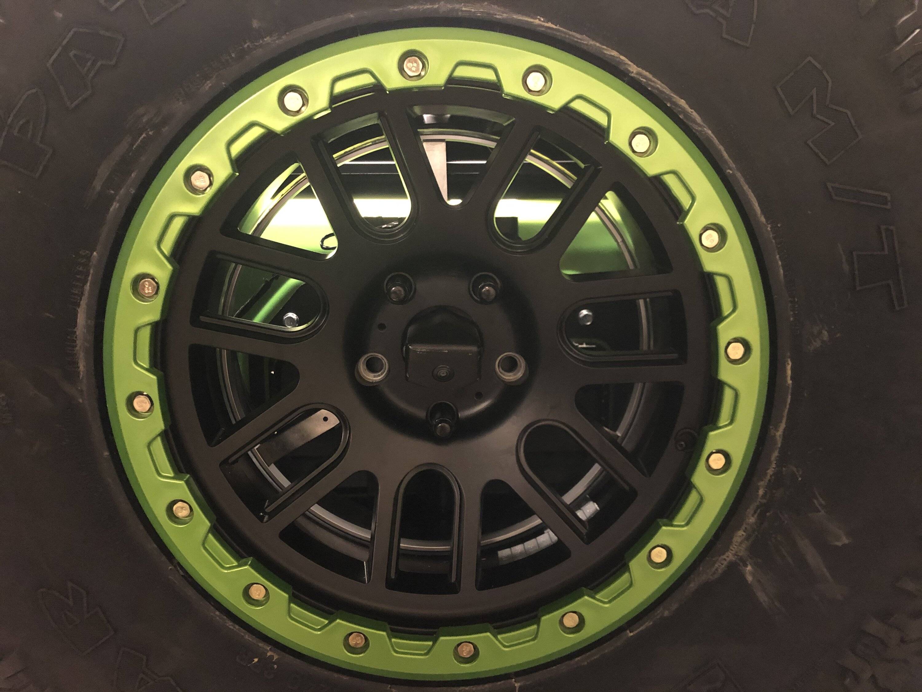

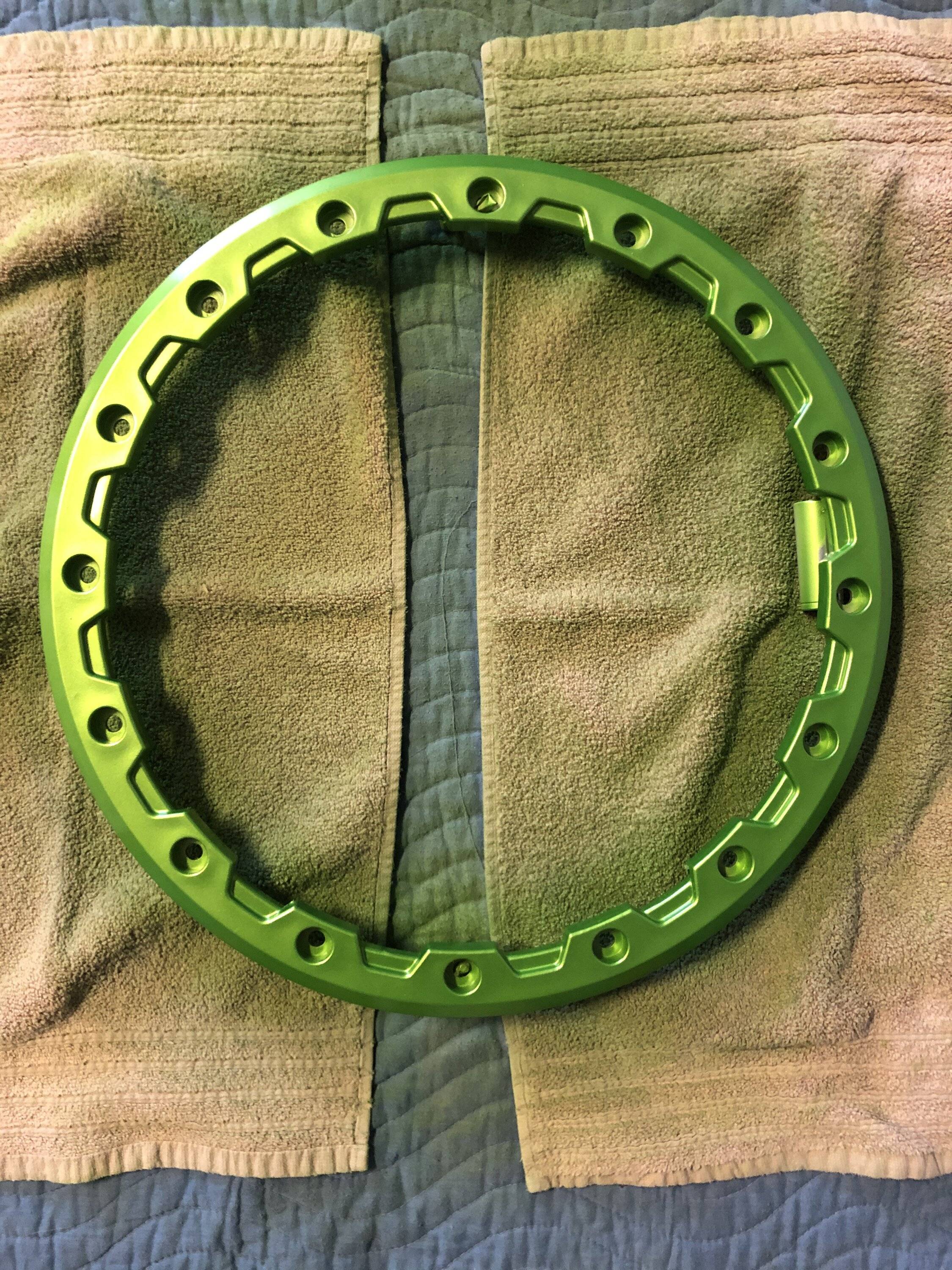

I have the Vision Nemesis wheels. They include a removable polymer ring (attach to wheel with included bolts). These give the wheels a beadlock look, without the beadlock hassle or benefits. I painted mine to match the Jeep.
To paint, scuff the rings with a scotch bright sanding pad and clean with soap and water. De-grease the rings with denatured alcohol. Apply several coats of primer and then paint. Add several layers of clear coat if desired. I posted a thread on the forum about this several years ago.
Additionally, the Nemesis wheels are lightweight (29lbs) and have held up very well to rock crawling. They balance well and I've had no issues with them.
The removable ring can get chewed up some, but you can sand them down and re-paint easily. Short of getting rubbed off by rocks or curbs, paint adheres to them very well. As you can see in my picture, there are areas where the paint has been scraped away due to rocks. The benefit with a polymer ring (versus steel) is there is no rust to worry about.
The Vision Nemesis wheels are one of the more economical options and I bought mine from Discount Tire.
