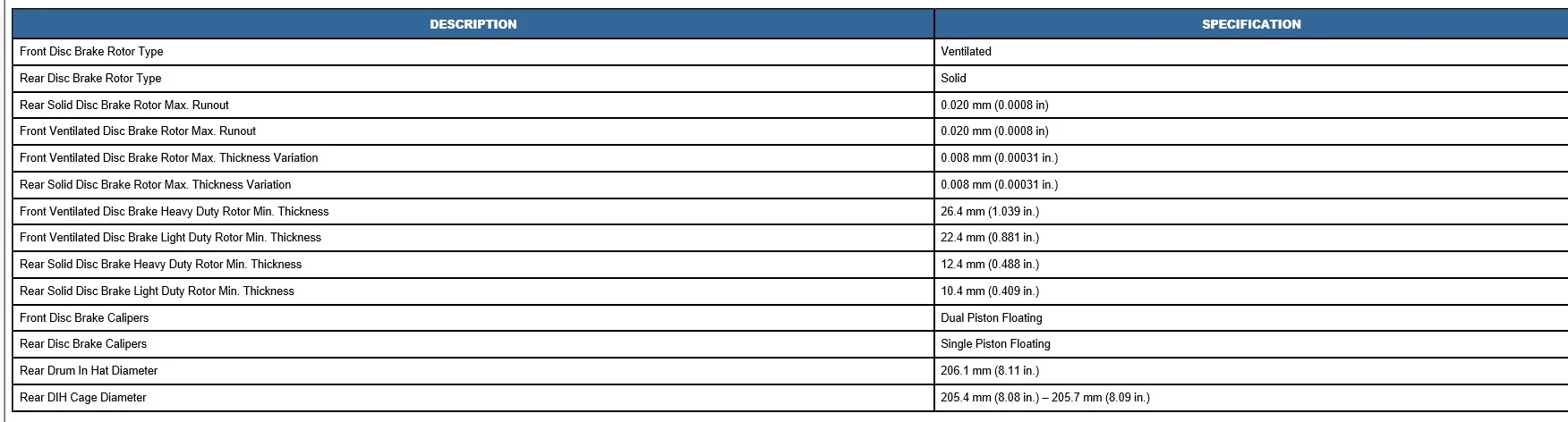

Here's the runout specs for when you put your dial indicator on the rotor with at least 3 lug nuts holding it down.
Jeep Wrangler JL NEED HELP! Rear Brake Rotors brake specs
