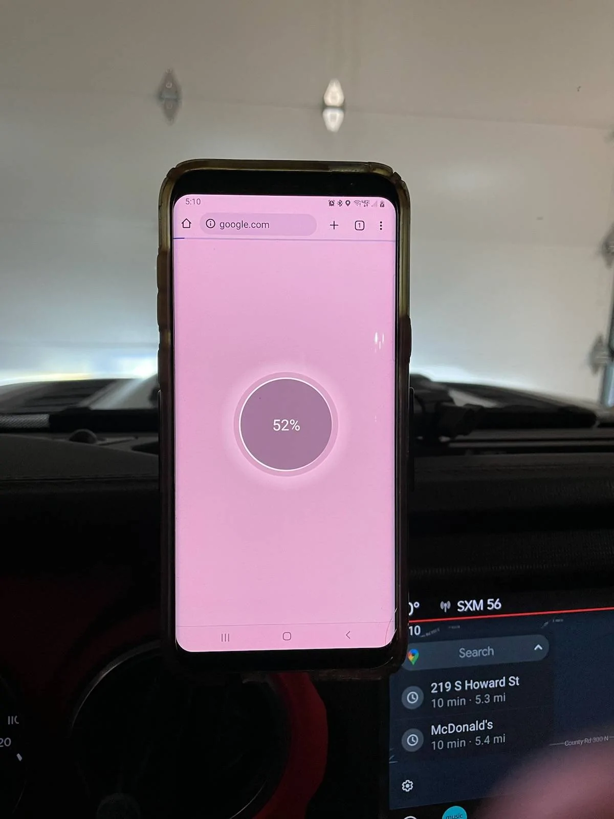

I can now jump in place my phone on wireless magnetic charger and Android Auto connects almost instantly. Happy lazy camper signing off.

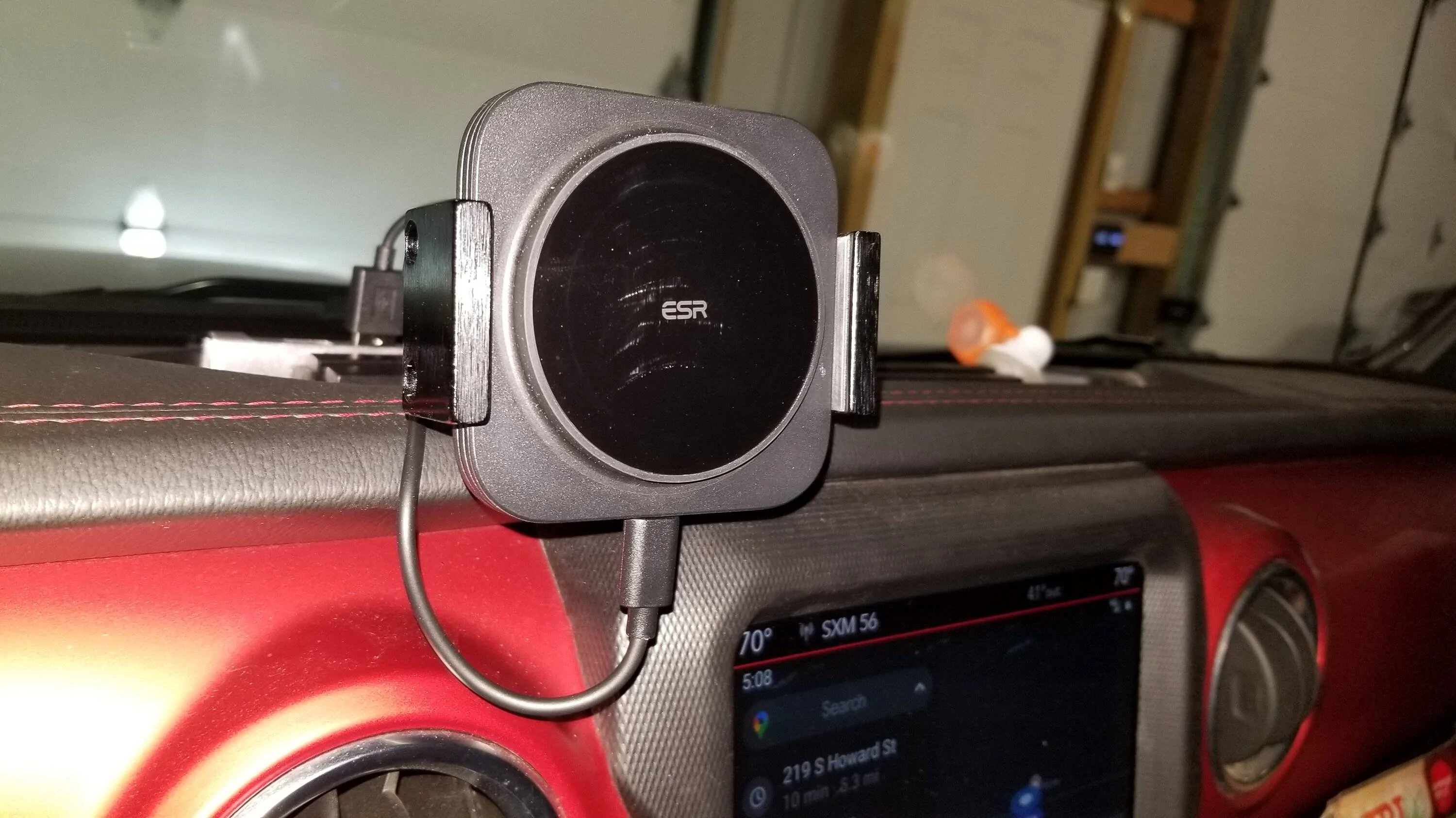

Wireless charger fits perfectly in my 67 designs holder. You can see the cable routed up and plugged into the USB hub.

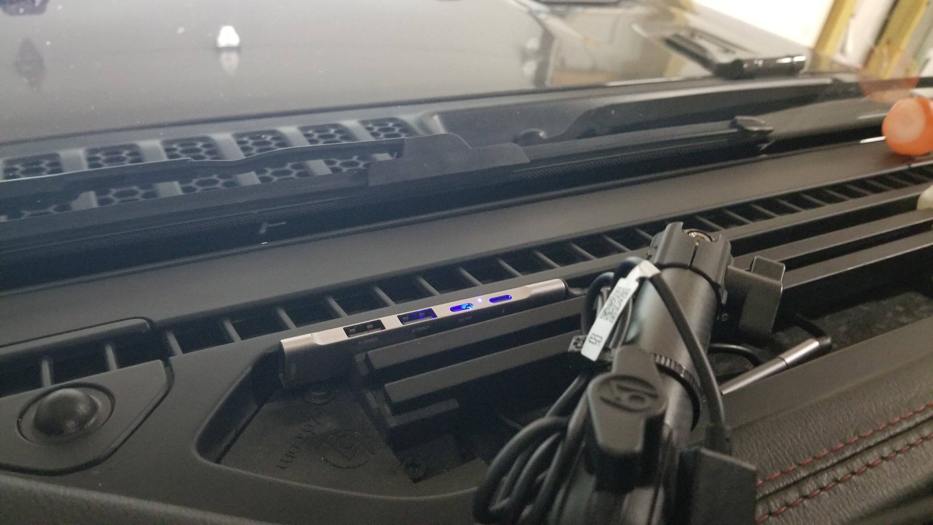

USB C hub snug fit, I might get a shorter USB cable but I don't see it from driving view.

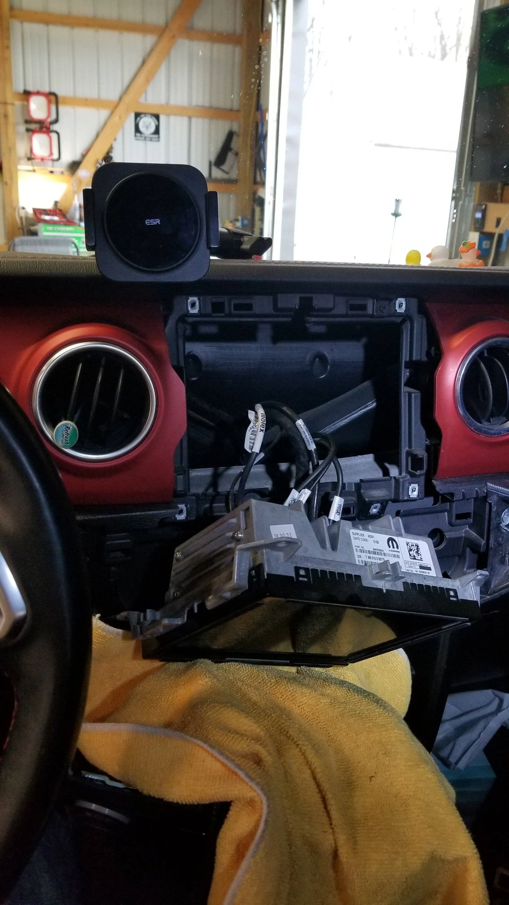

The small hole I had to drill or "poke" thru the dash. The cable is routed down behind the radio all the way to the 12V socket tap. If I was doing again I probably would have placed a USB panel type socket here instead. The shiny part is the hub commented to the cable using male to male adapter.
Proof I had the dash apart...
