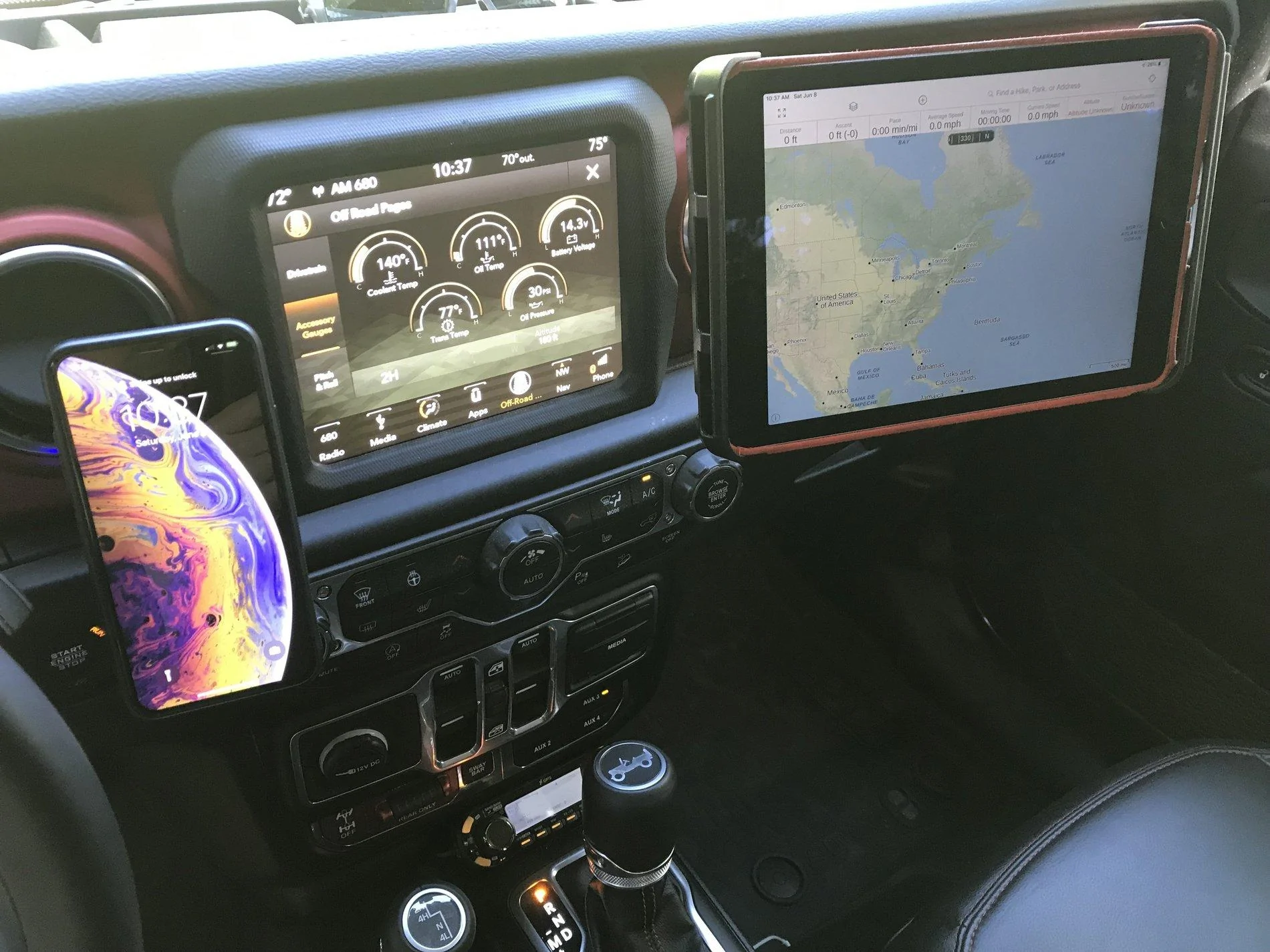

Installed a Nillkin wireless cell charger on the dash which holds my iPhone XS securely while using the recommended magnetic case.

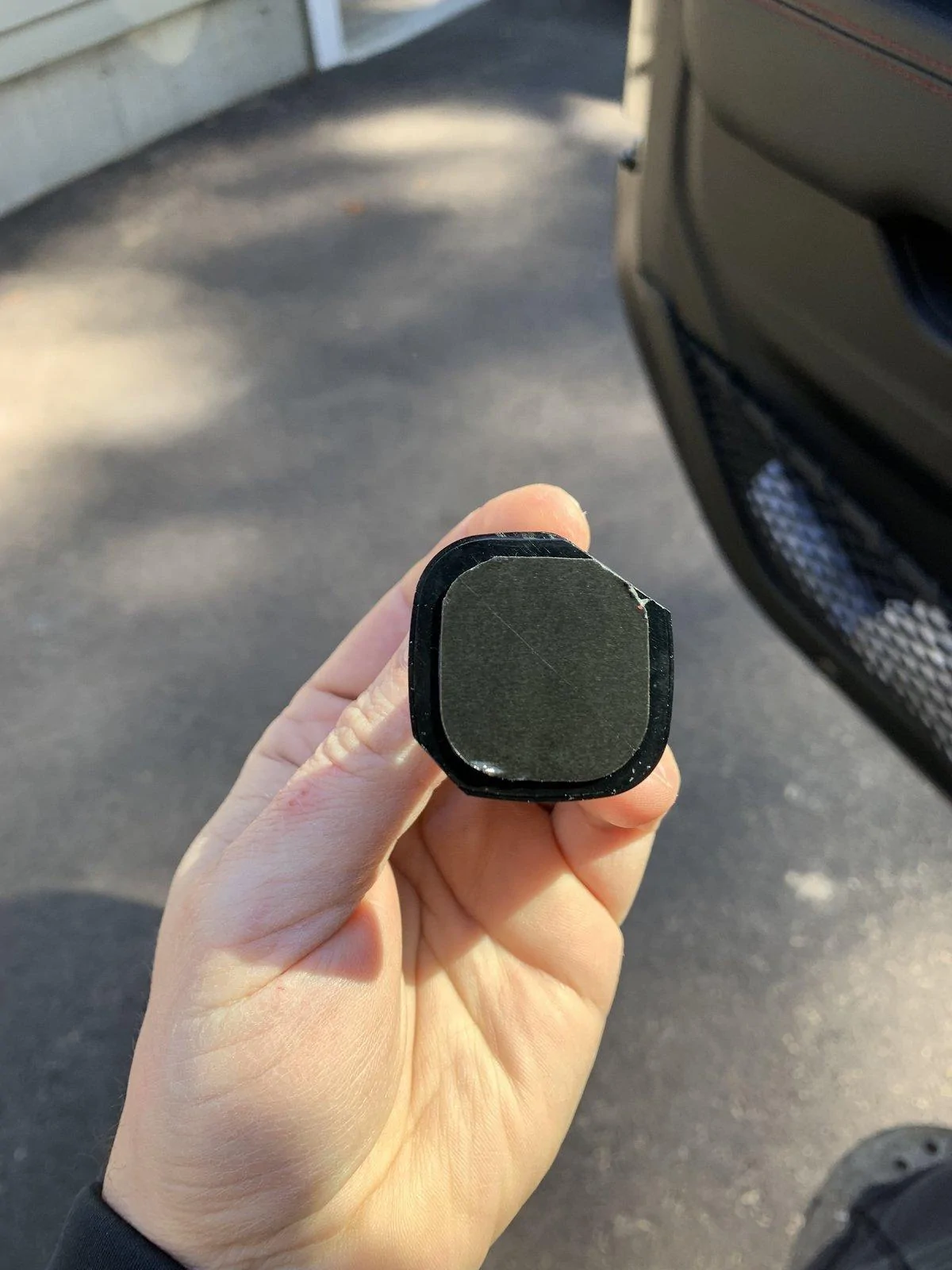

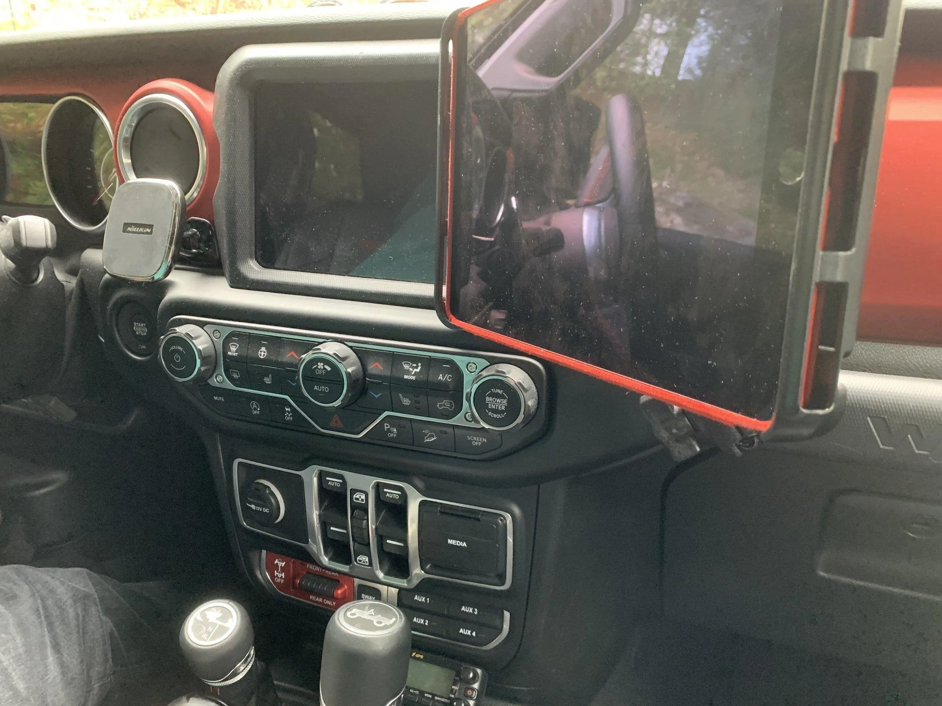

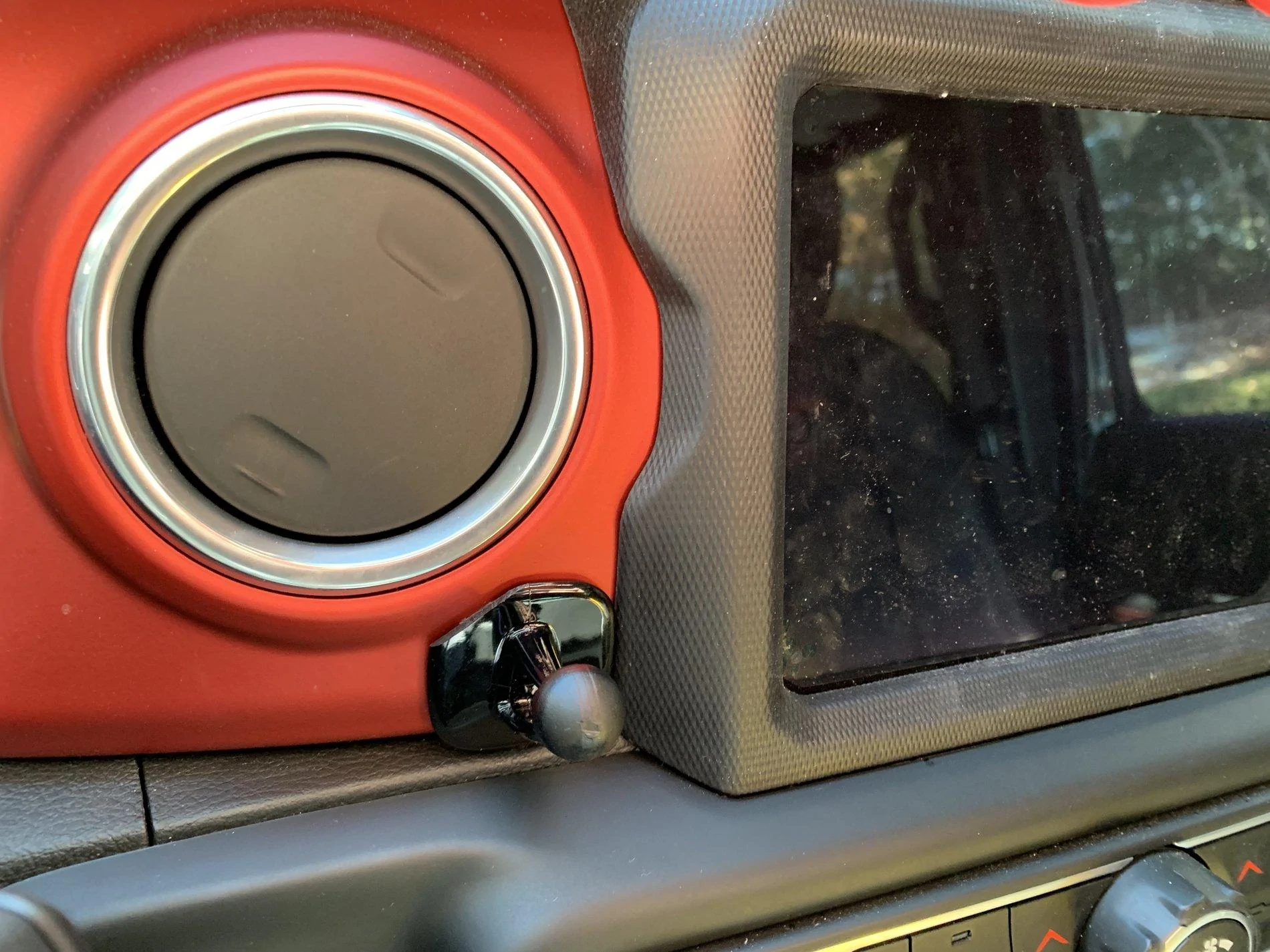

Trimmed the mount a bit so it would mount flush on the dash, and mounted it just to the left of the 8.4 display.

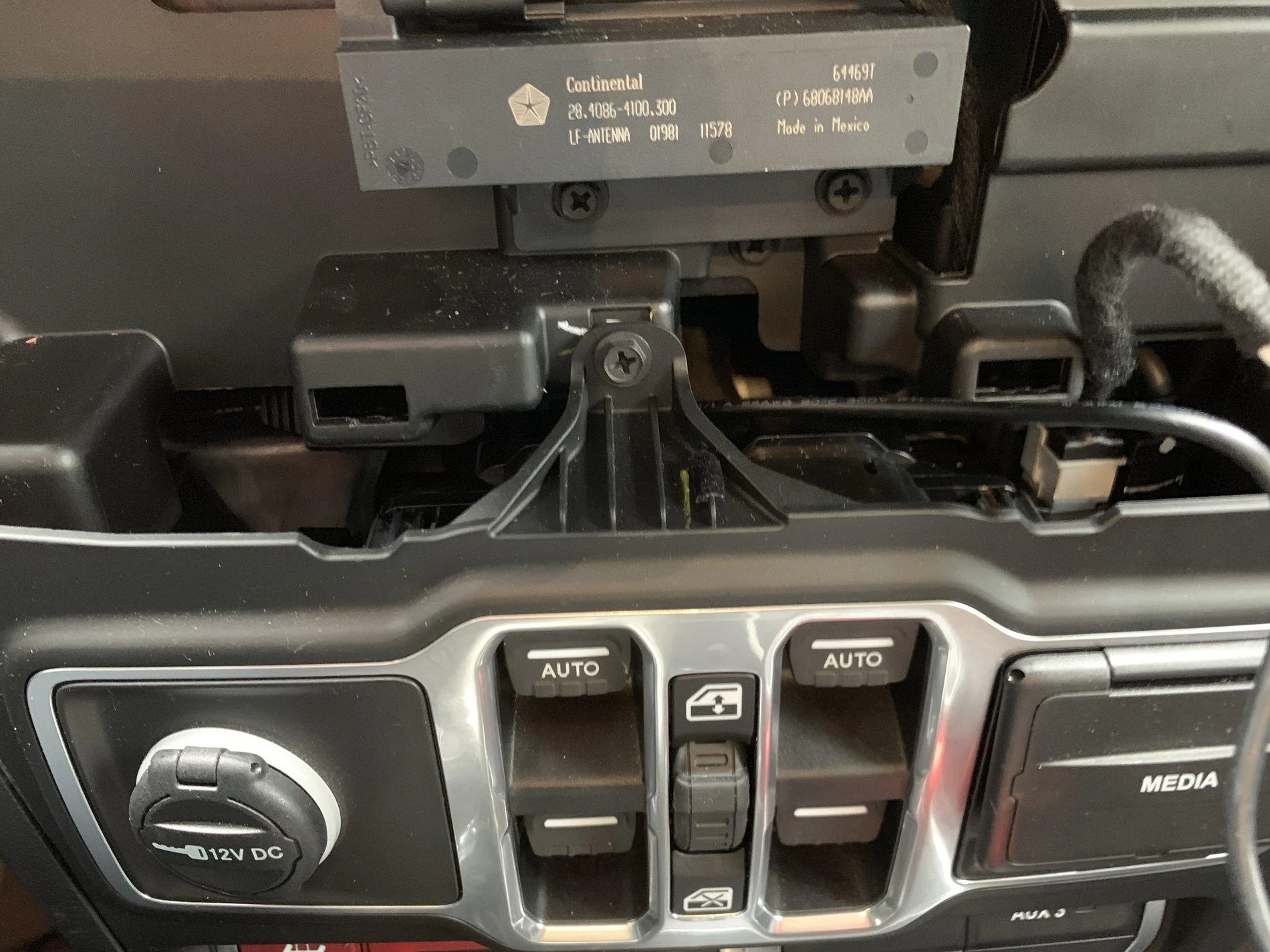

Attached the charger to the mount and fed the right angle micro usb cable between the 8.4 display trim and the dash.
Routed the USB cable behind the climate controls and over to the AUX switch output wires where I attached them to the Accessory lead (Orange with Pink stripe) so the charger is only powered on when the ignition is on.
Buttoned everything up.
A couple things that are nice about the Nillkin charger are that 1) it has a couple faint blue LEDs on the back of the charger that light up when the phone is properly attached so you can see when the phone is charging, and 2) the magnets in the case are solid. I'm not concerned about the phone falling.
