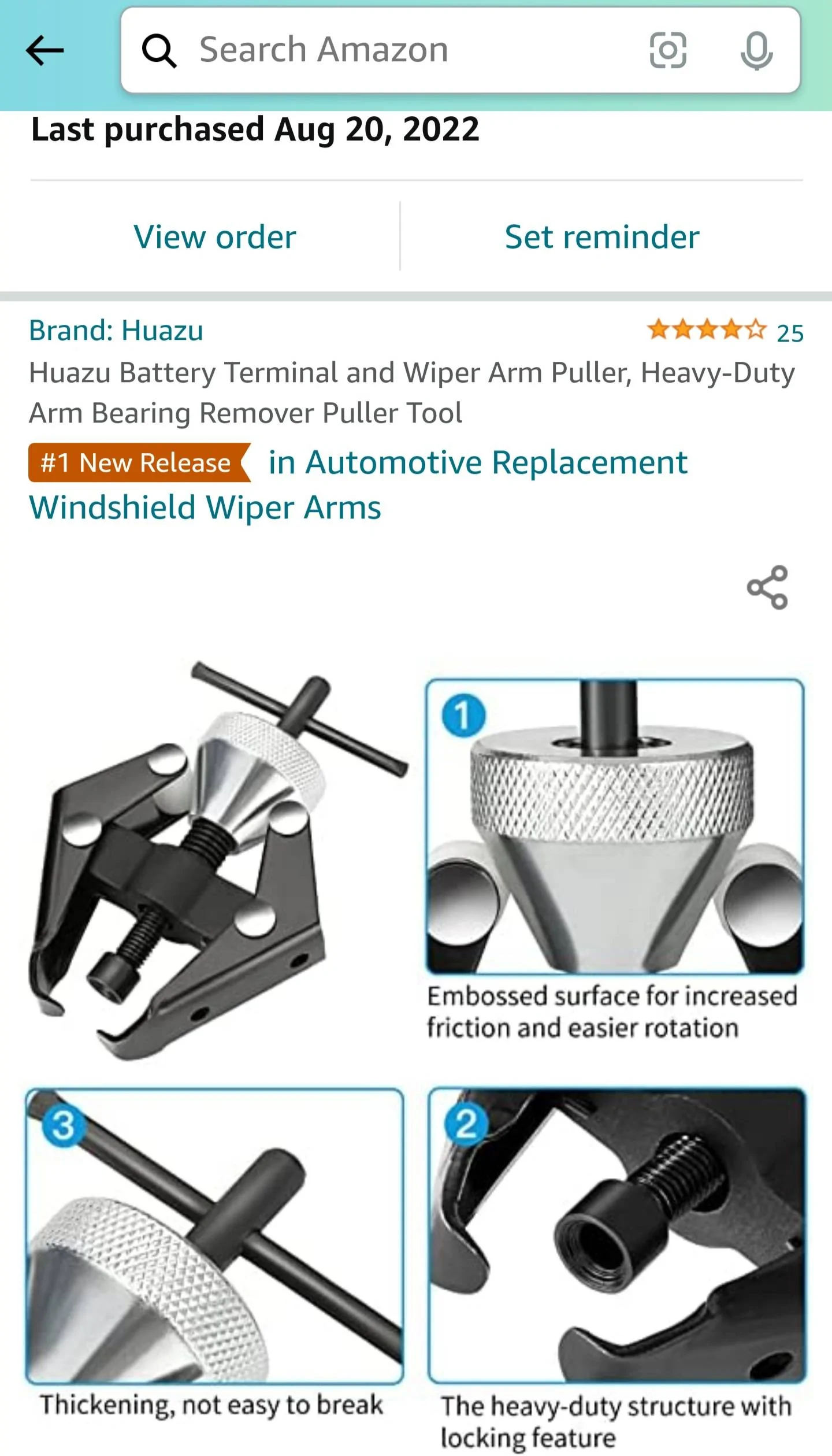

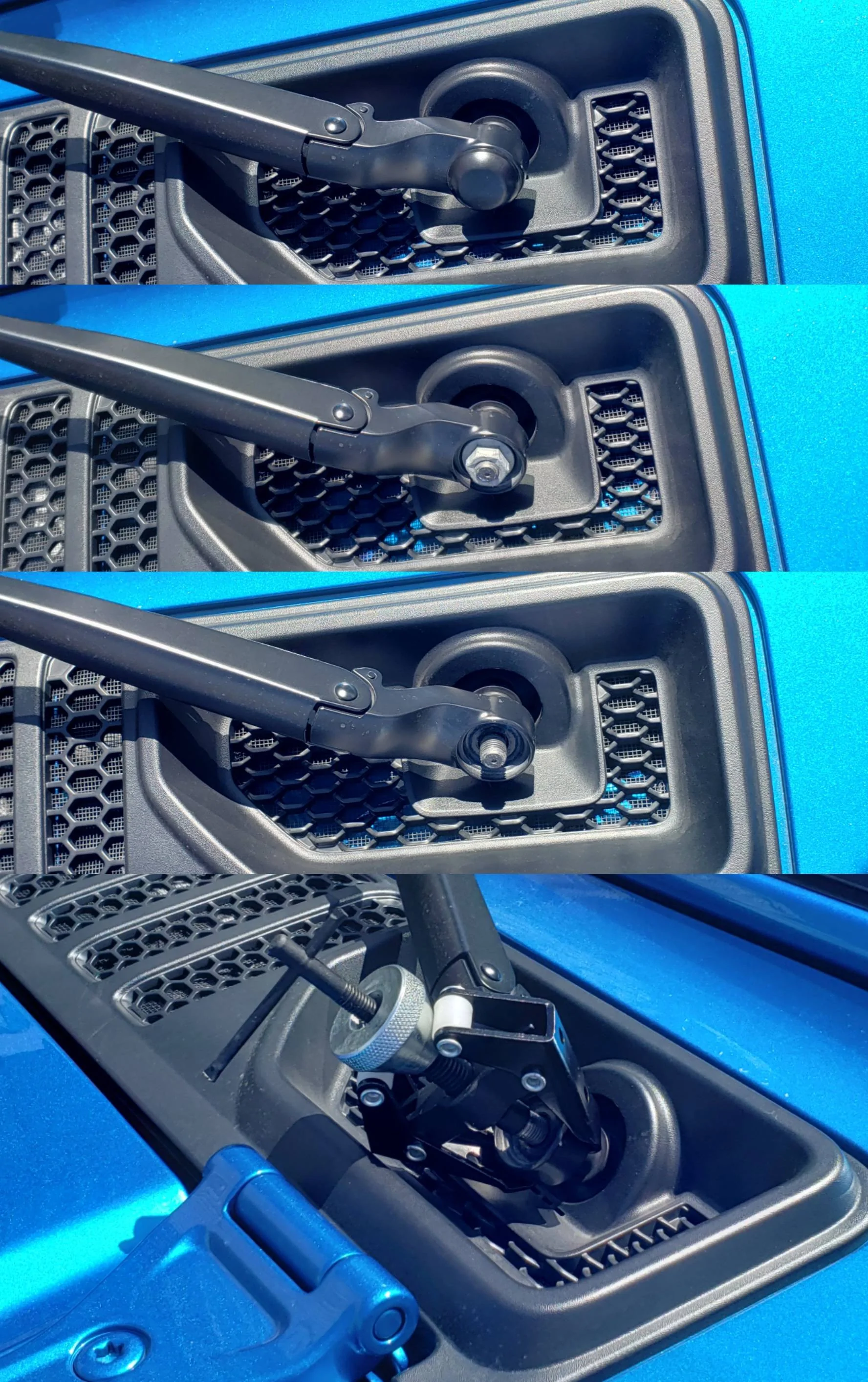

If you have attempted to remove your wiper arms, you probably noticed they are on tight. Some info below on the wiper arm/battery post puller I got for 11 bucks, shipped.
There appear to be two similar versions on Amazon. Be sure you get the new one with the beefier screw to prevent handle failure.

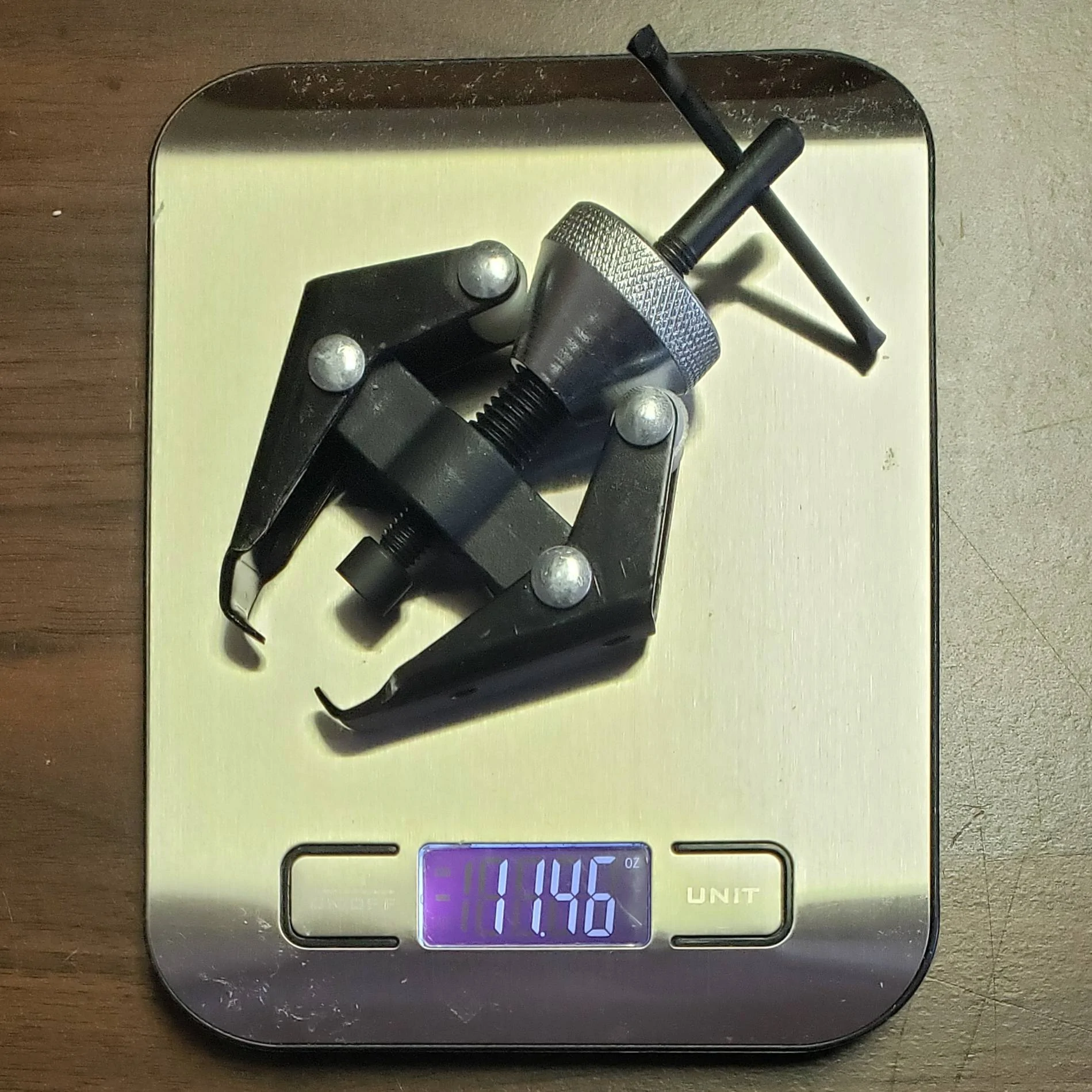

I was surprised with the weight of the unit. Probably 3x heavier than I expected at nearly 12oz.
Jeep Wrangler JL My new wiper arm puller tool 20220826_195510
It was reasonably priced, is simple to operate, fits fine & works perfect.

You first remove the wiper arms. Pop off the plastic decorative caps, remove the two retainer nuts & pop the arms off & attach the puller.

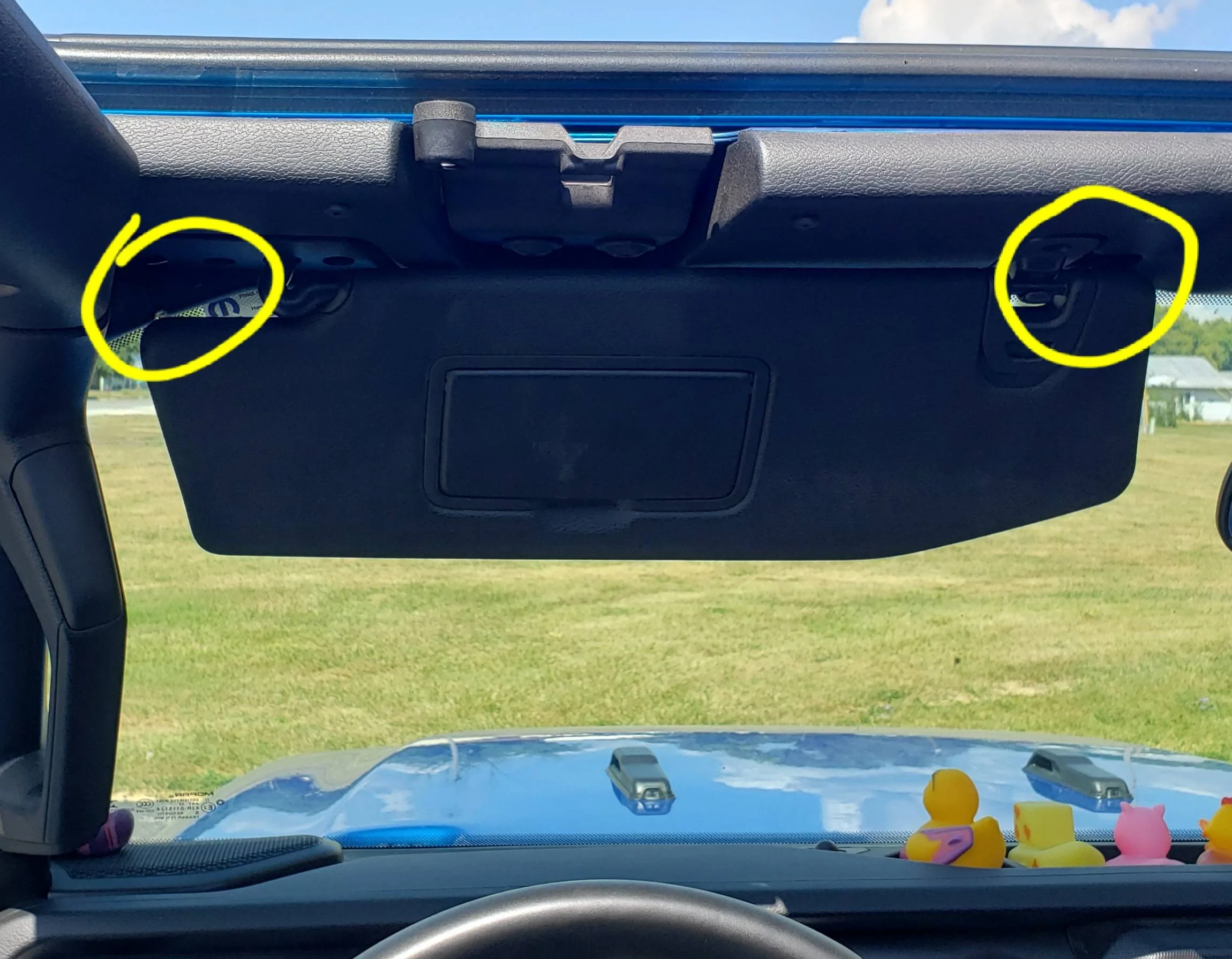

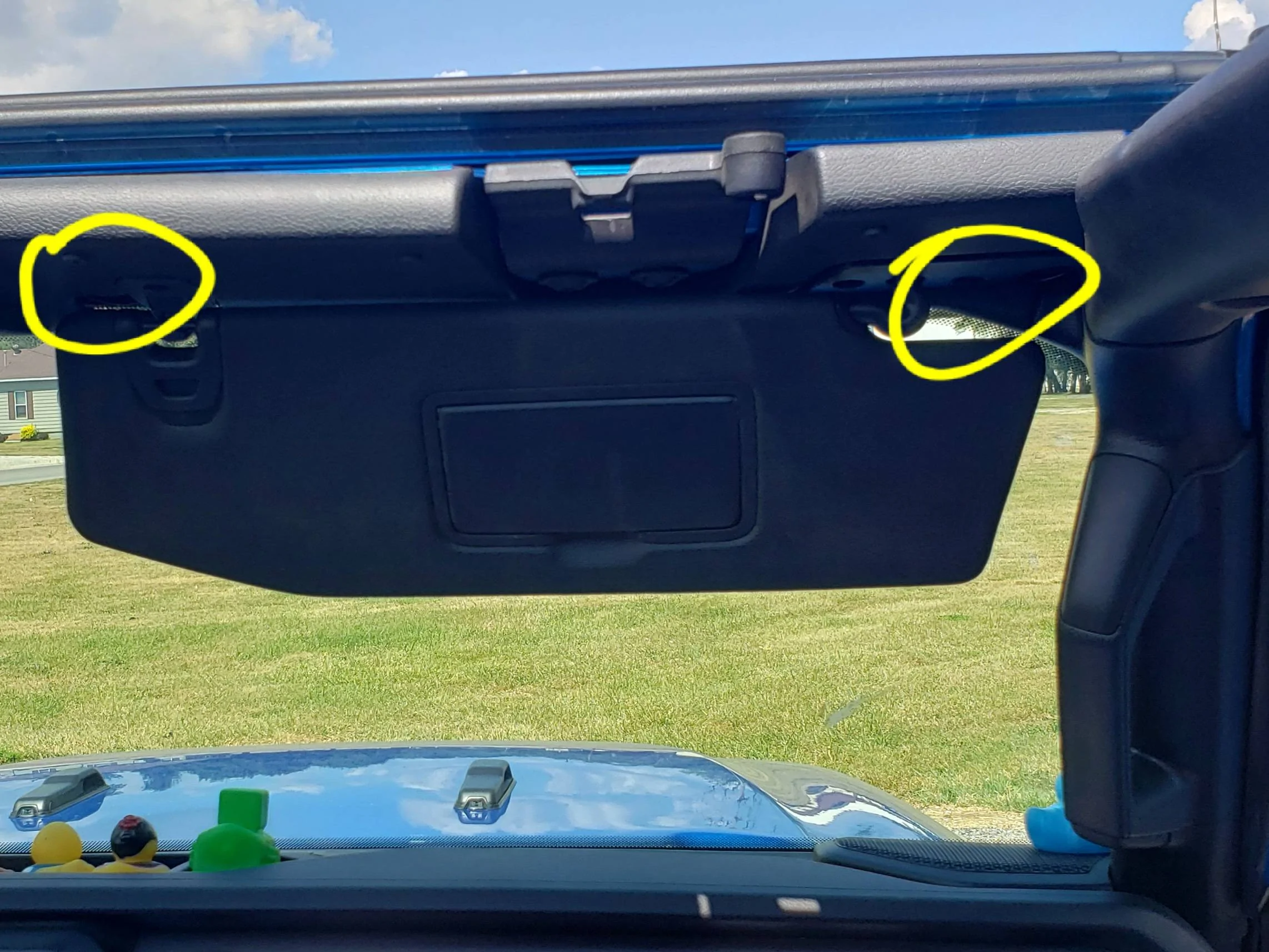

There are only 4 screws that need to be removed to drop the windshield. They are T40s (highlighted in photo). I use the toolkits T40 bit in a cordless drill to speed the removal process & drop the winddshield.

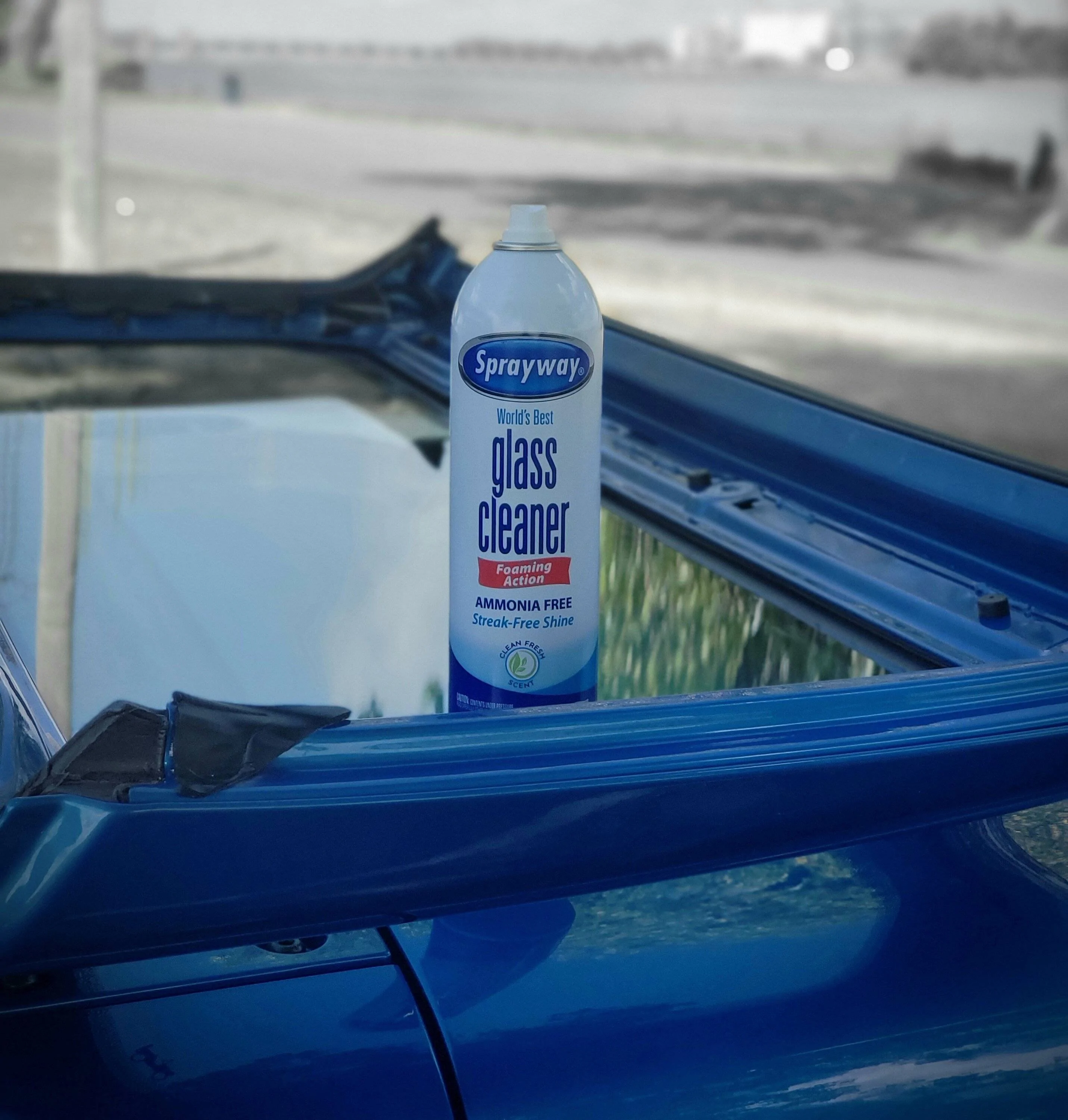

As mentioned in a previous post I use the Sprayway brand of foaming glass cleaner, which is ammonia free.

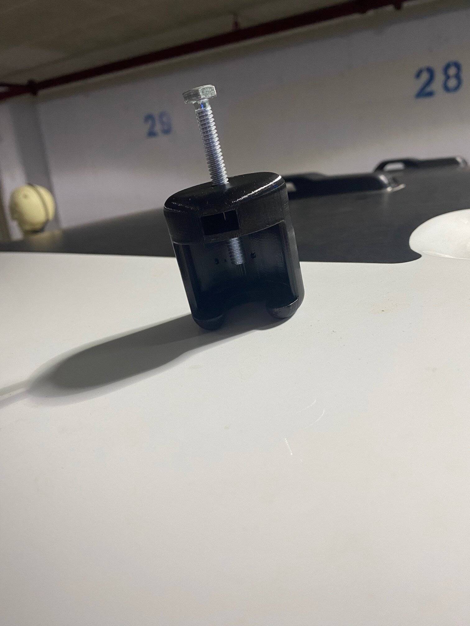

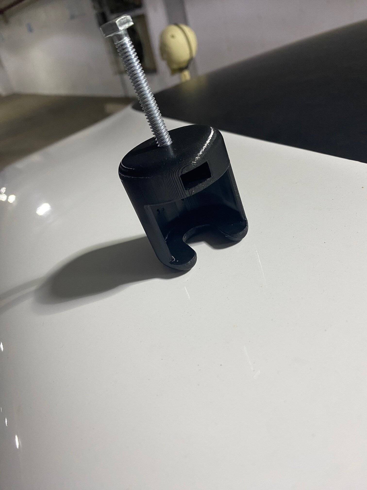

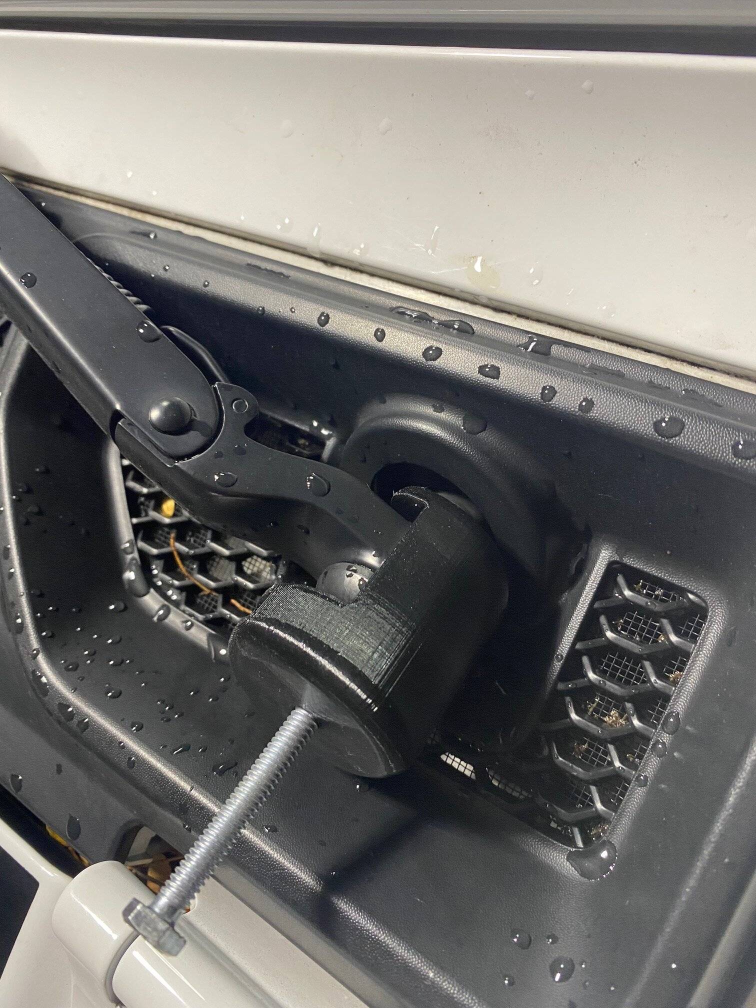

thats nice ,

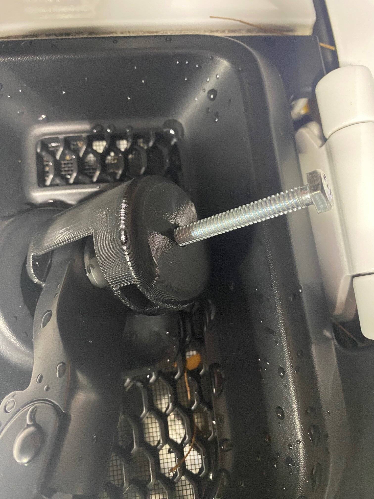

i just printed a puller and it works great !!!!! - now i need to print some sort of handle for the nut to make my life easier , maybe just a simple knob to fit over the nut

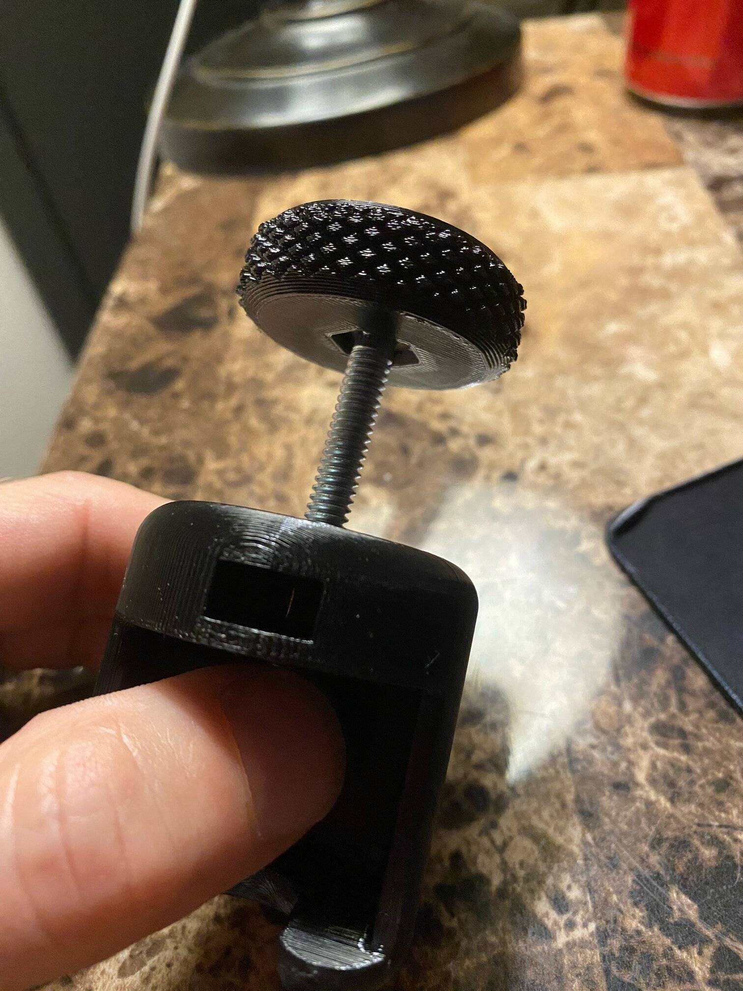

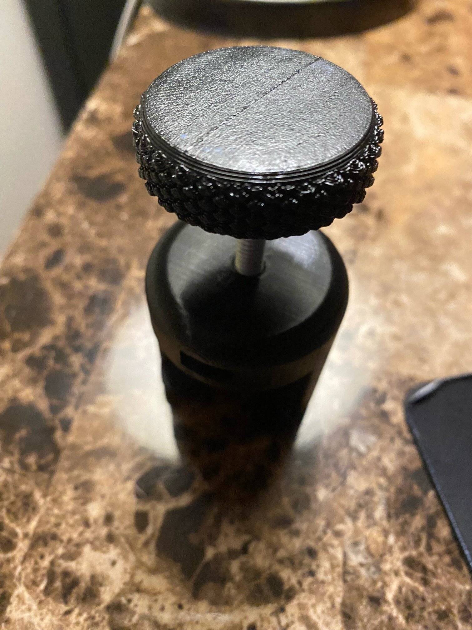

ok, so i made/printed a fast knob for top of nut with some knurlys, soooooo much better
i just need to machine the tip of the bolt to a point to make it sit nice on the wiper stub

Nice setup you have. If the knurling gets too tough on your fingers, you can drill a hole horizontally through the head of your bolt and put a long roll pin in it (that would make it similar to the store bought version.) I have done this on several of my little jigs.

thanks for the tip - i will see how this works out , its not that rough of a knurl , but i will keep your idea in mind !!!!
@jaymz i can also wiggle mine to come off but i dont like to stress the stud anymore then need be, iv broken 2 with my other jeeps iv had doing it that way . the tool makes it slide off nice and smooth

Just an fyi, Sprayway is an awesome cleaner, using this for years. Just for normal glass cleaning, not just for our Wrangler windshields. It’s a good product, doors, house windows, etc.

I've had the opportunity to look over and use this wiper arm puller that @elf883 has 3D printed/has come up with.
Can tell you his 3D printed tool is real nice. Terrific print job!
The knurly knob on it is real nice.
Very good wiper arm puller that now is in my bag of tricks so to speak.
