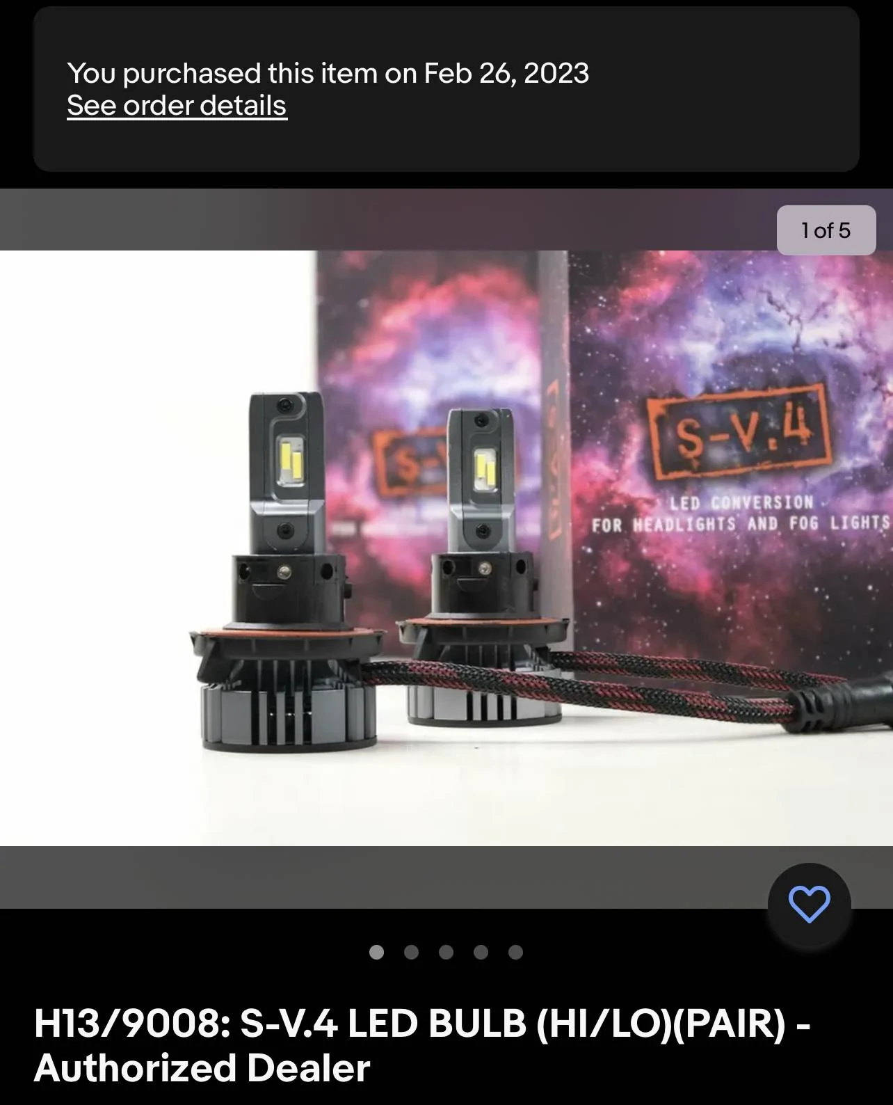

Hey guys proud owner of a 2019 wrangler unlimited JL. I noticed the stock halogens aren’t that bright and I watched a video on YouTube of different LED bulbs and decided to go with the SV. 4’s. I’ll get the dog light bulbs and turn signals at a later time but for now got these. Anyone have any luck with these and if so how do you like them? Thanks

I hear ya. I just honestly can’t see that well with the halogens. And yes I have 20/20 vision at the moment but eh what the heck? Let’s see how they are I’ll post pics before and after installation

The SV4s are great bulbs. They have the lighting elements and clocking set the same as the halogens, so they will work well in the factory housings.
A lot of cheap LEDs out there have the elements in the same place on all of the bulbs and require you to figure out how you want them clocked and how deep into the housing to put them. Those are the ones that create terrible glare and are impossible to aim.
