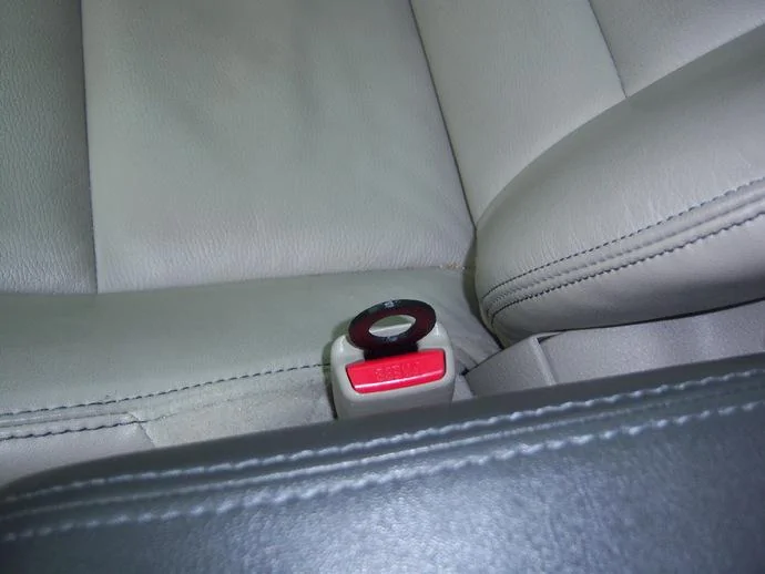

I did this, I still get a visual warning but no chime...
