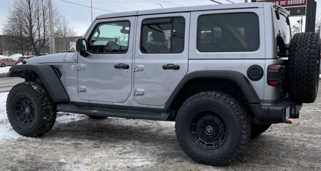

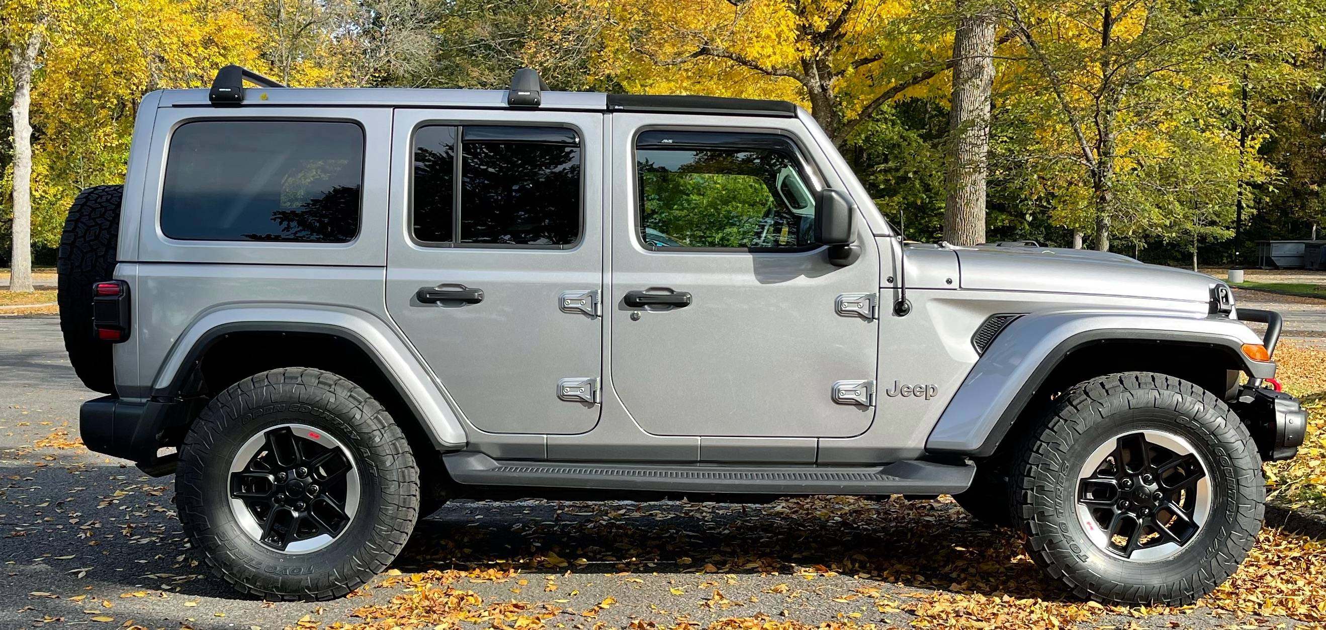

if I may, before with Sahara fenders, after with black MP Concept fenders and most recently with them painted.
Jeep Wrangler JL MP Concepts sequential turn signals A1016777-7E92-4AD8-8EB7-8D2BD73D782B
Jeep Wrangler JL MP Concepts sequential turn signals F6FF698A-575C-421C-9B88-6668F6DF2BE6
Jeep Wrangler JL MP Concepts sequential turn signals B22434FA-A37A-4E7E-97A5-7EFBB3A9B8B4

They are identical, the XR fender extensions even confirmed that the holes are at the axact same place as oem. Biggest difference is the fender liners that need a bit of adjustment and who’s hole arent in line with oem.
I too went with them because I waited 9 months on backordred ones with my local dealer. They ended up costing a bit more than double what the Mopars would have cost me.

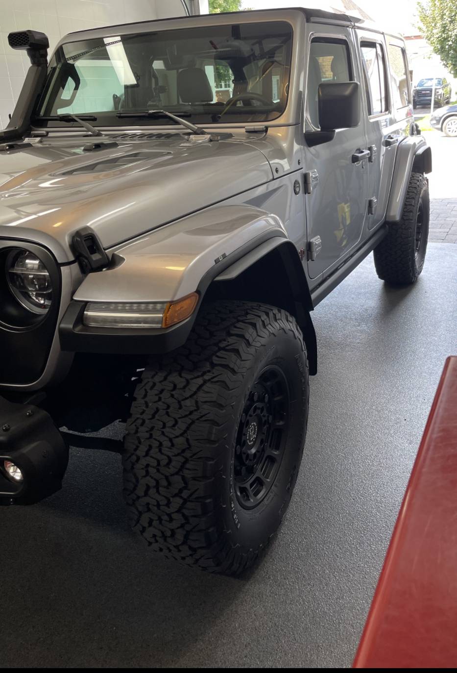

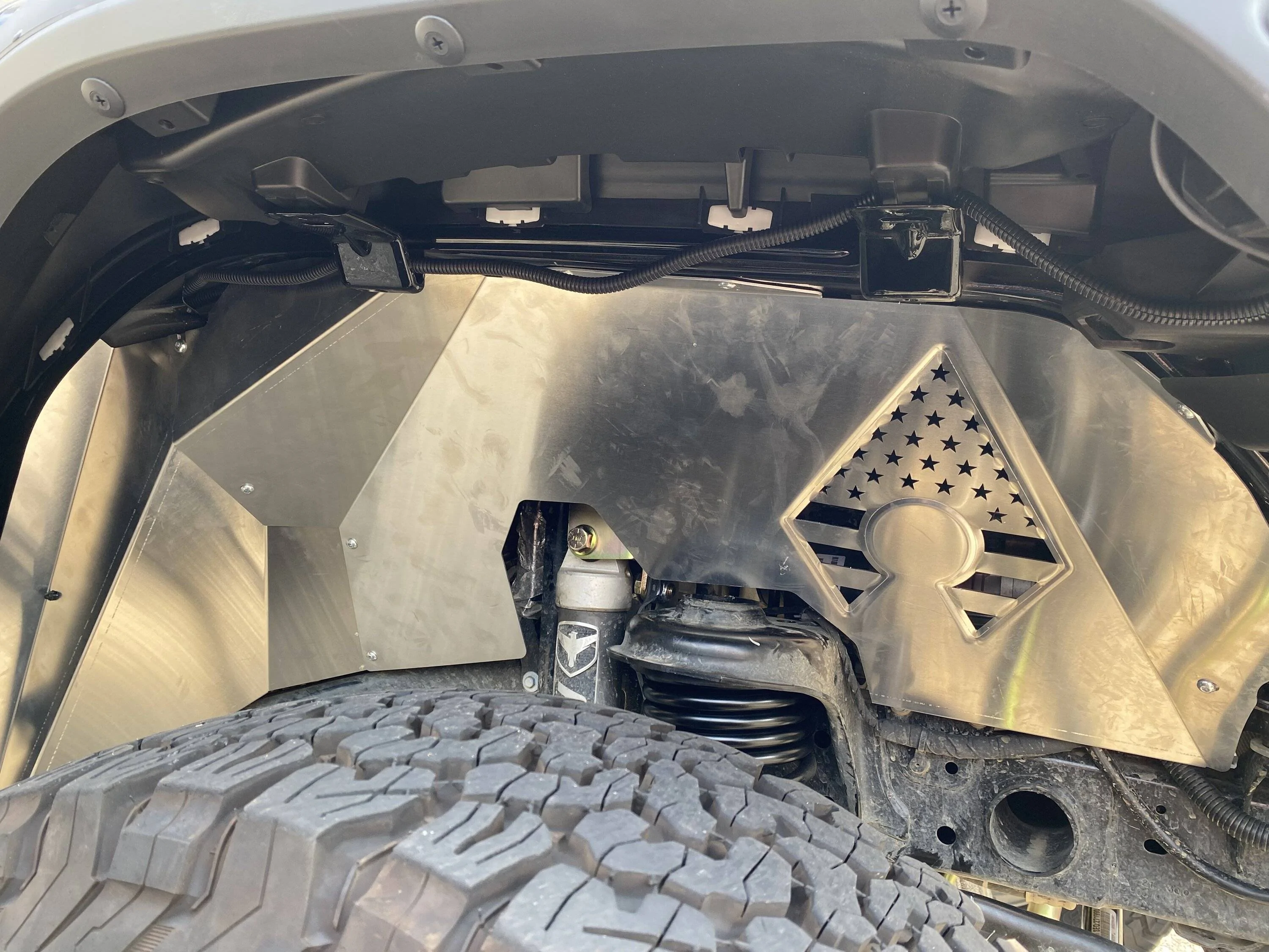

Jeep Wrangler JL MP Concepts sequential turn signals E98B604E-61DA-4FFB-8049-68D4E86FB429
Jeep Wrangler JL MP Concepts sequential turn signals 947CB39B-5E3B-475B-86F7-DCC6CBFDAF1C
The lights are fine. Obviously I wasn’t sure about the light setting needed to get hyperflash to clear itself. The instructions just said it would clear on its own after a few cycles.
The box is massive, to warn you. It is not heavy, but it’s big. I also got this stinger from XT. It was open box, but if that’s how they ship bumpers I can totally see how the aluminum one wouldn’t survive. My fenders also showed up scuffed, but I wanted plastic because they’ll get abused on the trail.
