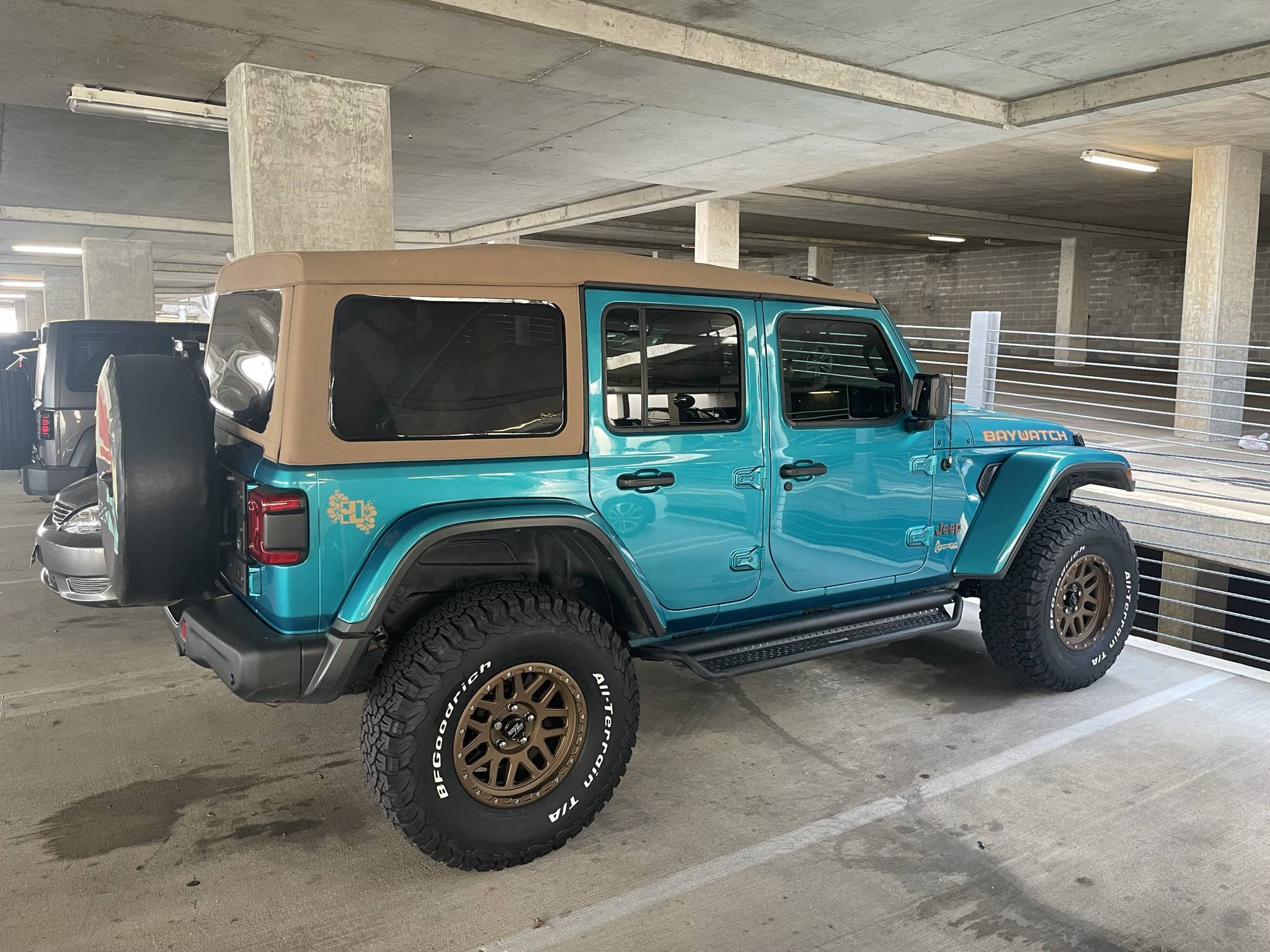

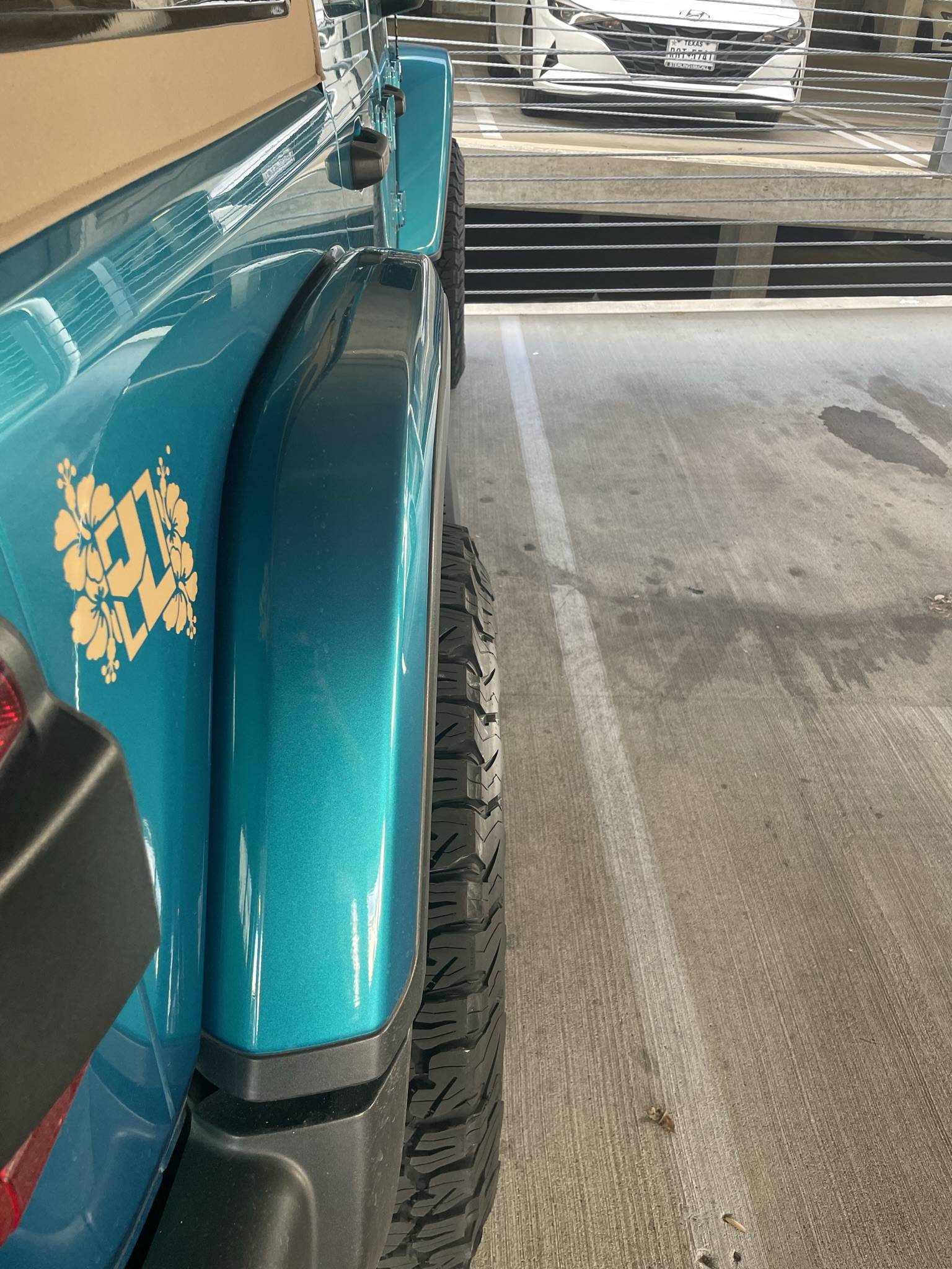

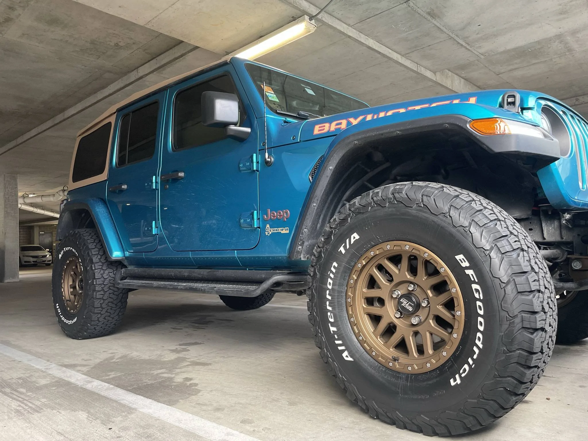

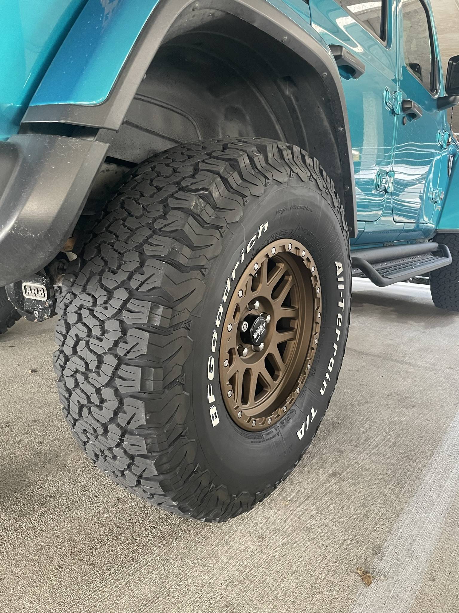

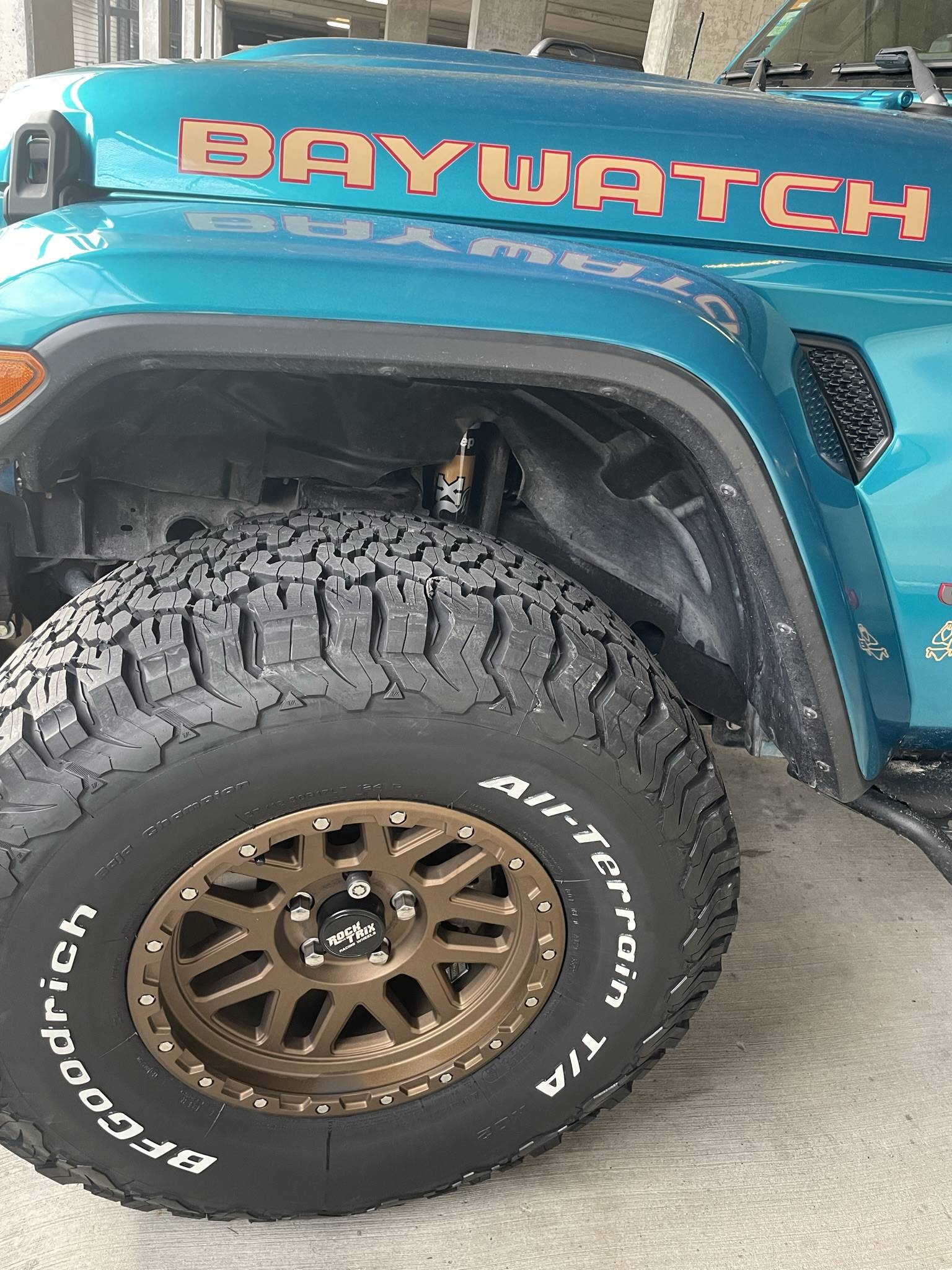

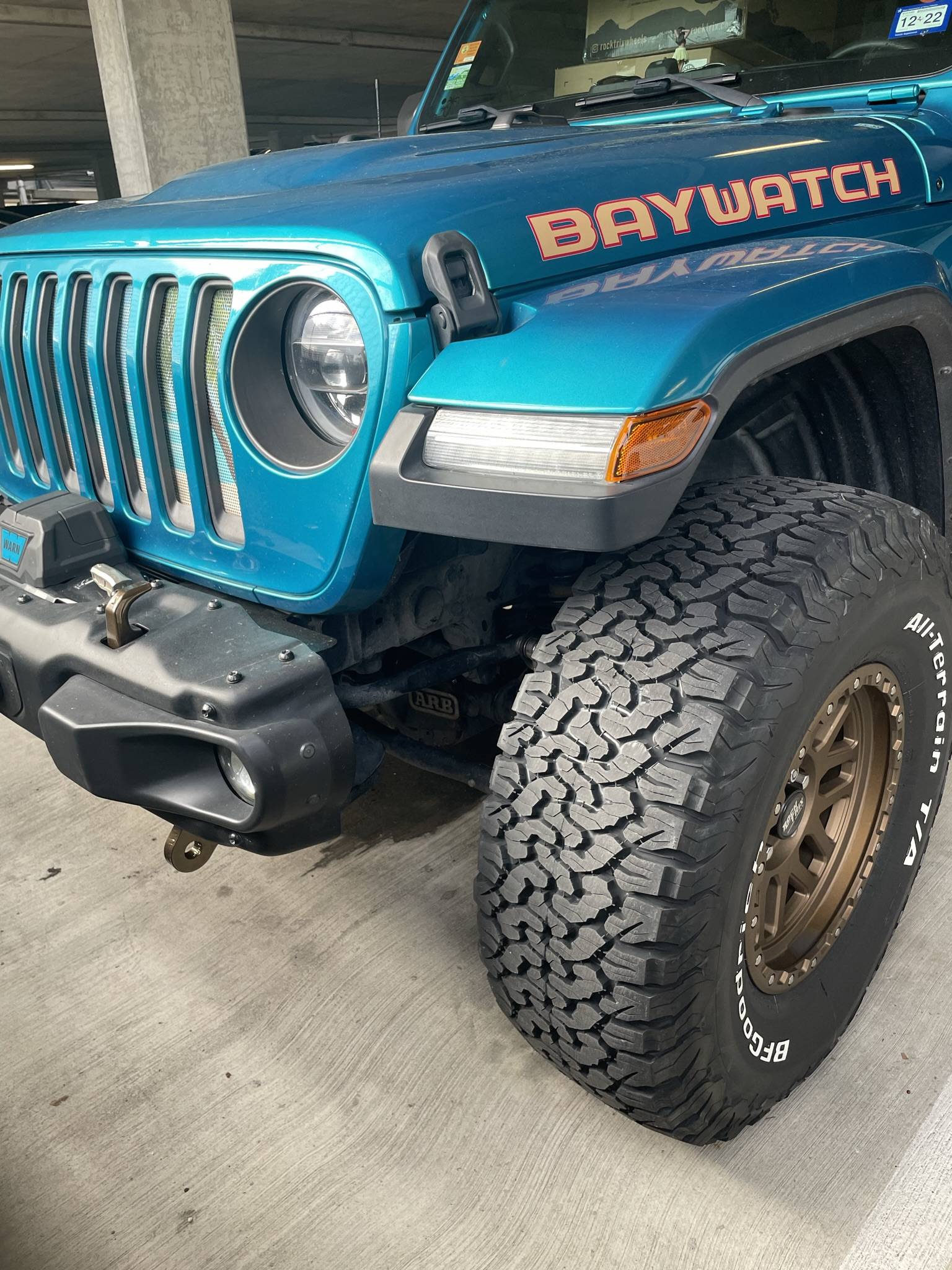

I installed BFG KO2 37x12.50R17 tires on the Rock Trix RT110 17x9 +12mm offset wheels. The spare is mounted to the tailgate with the Amazon-version of the Mopar Tailgate Reinforcement / Tire Relocation setup, floating over the stock Mopar steel bumper.
I didn't need to use any spacers (since the stock Rubicon setup is so similar to this new setup relative to backspacing) and I have about 1/2" of clearance between the bottom of the tire and the bumper.
I will upload a photo of the gap once I pick the Jeep up from the alignment shop, but here are a few pictures of the new setup, including 392 takeoff suspension that provided the necessary lift.
