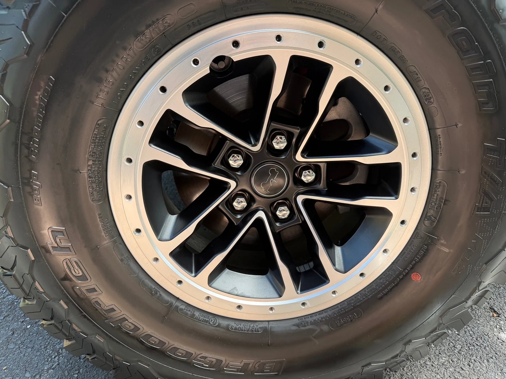

Have you guys used anti-seize on the bolts for the mopar simulated beadlock rings?

Yes I do. If not you will get corrosion between the wheel and bolt. I remove my rings about every 3 or 4 months to touch up and before I used antisieze I was seeing corrosion on the wheel threads. I also switch the rings to use the wheel as a true bead lock.

no; the installation instructions don't call for anything on the threads.
using anything on the threads would require an adjustment for the torque specs that most of us haven't the wherewithall to calculate.

You are bolting steel bolts into an aluminum wheel in a wet, sometimes salty environment. If you don’t use anti-seize, the bolts will eventually seize in the wheels due to corrosion of dissimilar metals. If you unbolt them fairly often then not an issue but most people don’t.

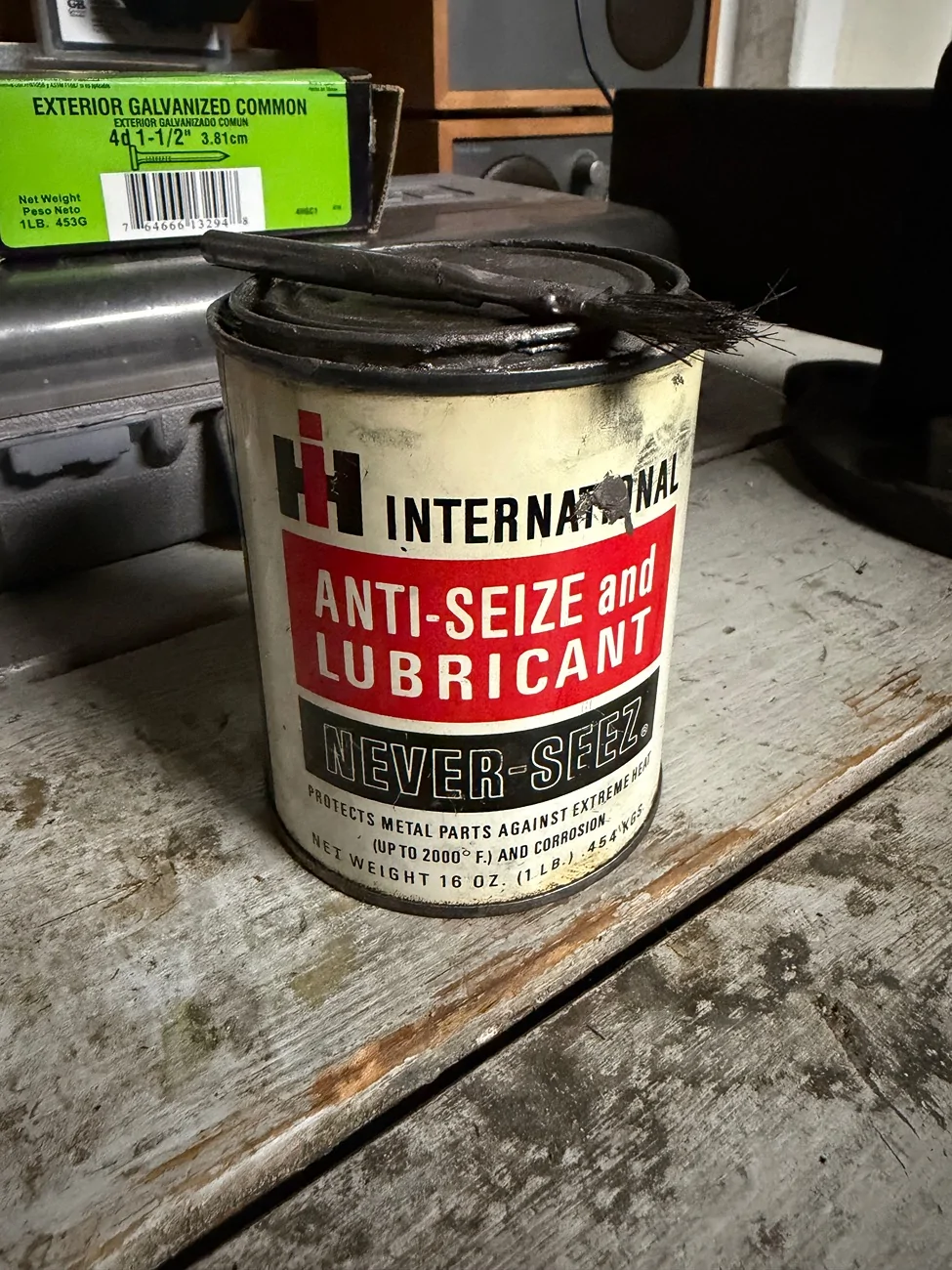

Absolutely yes, I applied never seize liberally to all of my trim rings bolts.
