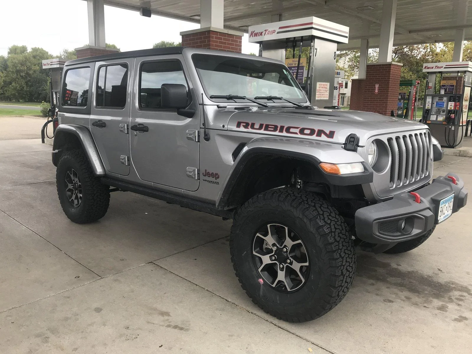

Just got mine installed at Fury Jeep in St Paul
2.2 hrs at 117.75/Hr....259.05 + 95.00 + tax was 379.71
259.05 for lift and 95.00 is for the alignment
1240.00 for lift kit off eBay from Cortland Chrysler Jeep
That's a VERY fair labor charge but they charged you $95 to center your steering wheel if your alignment was fine before you went it. Steer ahead and toe are the only adjustments without adjustable control arms or track bars. We have a knuckle to knuckle tie rod meaning toe does not change when you raise the suspension.
