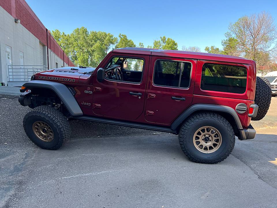

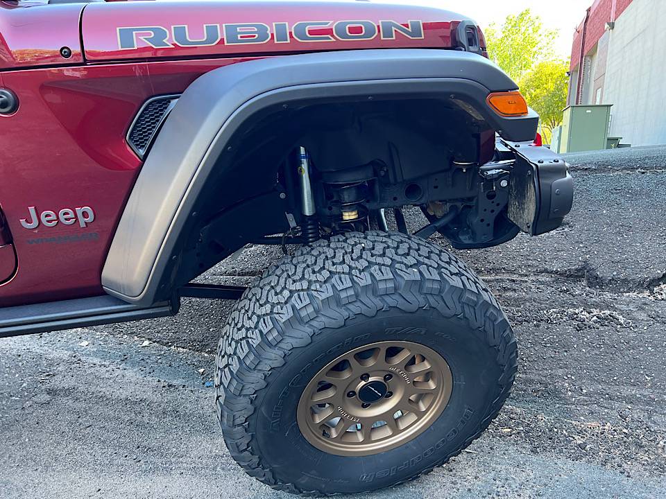

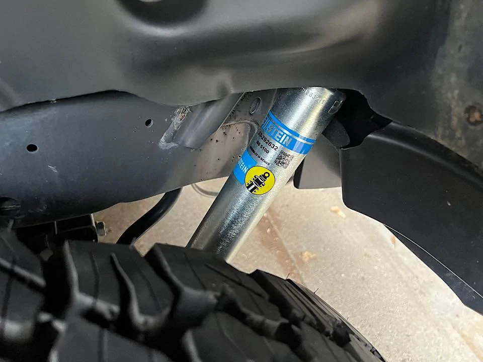

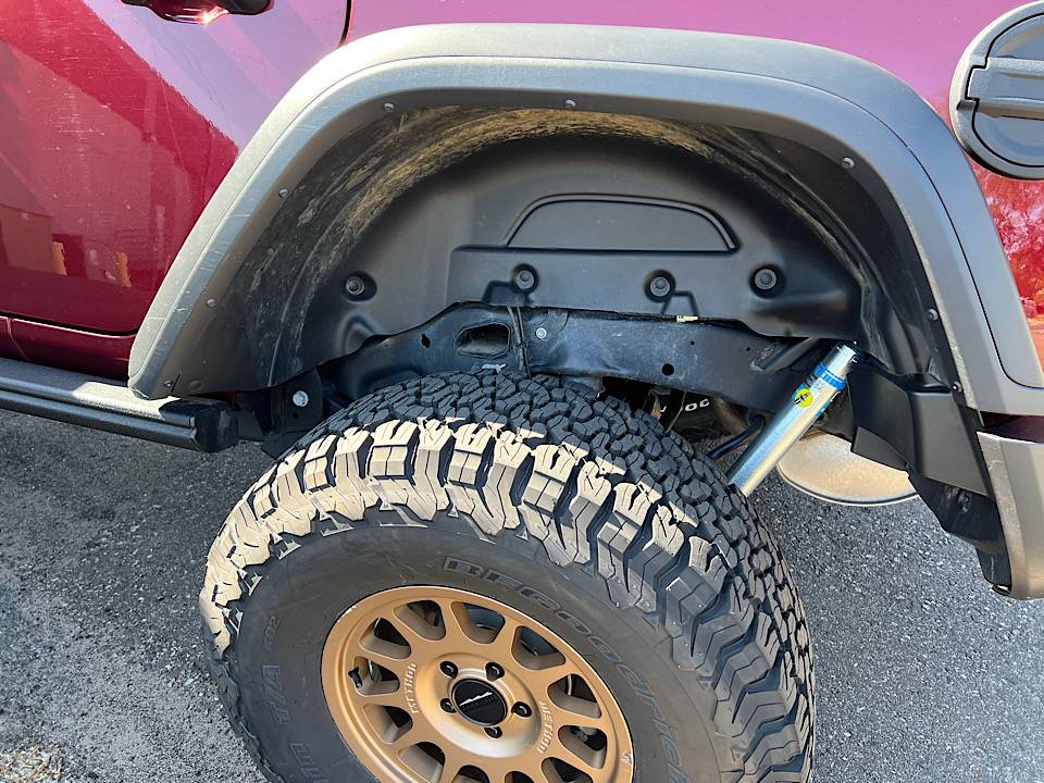

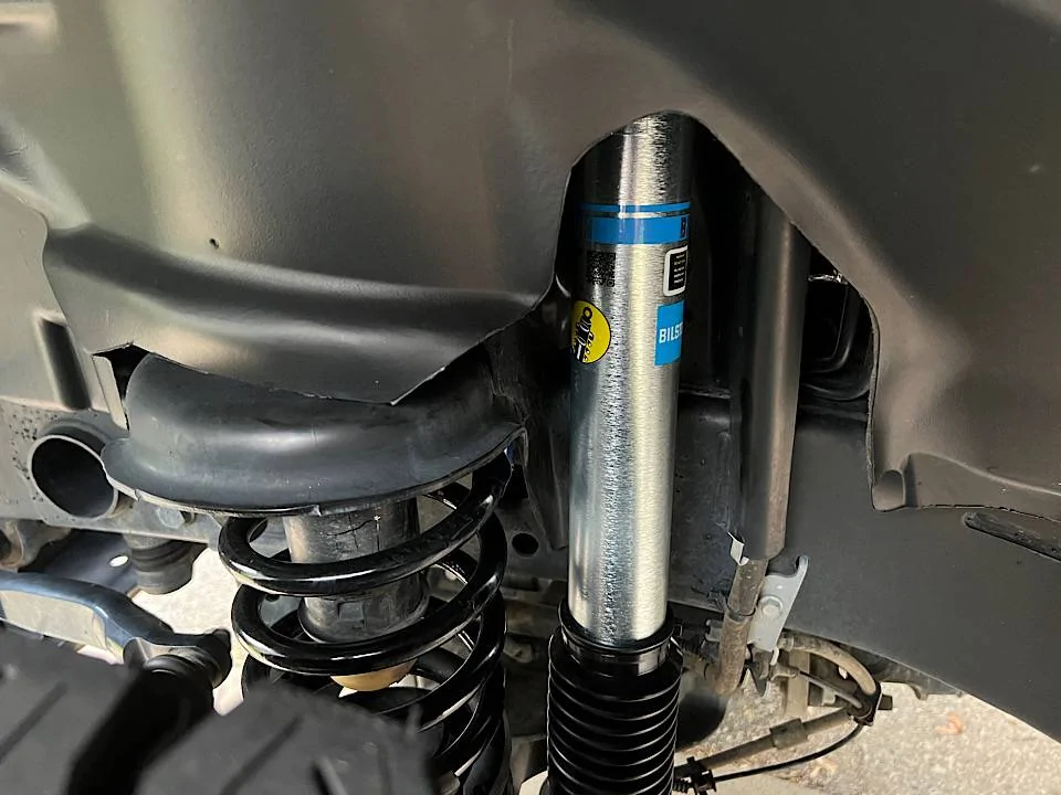

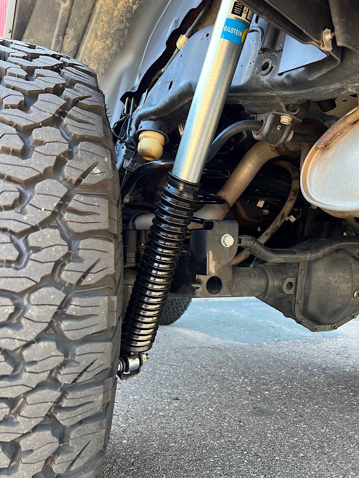

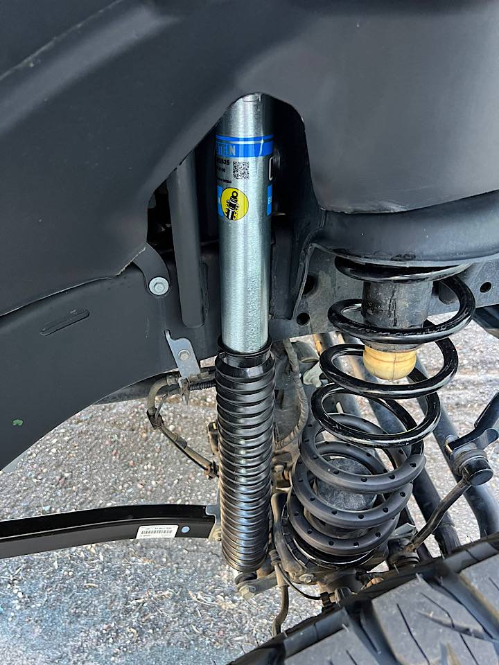

I installed these yesterday evening. Did have to bend the front brake hose bracket up a bit as the hoses were stretched a little too tight at full droop. From the Fox 392 I had on, the 5100s are 2 1/8” longer in front and 2 3/8” longer in rear (from AnnDee’s shock matrix). So gaining some lost flex from when I added extra bump stop to fit 37s. I'm running the Mopar 2" lift springs and the Mopar LCAs.
(Turns out the Foxes were pretty worn out after 20-25K miles. Hardly any gas pressure.)
Ride on the 5100 is pretty good. Seeing conflicting comments so wasn’t sure what to expect. They are only $400 a set afterall.
Firmer feel on impacts but not harsh. There’s a “roundness” I like to call it. Firm but not harsh. Great body control. From my limited time on them they feel good.
We’ll see how they do as I get more time on them and and eventually go wheeling with them also.

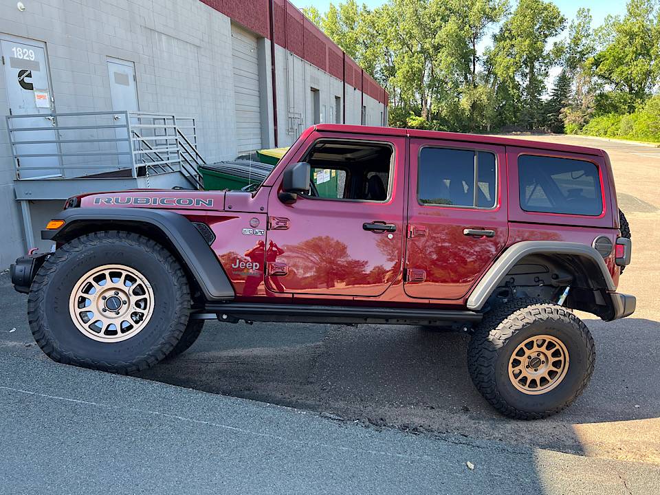

A few more days on the 5100s. Definitely liking the ride quality. Good support and body control. But a plush feeling hitting bumps and square edges. I’m on 37 KO2s load range D at 28 psi cold.

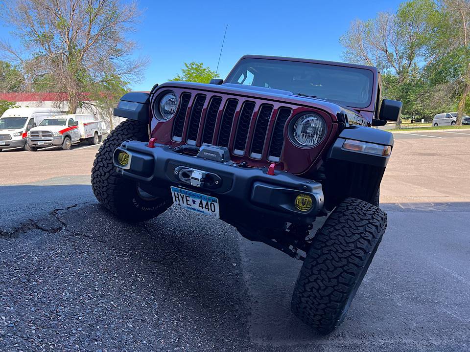

Here’s some flexing… because why not ?
Actually was checking to make sure no rubbing or pulling hoses and wires…
