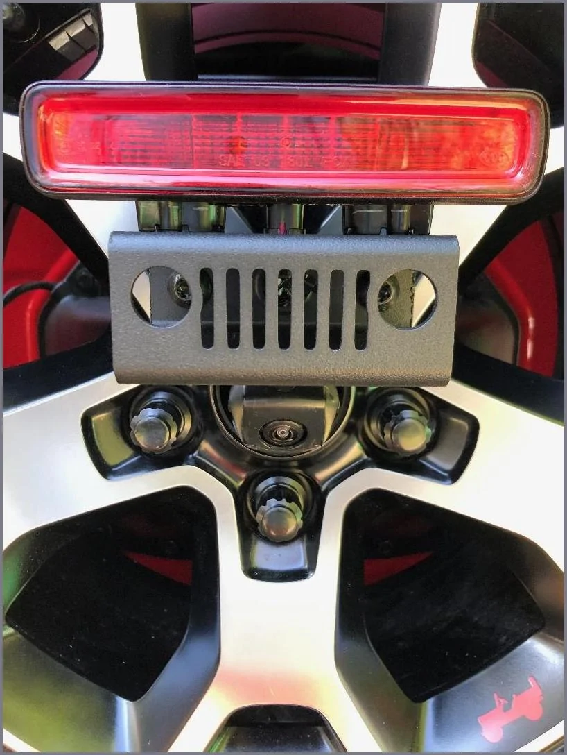

Okay so this is just an extra piece to put the light in the middle of the tire if I don't want it on top like you're saying got it thanks

If you have to take the spare off whats it take to take this off ?
Spare is held on with 3 lugs, 2 of which are what also hold the relocation bracket in place. So you remove 2 small bolts that go into the two extended lugnuts, the 3 lugs themselves and the bracket/light dangles til you remount the spare. So, nothing extra to remove to get spare off.

Installed this kit on my stock 2dr. Rubi JL. Looks great! Install time was about 20 mins.
