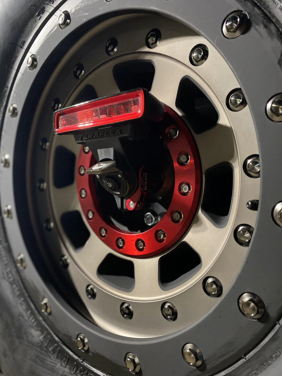

Teraflex looks nicer.
Does Teraflex sell the brake light relocation on its own or do you have to buy the spare tire mount kit/brake light/camera mount all as one unit?

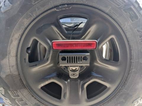

Installed this kit on my stock 2dr. Rubi JL. Looks great! Install time was about 20 mins.
Where did you feed the brake light wire through? I don't see it in this or the other enlarged picture.
I'm trying to make my install clean but I also don't like the several extra steps involved to remove the spare...

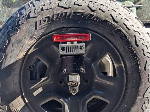

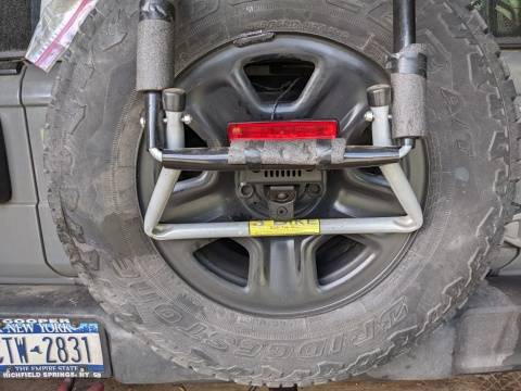

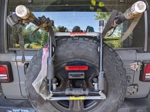

I got the Mopar relocation kit; it was ok, but I wanted it higher for visibility and a better fit for the spare tire Bike Carrier.
I made a bracket that raised the light 3", closer to the curve of the wheel.
"Stock" position
Modified posirion
