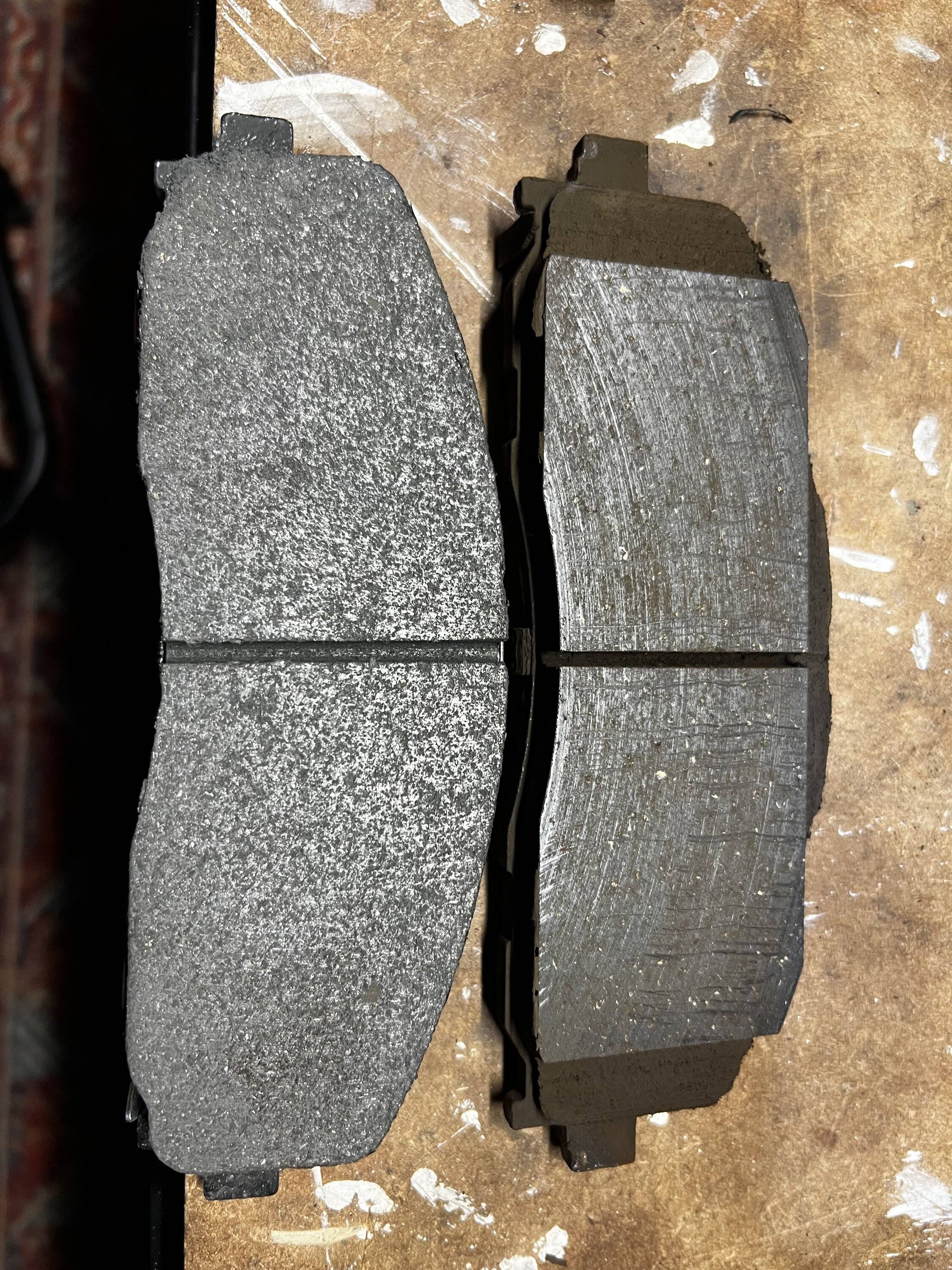

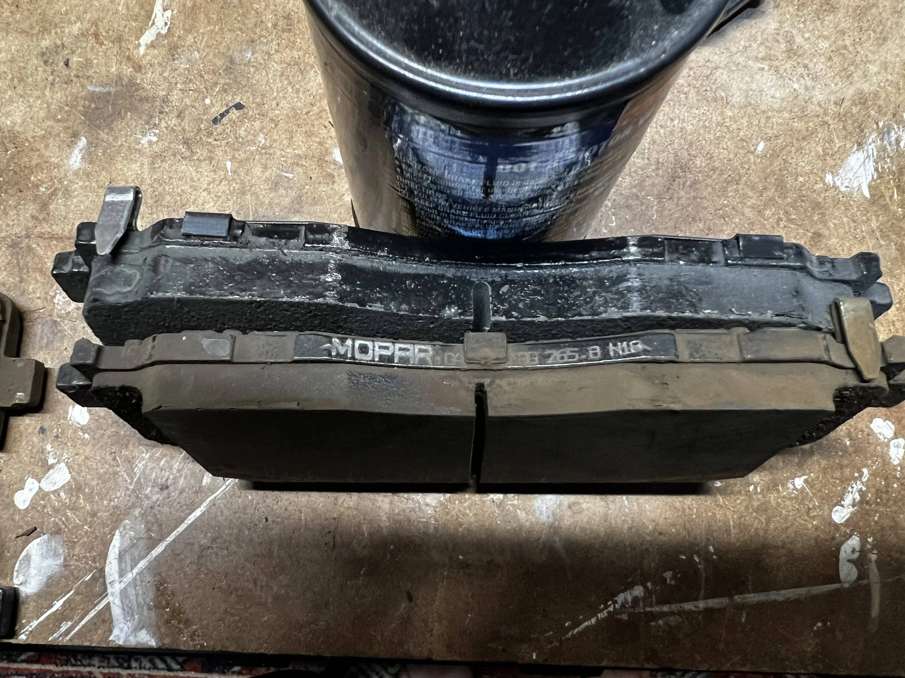

So the Jeep was built Dec 2018 and I felt it necessary to drop some coin on new pads and rotors now that we are 6 years old. That said the front pads still look like they have a lot of life in them, the rotor…well it’s ok.

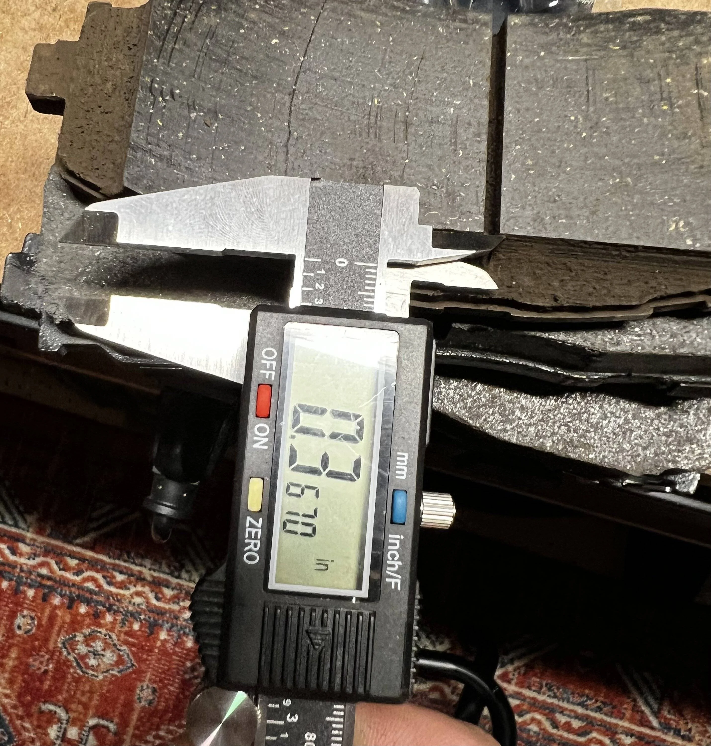

Then I did a comparison of my new pads (Raybestos) to the Mopar and noticed that there is a noticeable difference in actual pad surface. I measured the Mopar pads 1/2 (.500) shorter in pad material on both sides as compared to the Raybestos brand.
That said I decided to change them for that reason. I have the BRY brake code and ordered my pads though Rockauto as such. I’ll let you folks know if anything amazing happens using these.

That is more surface area. Is the pad composition the same?

Interesting. Is that a taper on the top of the OEM pad also, or is that a shadow?

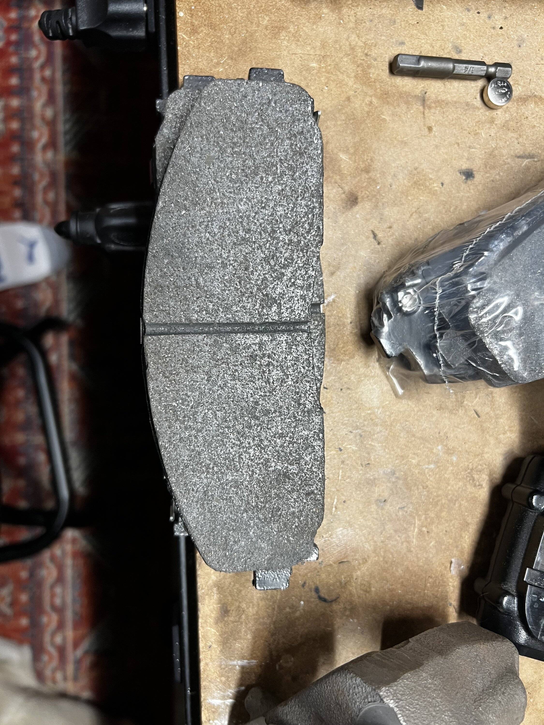

So the Mopar pad material is squared off, that shadow is actually area of the backplate that is empty just like the sides. Looks to be about .365 wide at its apogee. Meanwhile the Raybestos pads use the entire backplate.
Not sure what the Mopar pads are made of but the Raybestos are ceramic/semi metallic…says or on the box so could be either. Supposed to be OE spec’s.

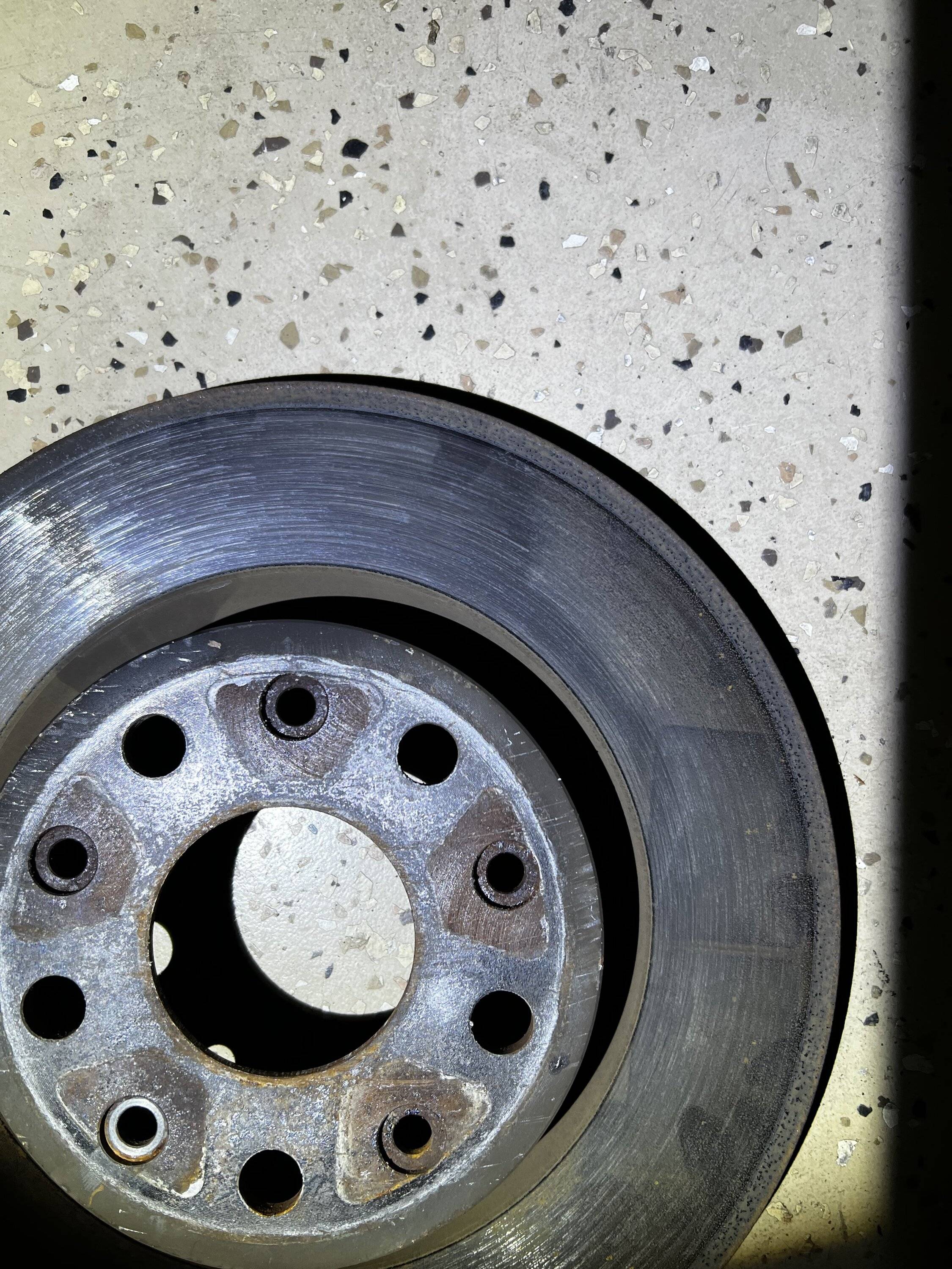

Oh also, this completely explains why the rotor has a rust ring on its outer diameter. There is no pad material contacting the rotor…so it doesn’t wear and rusts. Just seems weird that the OEM setup wouldn’t use the whole friction surface.
