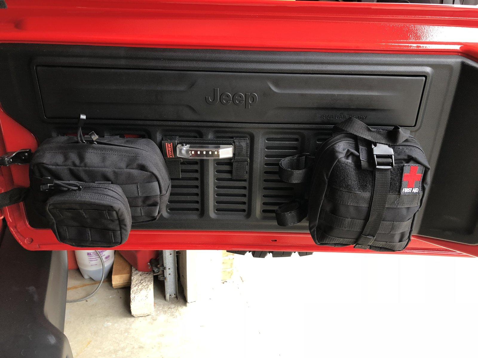

I got a few things from a company called "Tatical Baby Gear"- Their Molle wipe pouch and dump pouch. I figured this was a fitting thing since the whole reason I bought this Jeep was to haul my wife and son around, and maybe do some family off road/ out door adventures as he gets older. Super high quality products, and the tags even have the "proper Molle instructions" that show you how to weave it. It's pretty strong. I got them off amazon but their site is: https://tacticalbabygear.com/
I also removed my broken plastic boxed Medkit for a Funnasun Molle Medkit and stuffed it on the back of the driver seat. I'll be checking out some other bag options in the near future for some of my other stuff (tow strap, tree saver, winch controller, etc) that needs to be secured and out of sight. I didn't even realize this was the point of those slots in the tailgate as they were plastic and didn't think they could hold anything. I'll have to check it out a little closer. Tools are still getting locked into ammo cans and bolted down, though.

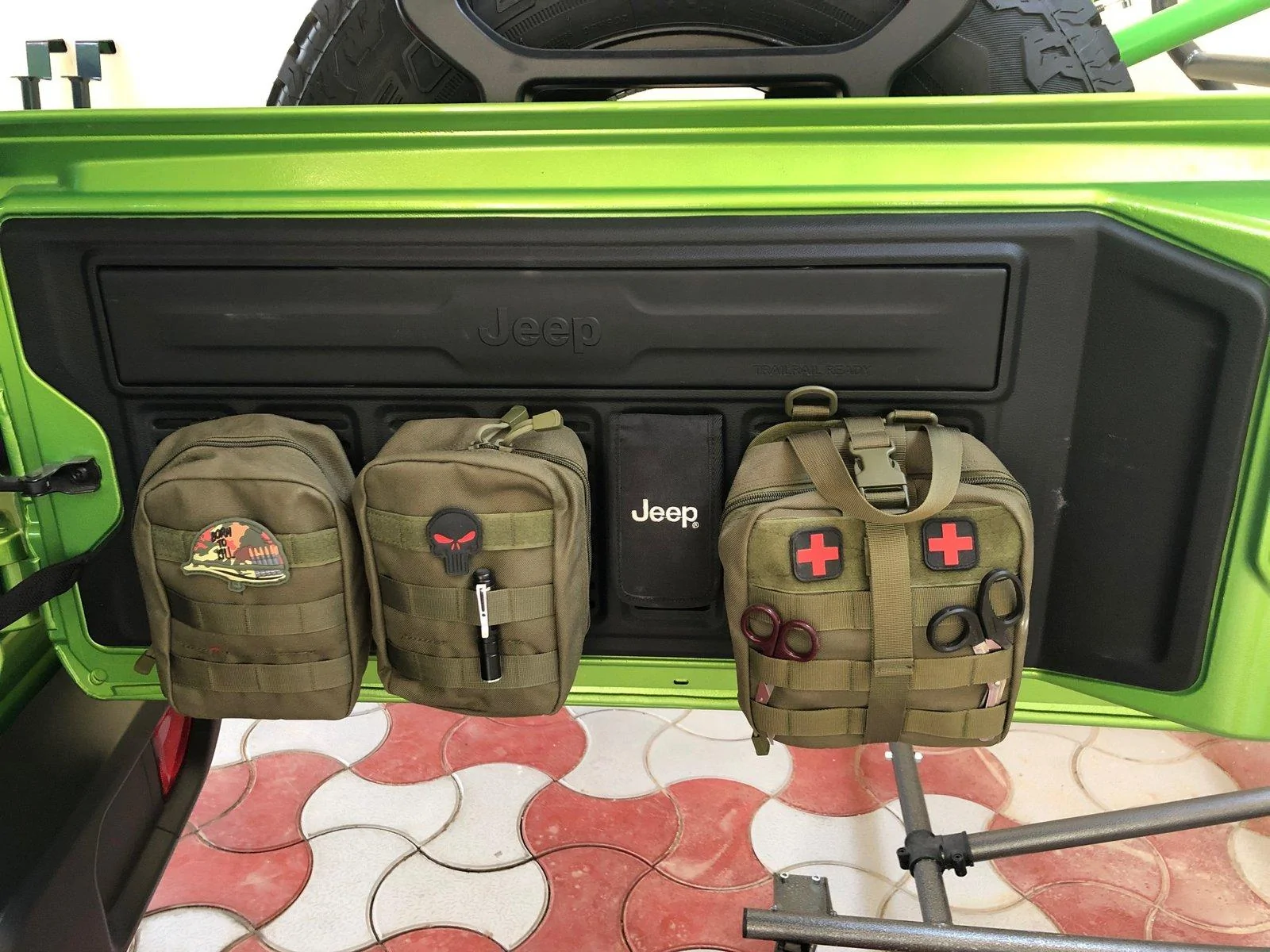

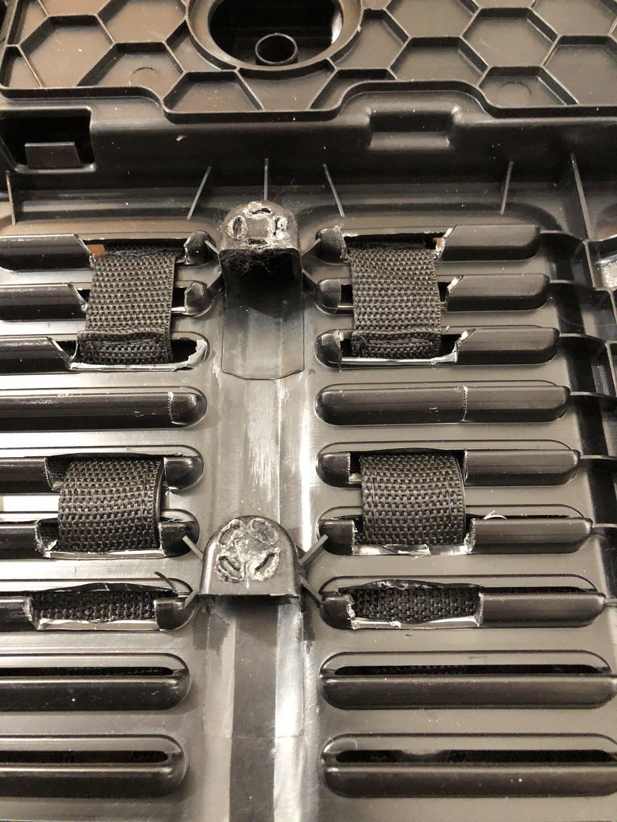

I did the same thing. I had to do a little trimming on the back side.

So theres no way to put the straps through back of the vent with out cutting the back like that ? if not what did you use to cut those piece off ? please reply back and let me know i want to take mine off instead of just having zip tyes right now. they sag with the zip tyes

How come in your photos you didn't have to cut the back of the vents off and other people did and they look to be the same size mollle bags?

You might be able to fish them through without cutting, it will be very difficult and the straps are not long enough to complete the weave. I uses a very sharp razor knife. Once you make deep scores, take a pair of pliers and just snap the piece off. Don’t force it. If it doesn’t want to break just keep scoring it with the razor. Pretty easy to do.
Good luck.

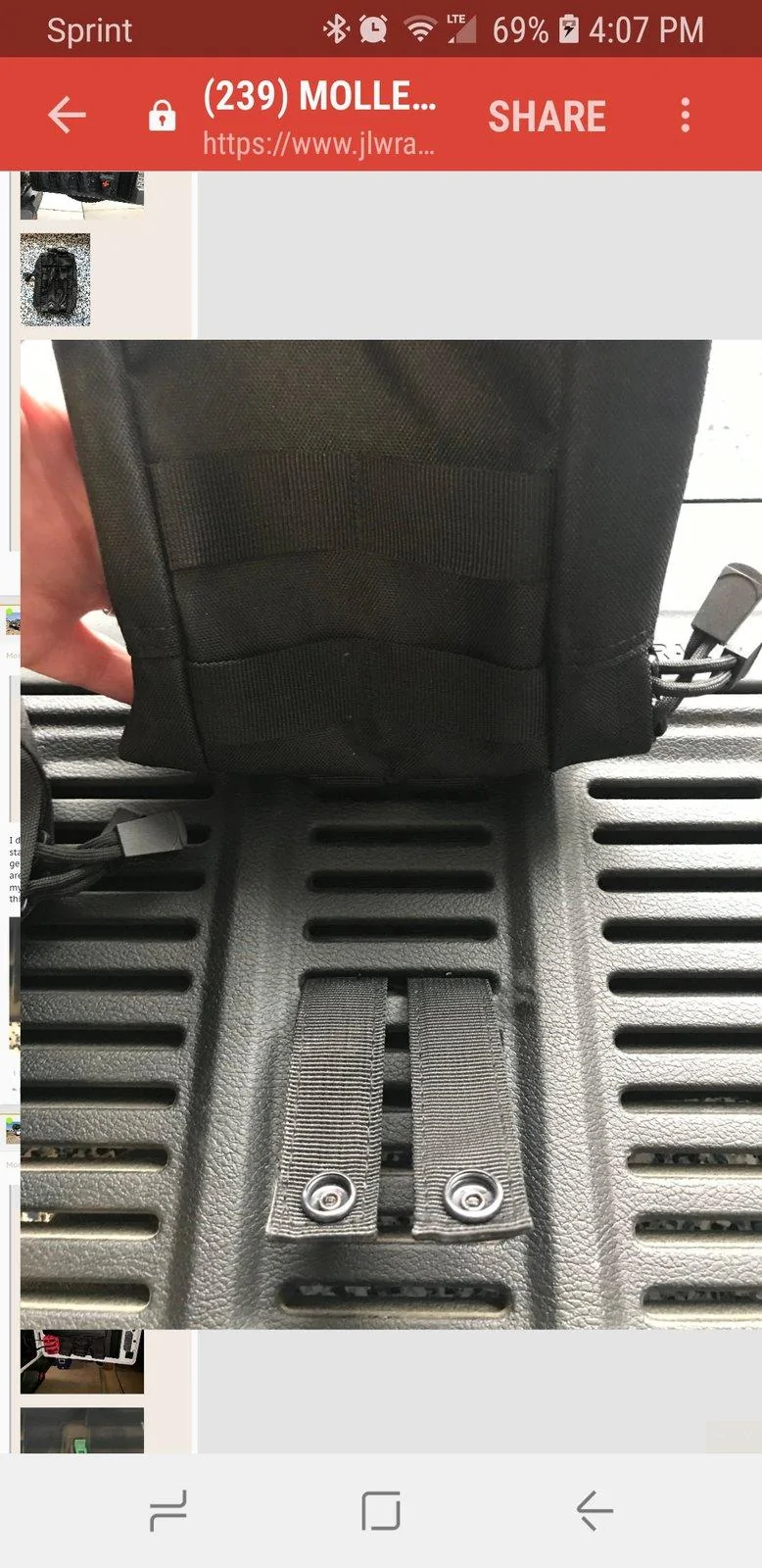

This picture here he did not cut the plastic he got them through I wonder if I can get them through on mine ?
Jeep Wrangler JL MOLLE bag tailgate setup Screenshot_20190117-160709_Samsung Internet

See how the plastics not cut wonder how he got them through ?

I’m watching this thread!!! I’m curious too, as I don’t want to break mine :facepalm:

But did you have to cut any of the plastic on the inside or just pry it through ? i really dont want to have to cut any of the plastic if i dont have to

It is possible to get them through without cutting. The snaps are tough to get through though. The main issue is you cannot weave because the straps get to short from going around the vent. End result is with out the weaves the bags sag. Just pop off the panel and check it out. It is simple. Good luck.
