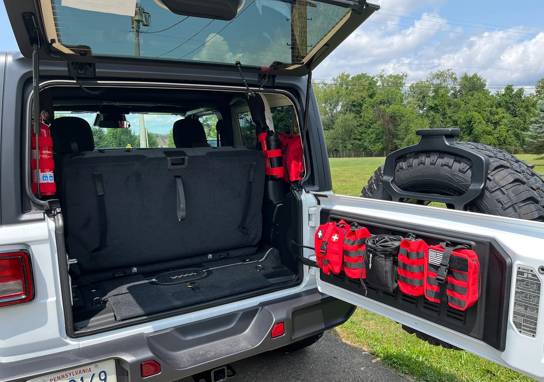

I decided to mount some Molle bags on the tailgate but really didn't care for the large panels sold and decided to make something.

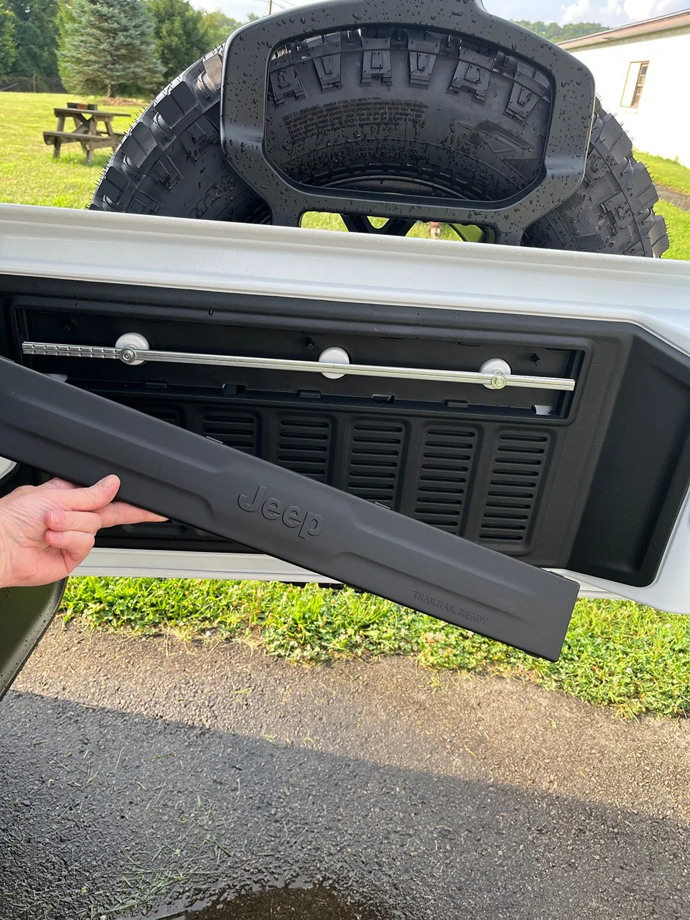

When I removed the top tailgate panel I discovered 4 bumps with treaded holes. Great. Had a hanging file folder frame with coated rustless steel rails just about the right size. Filed off about a 1/8" off the ends, drilled holes, and mounted with M6 bolts and washers. Just what I wanted.
