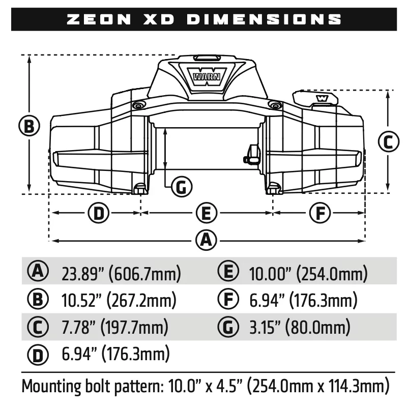

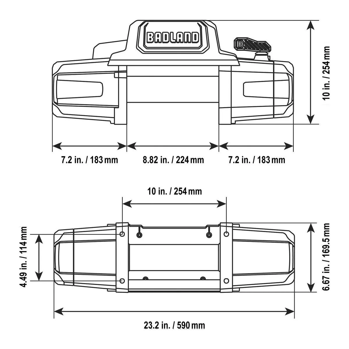

If I recall, the Badlands was smaller than the WARN. Unfortunately, I don't know of anyone using the Badlands with this bumper yet.
The badlands is actually slightly larger than the warn in at least the front to back dimension and I believe most dimensions. I had an issue with an early Next Venture front bumper where the gussets wouldnt clear the Badlands but did the Warns just fine. I ended up having to clearance it out to fit.

In theory looks like it should be ok although the only measurement missing on the Warn is the depth.

Hopefully they can give you a depth measurement of what will fit and you should be good. I ended up having to clearance like a 1x.5" notch into the gussets. Since then NV have modified how they do it cause of my issues actally lol

It's also possible the slope is different so while the edge of the Warn would fit fine maybe the Badlands would not. These measurements are just total height which I guess doesn't tell us anything either.
Maybe I have to wait until I can buy a Warn winch and the bumper. 🤣 My Badlands winch has give me nothing but trouble since I bought it.
