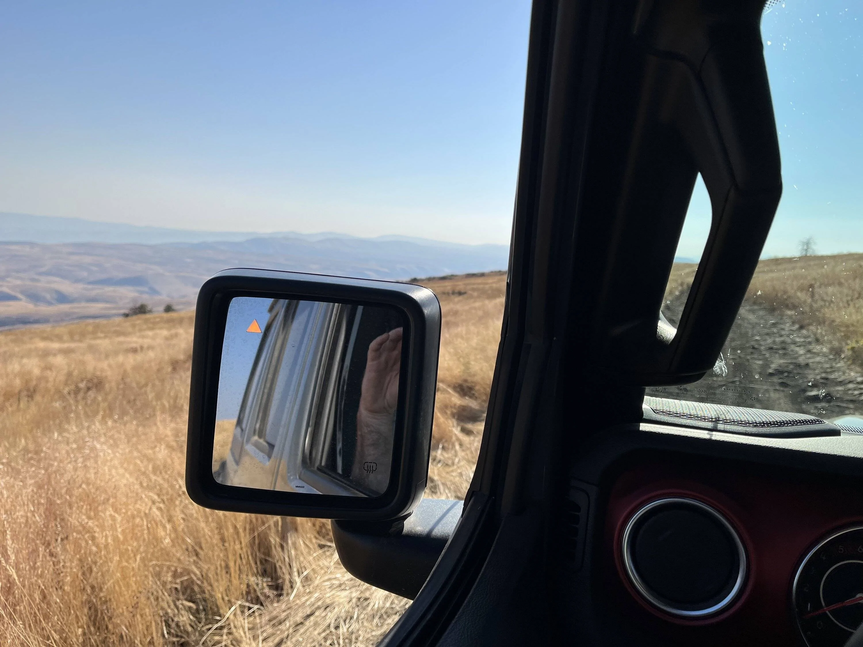

2022 Rubicon with all kinds of factory electrical voodoo on it. The only ads I’ve put on so far are a Warn winch and a GMRS radio, both wired directly to the battery. No previous issues with them.
I’m on day 3 of the Washington BDR so near constant 4x4, but slow and steady.
Today both of my exterior mirror warning lights came on and stayed on. I’ve checked for debris, dirt, bugs,etc but it looks clear.
Any ideas? Is it trying to warn me about something else sneaking up on me?

I have had that happen as well, it seems to happen when the tail lights get really dusty. I believe the blind spot sensors are in the tail light housing and when they are dusty they don't work.
Usually they will clear up once you are off the trail.

Totally normal when driving through areas with obstacles on either side for extended periods. Once you’re back to civilization, or a clear open area, shut the Jeep off, restart, and you should be fine.

Every time I’ve had the blind spot monitor warming fault indicator it has had to do with poor signal from the tail light sensors. Thoroughly cleaning both sides then toggling the warning off in settings, cycling the ignition off then on, driving a bit, and reactivating the system has cleared it. YMMV.

Bingo! I had cleaned the mirrors but hadn’t thought about the taillights.

The guys hit it on the head for my problem. Just dirty (dusty) taillights.

That’s usually the problem. It’s black plastic parts of the tail lights is what needs to be cleaned; the mirrors are just the indicator lights.
