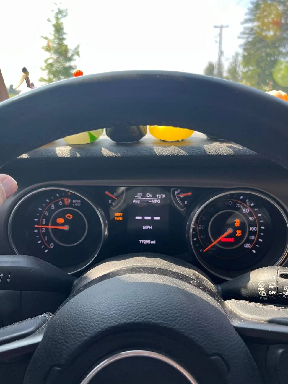

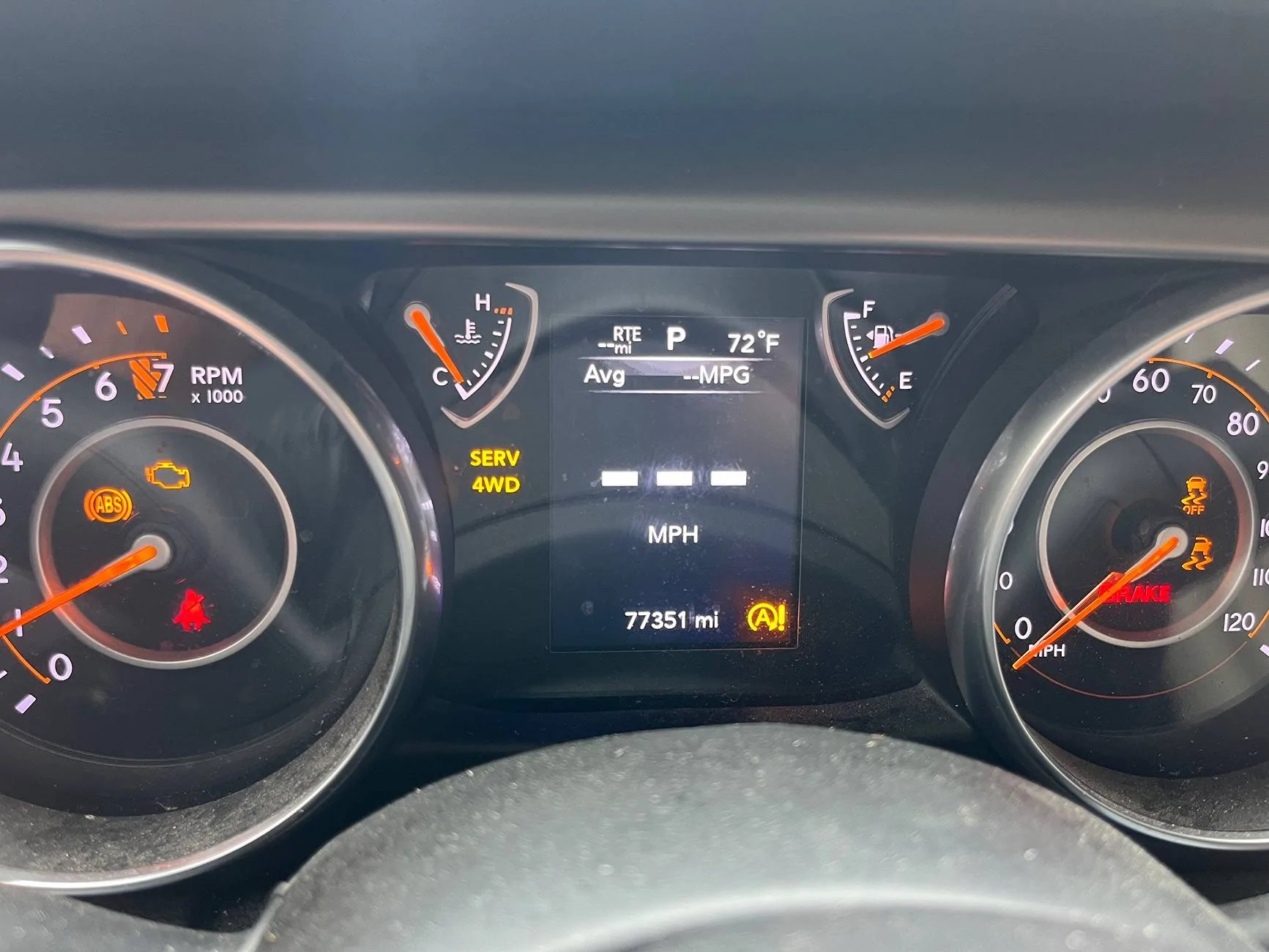

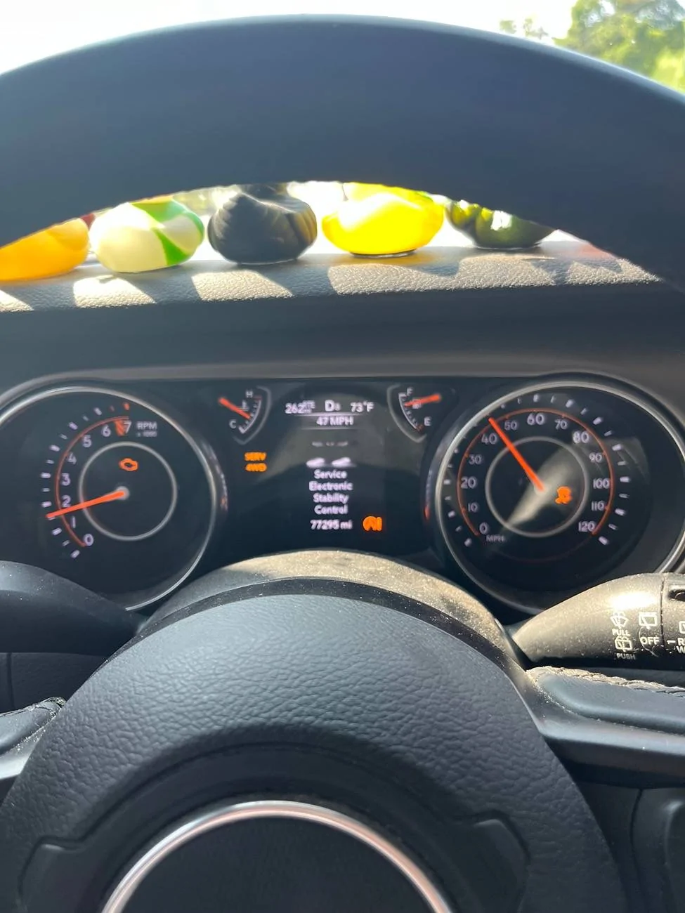

So while driving all my warning lights come on the dash. If I take the glove box out and “touch” the green harness the lights shut off and only my check engine light stays on for a couple days and shuts off. Any suggestions? Of course the dealership can’t find anything but keep replacing really expensive parts.

For the cheap price of the CAN connector, just replace it. You can often disassemble the old ones and see the burn spot on the circuit board. Or smell it.

You probably need to replace the green CANBUS connector behind the glove box.
Thanks I’m going to try that

@markbjeep
This is what's needed. I purchased my CANBUS spares on eBay, but they're NLA on that site. So, you might need to search a bit for an alternative source. I paid $13 for a set of two.
