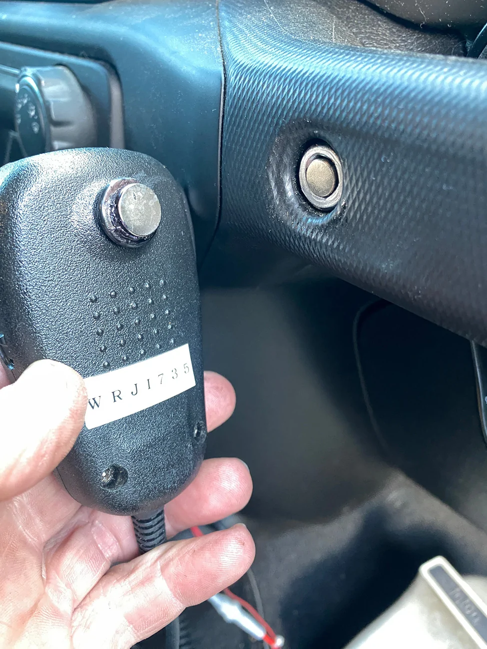

I didn't want to drill any holes, so I figured out how to make a very simple magnetic mount for my mic. I dropped a stack of 4 very small magnets into the grab bar mounting socket bolt head and glued a slightly larger magnet on the back of the mic.

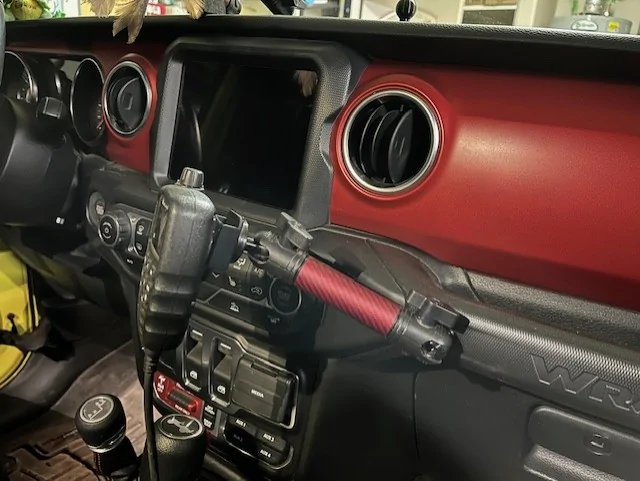

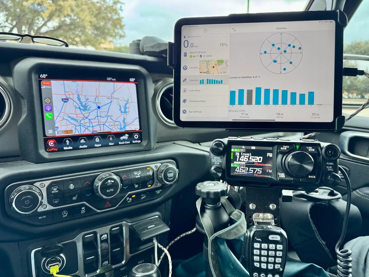

I keep my HAM and iPad on a heavy duty RAMMount pillar, using a radio/mic plate.
This way I can swing it all out of the way when I need to.
