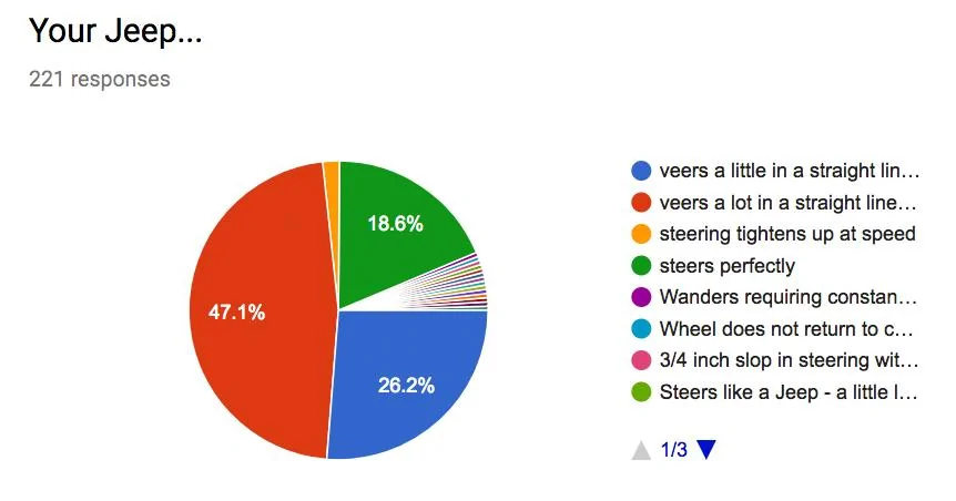

FYI: Someone created a steering issues survey.
1. Survey Results: https://docs.google.com/forms/d/e/1...xM0ZQzjhMVaXo8TICWUZN3xrsSpGo3g/viewanalytics
2. To add your data into the survey: https://goo.gl/forms/uWOyTgyqG6AnNdEY2
3. Spread sheet version: https://docs.google.com/spreadsheet...AMpdgKt1oA5sT_aXI-hoYMCg4/edit#gid=1437013635
4. I found this survey info here: https://www.jlwranglerforums.com/forum/threads/wrangler-steering-issues-survey.12343/
5. If you type in Google 2018 Jeep Wrangler JL, before you finish typing, Google adds steering issues to the end of the keyword phrase as the first suggestion. Obviously there are serious steering problems @JeepCares
6. Check out the recent spike in Google searches on Jeep Wrangler steering related keyword phrases below. Date range is 1/1/2004 to 8/27/18. Source: https://trends.google.com/trends/explore?date=2004-01-01 2018-08-27&geo=US&q=Jeep Wrangler steering. According to the Google keyword tool, there were 6,345 searches for Jeep Wrangler steering related keyword phrases in the last 30 days.
