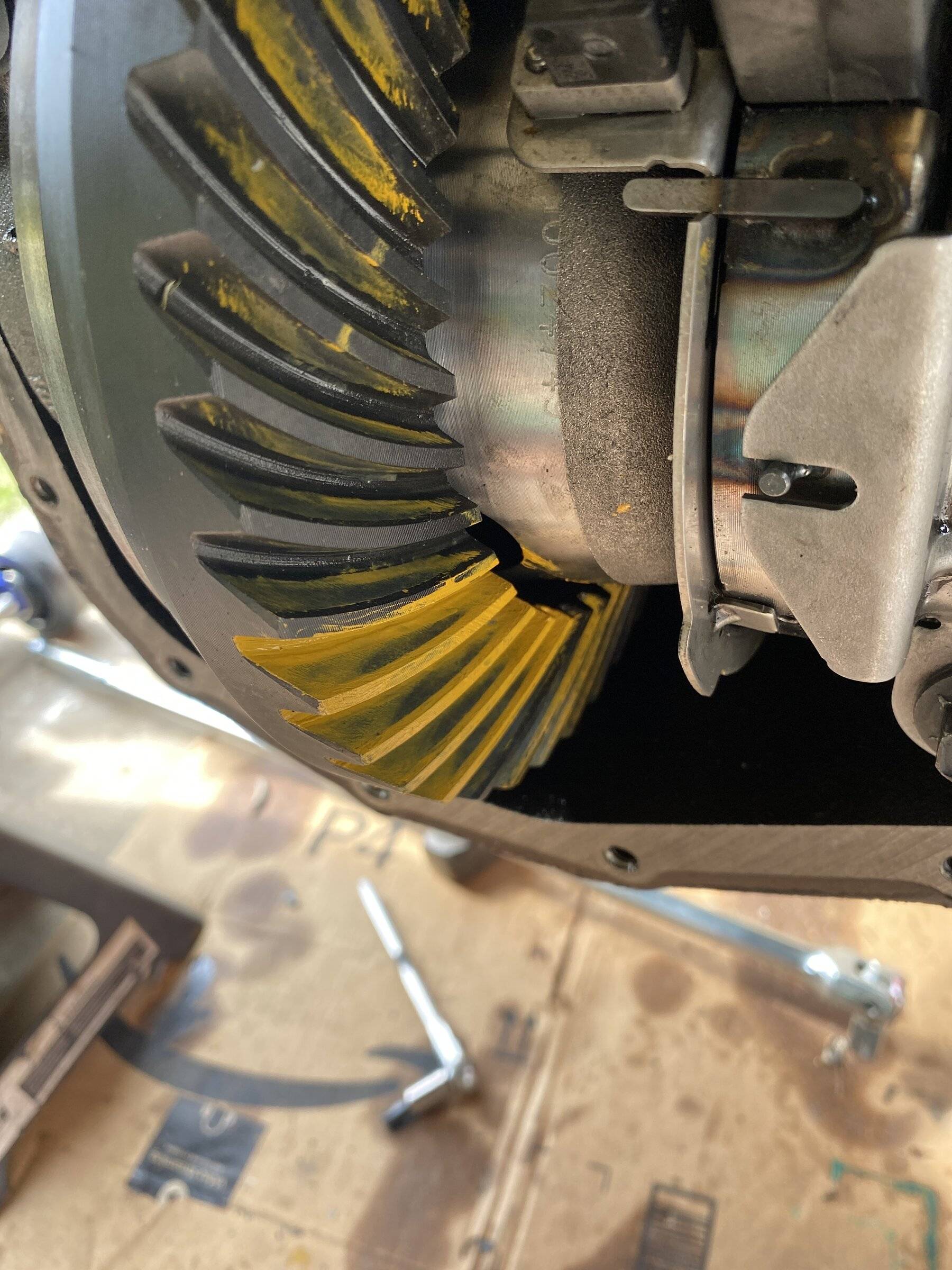

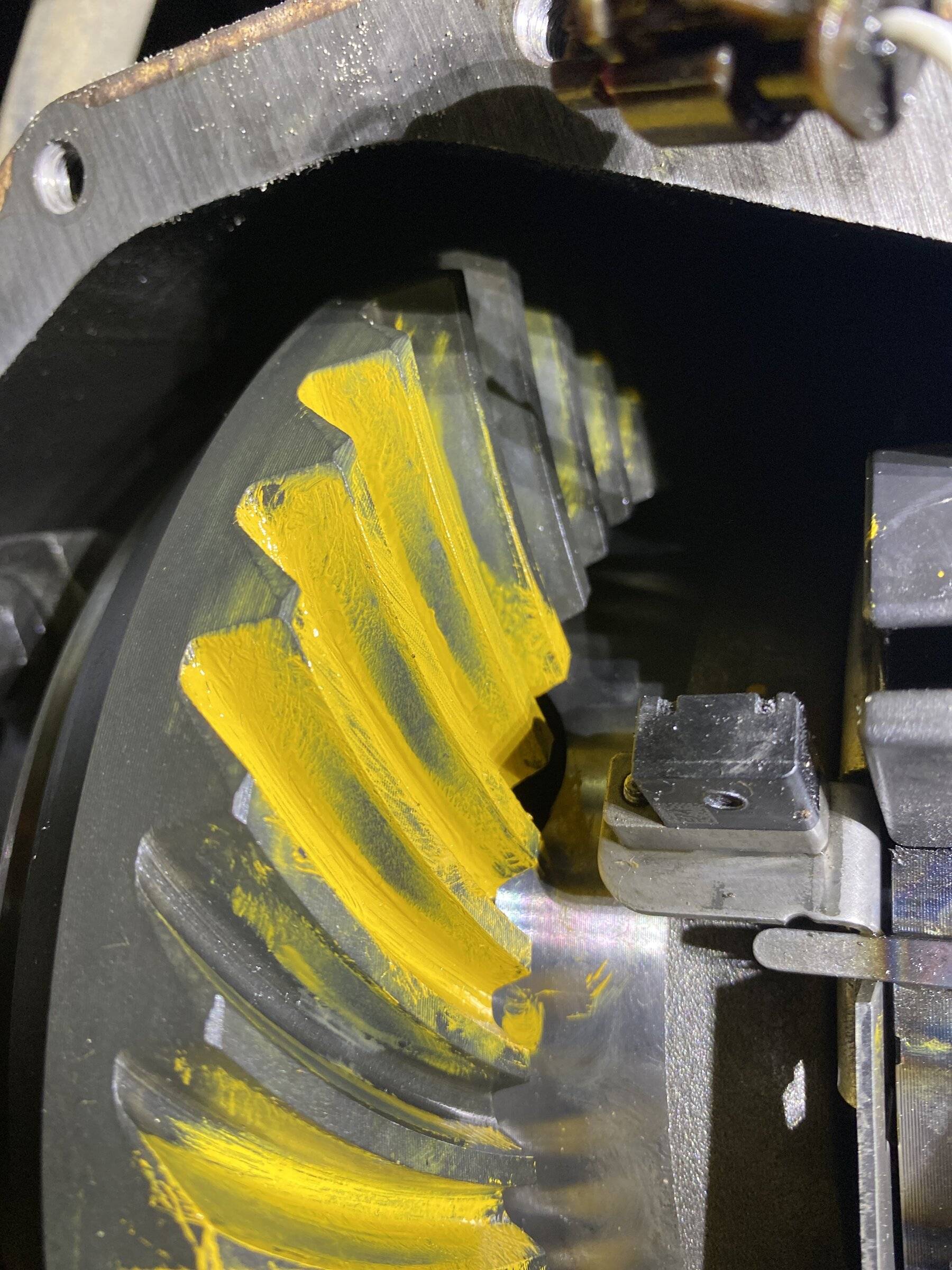

how’s this pattern?? Backlash is .006. the coast side used to match the Drive in this photo but the backlash was .011, so I had to move the shims Around. This doesnt quite resemble any of the diagrams in the Yukon gear manual, so im Asking the experts here ??

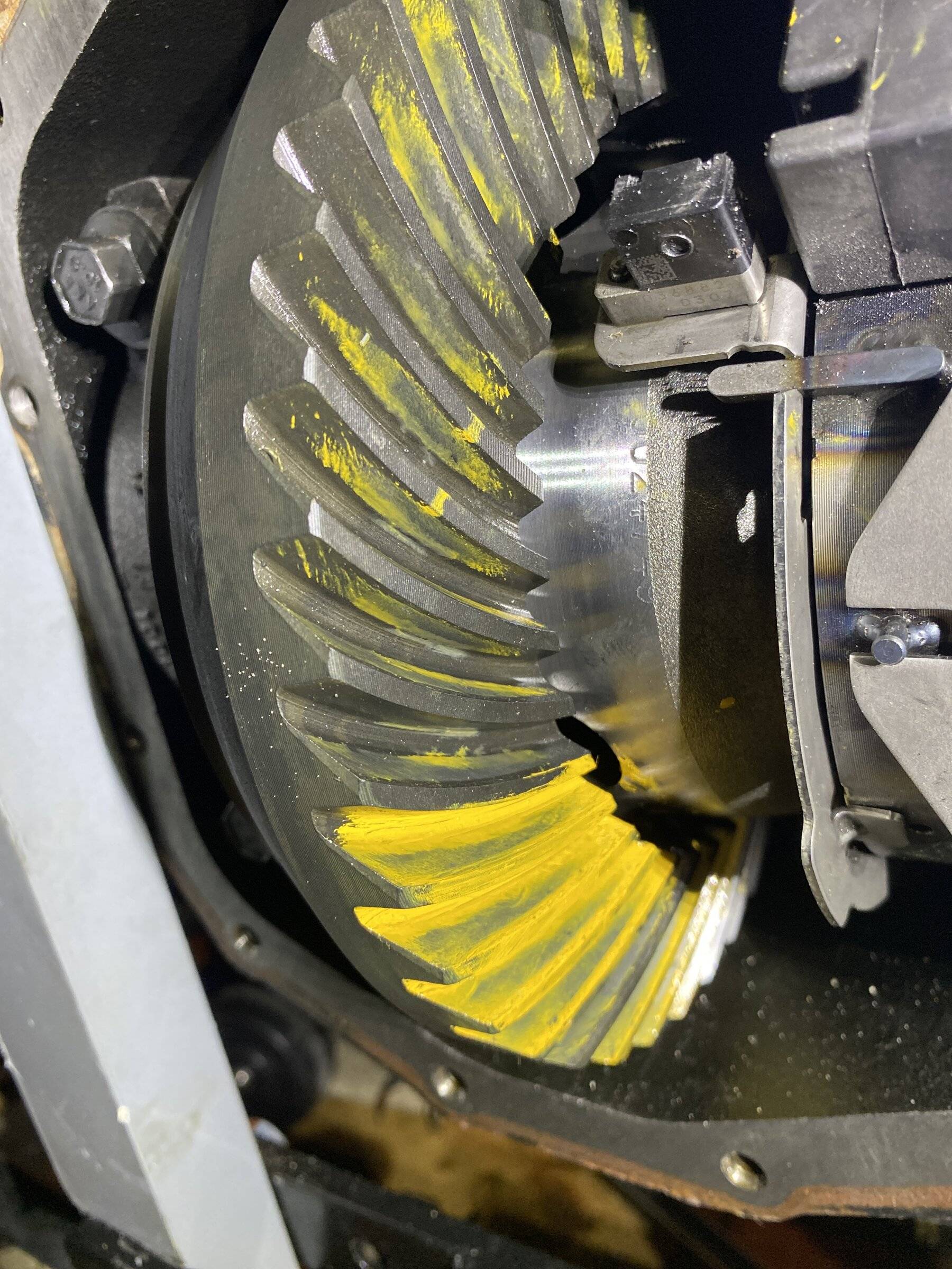

Took .005 out of pinion shim, backlash is .007 (within Yukon spec)

I potted the sensor and just got it all put together last night. Test drove this morning, loved it!
