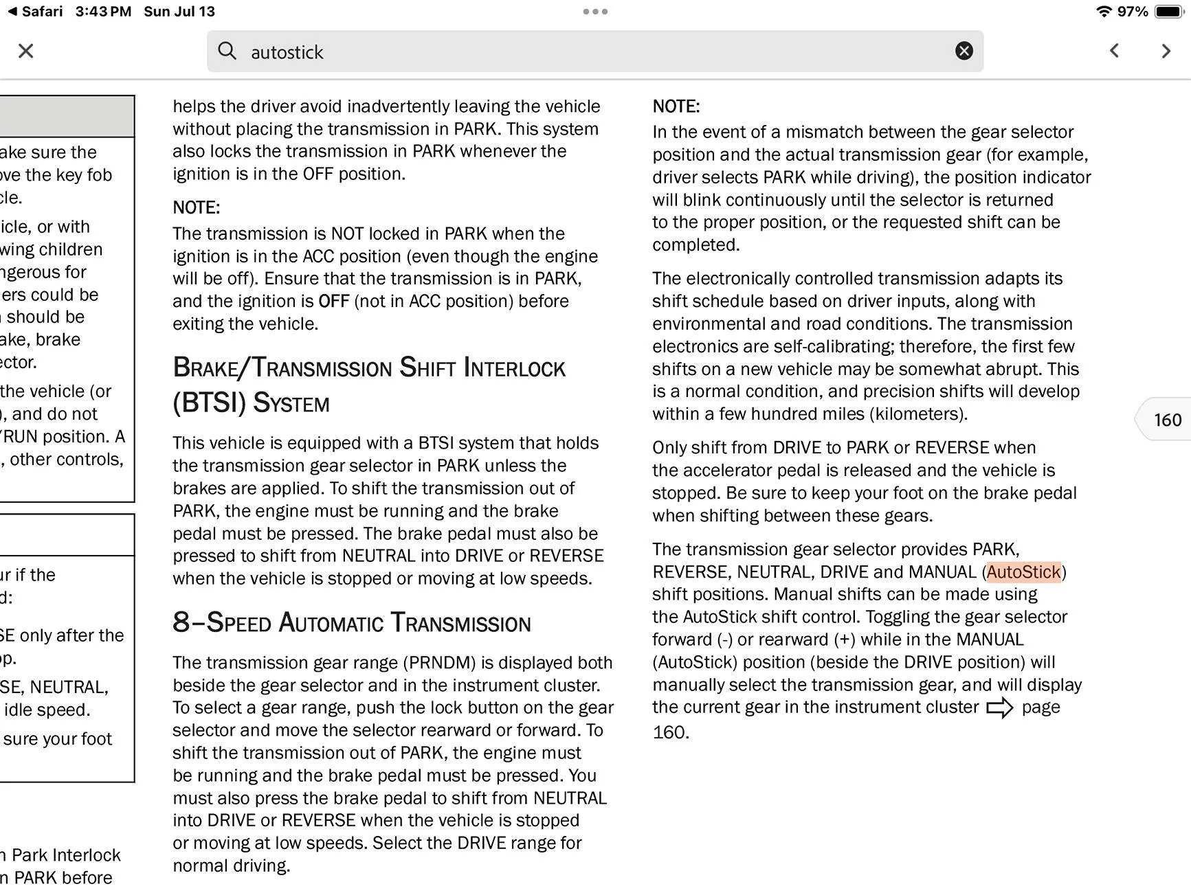

I like to use the PDF version since it allows you import it to Adobe Acrobat to search for topics using search terms. Of course not knowing it’s called autostick means you’d have to read through the automatic transmission section anyway.
https://cdn.dealereprocess.org/cdn/servicemanuals/jeep/2025-wrangler.pdf
The manual says that if you are in neutral, stopped or slowly moving, you MUST press on the brake to shift back into drive. That is NOT the case with my ‘21 JLUR. Pressing the brake to shift from N to D is completely unnecessary.

Well, guess what!!! The info I can now see here in this posting via the PDF file version tells me about the "autostick" operation.
However, after two front to back reviews of my 2025 Jeep Wrangler Owners Manual, I gotta tell ya there is NO PLACE WITHIN THE BOOK..........FRONT TO BACK. That gives me that info. If it's in the printed owners manual for 2025, let me know what page that happens to be.

Page 160.
