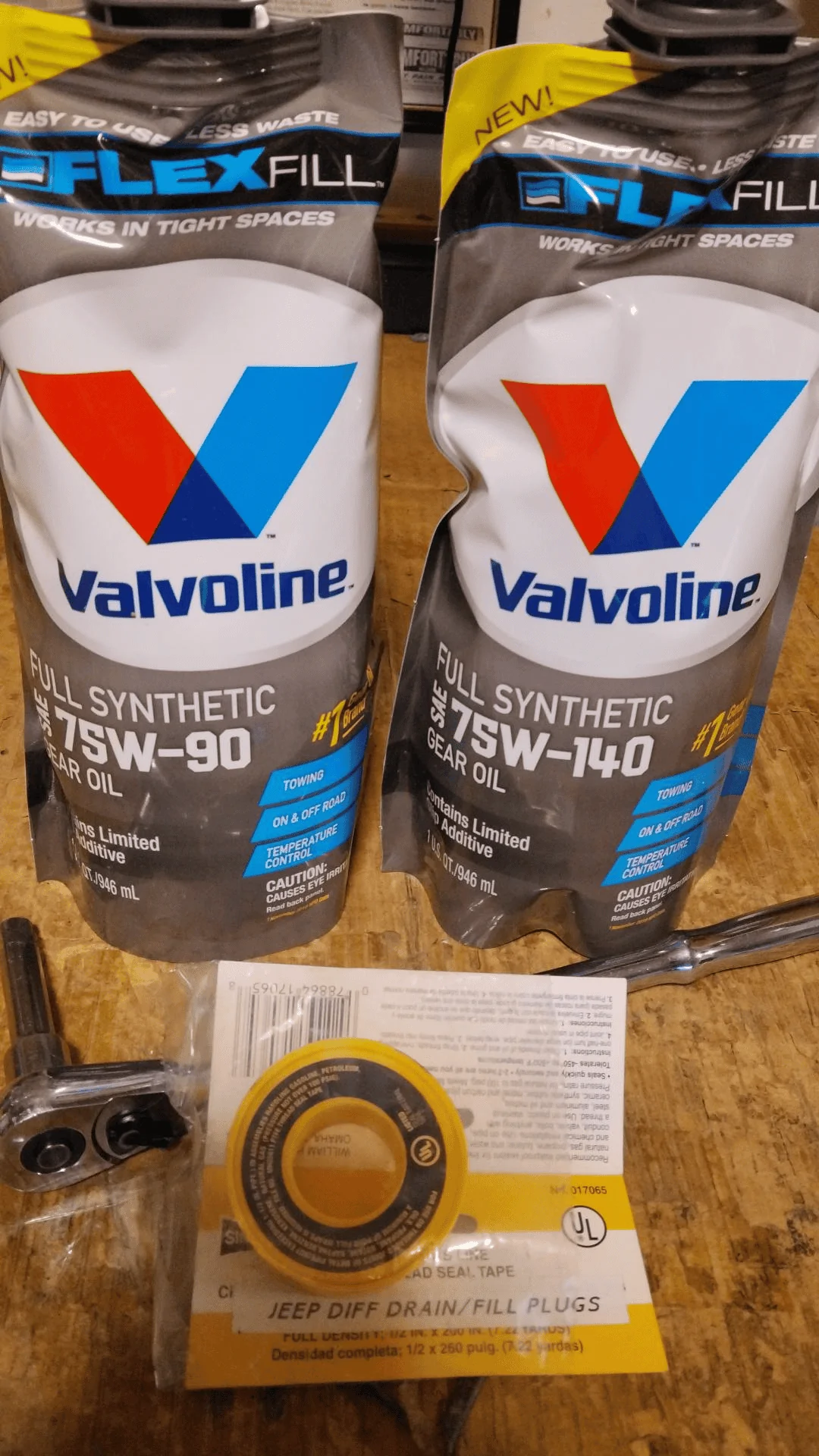

Just curious...I've always used teflon tape on differential, transfer case, and transmission drain plugs over the years, but wanted to see what everyone else does. Teflon paste seems like it might be more secure, but I have no experience with it. Any recommendations?
While were on the topic, the torque specs listed here in the forums don't specify which differential they pertain to. I've got the 345 with LSD on my 2-door Sport, but still can't find a definitive reference for front and rear in this trim level.
I use yellow gas line tape. It's a bit more robust than regular plumber's thread tape.
Arguably, the use of tape or sealant on the drain plug is redundant, but that's precisely what I want here.
Agree...I use the yellow gas-compatible tape too. Looks like you may have also replaced the drain/fill plugs too, no? That seems like a good idea, although I'm sure most folks don't do it.
Been a tech for a lot of years, and I'm sold on the gear oil pouches. I love that if the access is poor, you can bend them around the obstacles and still fill without making a mess.
