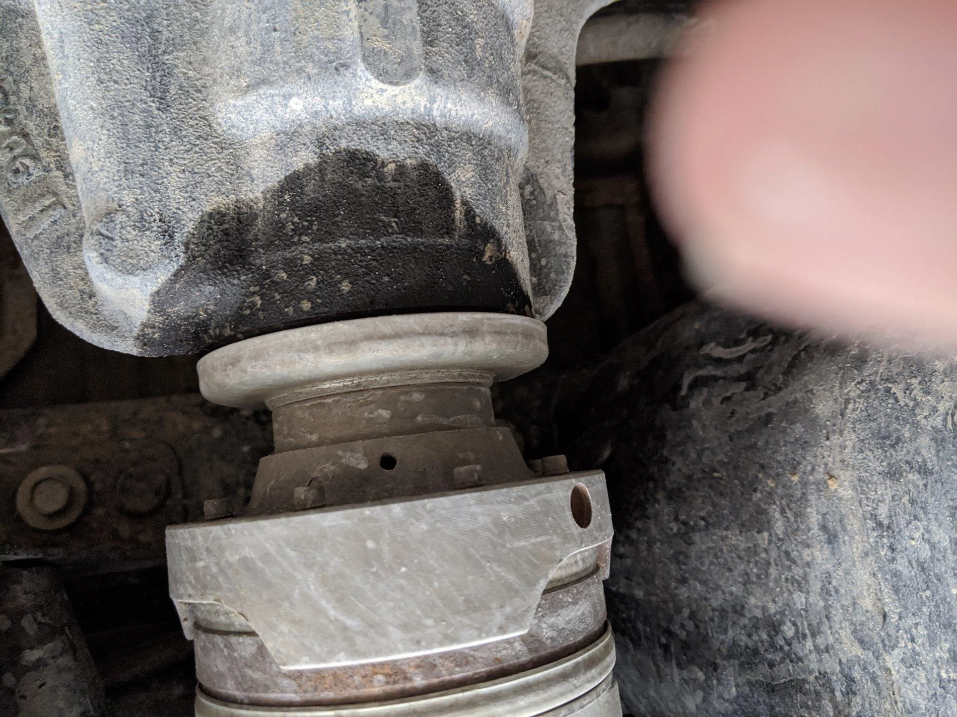

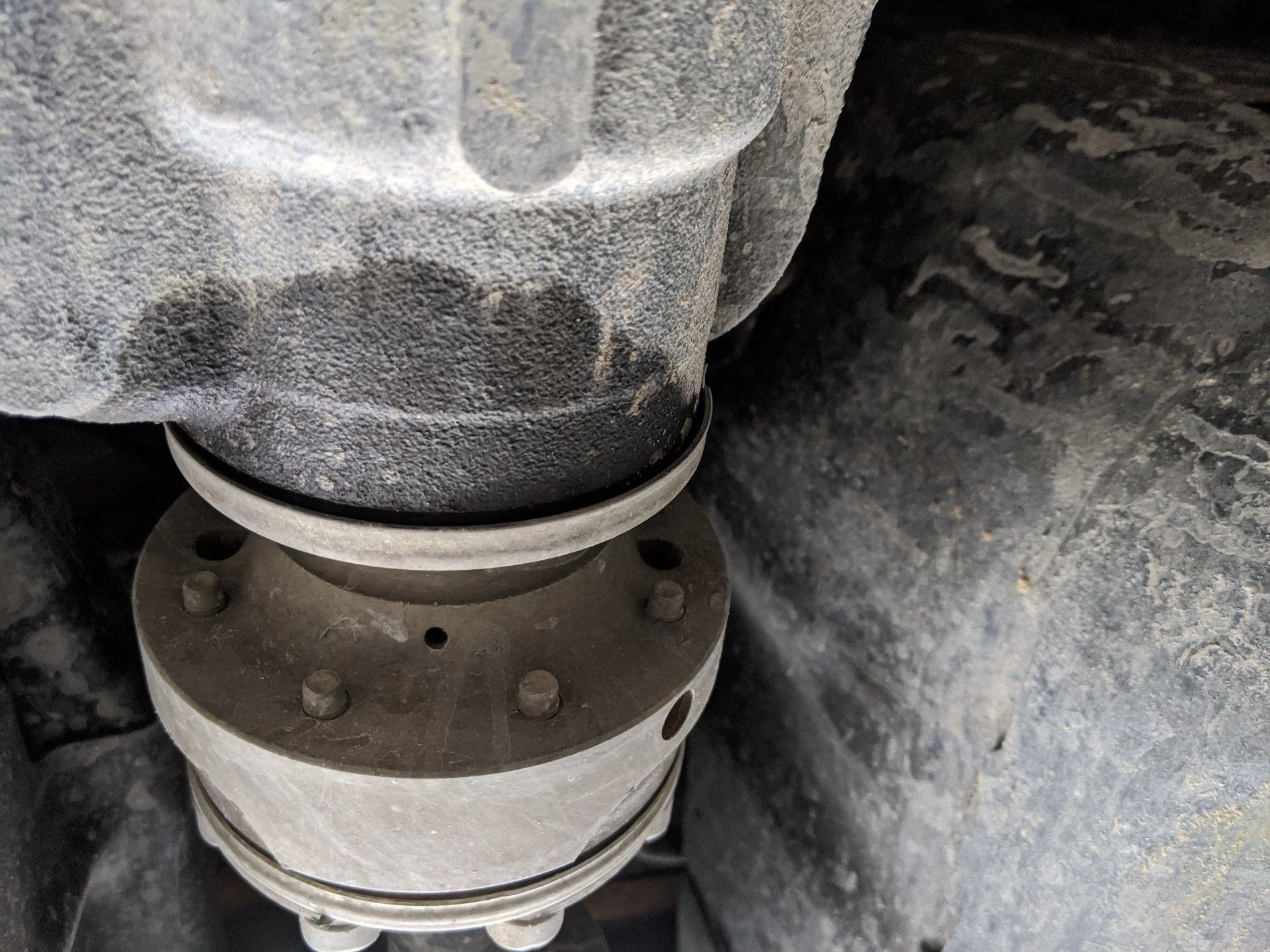

I was poking around today under my 2019 JLUS 2.0, and noticed this darkened spot on the front of the rear diff (19k miles, BTW). I've never had any oil spots on the garage floor, and the darkened spot is not 'wet,' so to speak. Before I take it to the dealer under warranty, I thought I'd check here to see if anyone has had a similar experience.

Yeah, looks like it time for a new input shaft seal. Also, is that the Dana 44 w/ lsd? I ask because of how dark that looks.

Thanks Kathryn. The local dealer wasn't concerned about it. He said it was more than likely grease from the bearing, and not a diff leak. He said to watch it, and if it becomes 'wet' or dripping that I should bring it in..

Spray it down real well with some simple green, if it comes back then take it to the dealership for them to fix. Just because it isn't a serious leak now doesn't mean it wont become one in 10thousand plus miles.

Thanks. Great idea. I'll crawl under there today and clean it up real good..

Curious how you could tell how dark the oil is by looking at a “wet” spot against black paint.

As I said in the original post, it wasn't 'wet,' just darkened. I've since scrubbed it clean to see if the spot re-appears.
Yes which is why I put “wet” in quotation, because I know oil stains can appear “wet” on a surface without feeling the wetness.
Like I already said, how could the poster tell how dark the oil is when it’s against black paint.

I've spent more years than I'd like to admit chasing wet spots on trucks and heavy equipment. I don't mention that to imply my being the definitive authority on wet spots, especially one in a photo on the internet. That's why i said it looked dark, rather than saying it is dark.
My train of thought was if he has the lsd rear, it would be a wise idea to give extra attention to condition of the oil. If it was blackened at all by premature clutch wear, it could be nipped in the bud now, rather than later when more backordered parts would be needed.
Also, to the OP, the input bearing is bathed in gear oil not grease like the dealer tech told you. Hope it gets sorted for you.
