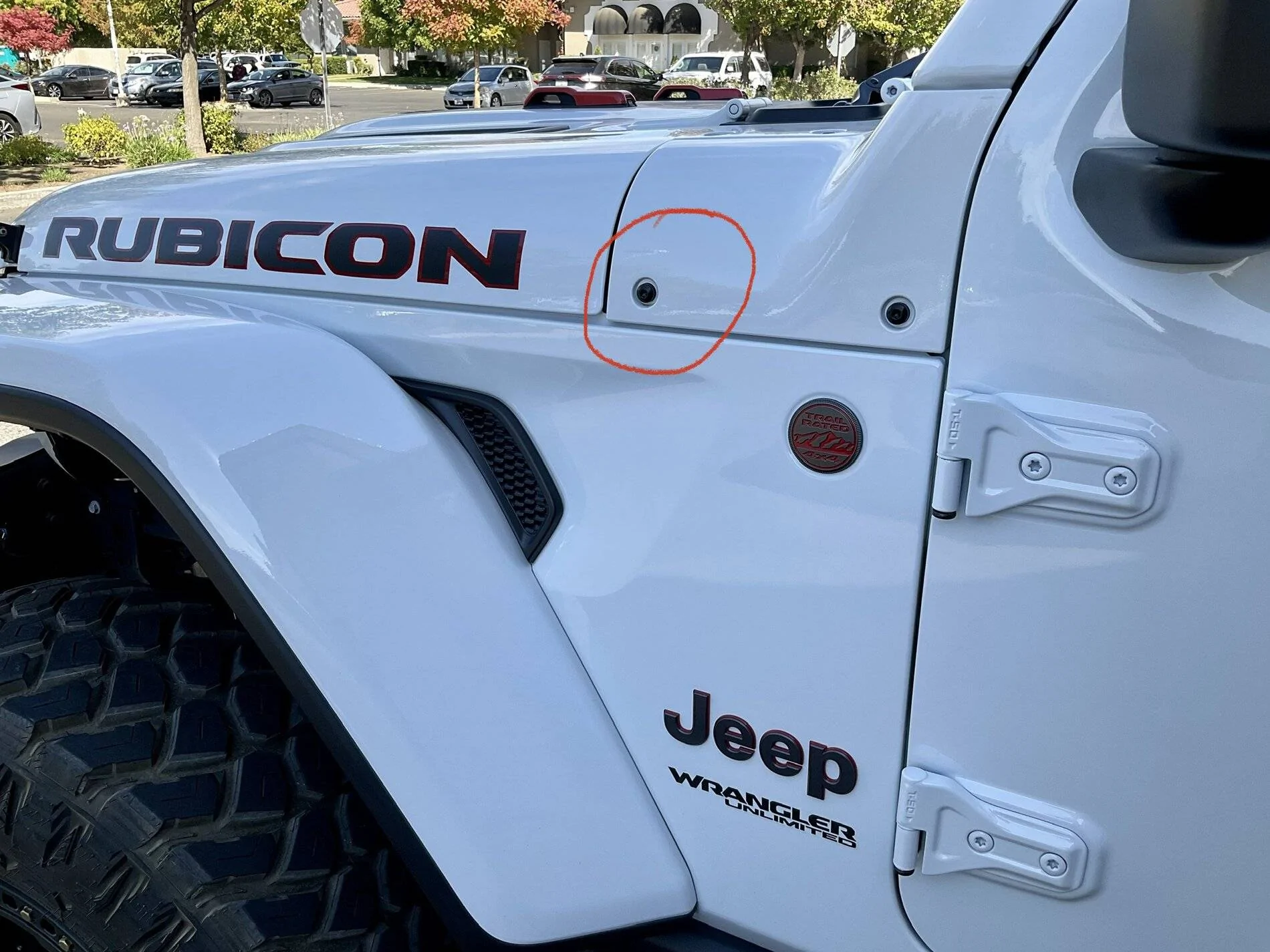

Hey all, I searched and cannot find this.. I need a single A Pilar mount bracket for a single cube to bolt in using the single bolt circled. Reason being, I need to still be able to get the windshield down for wildlife photos and, who needs 3 bolt holes and a huge bracket for a single cube anyway…
Anyone know of who makes them, or even if they are available? Thanks.

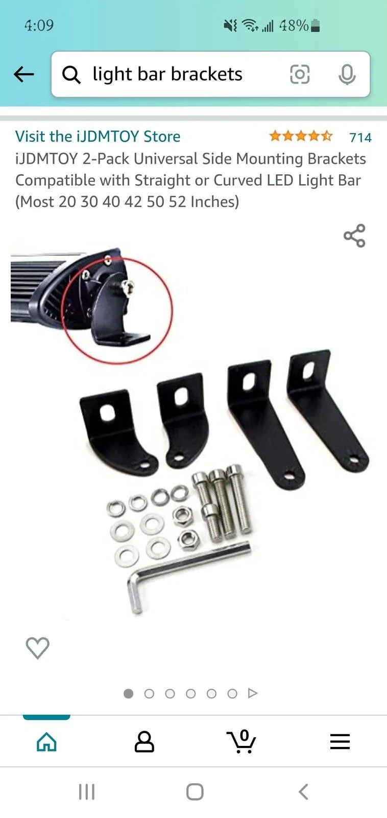

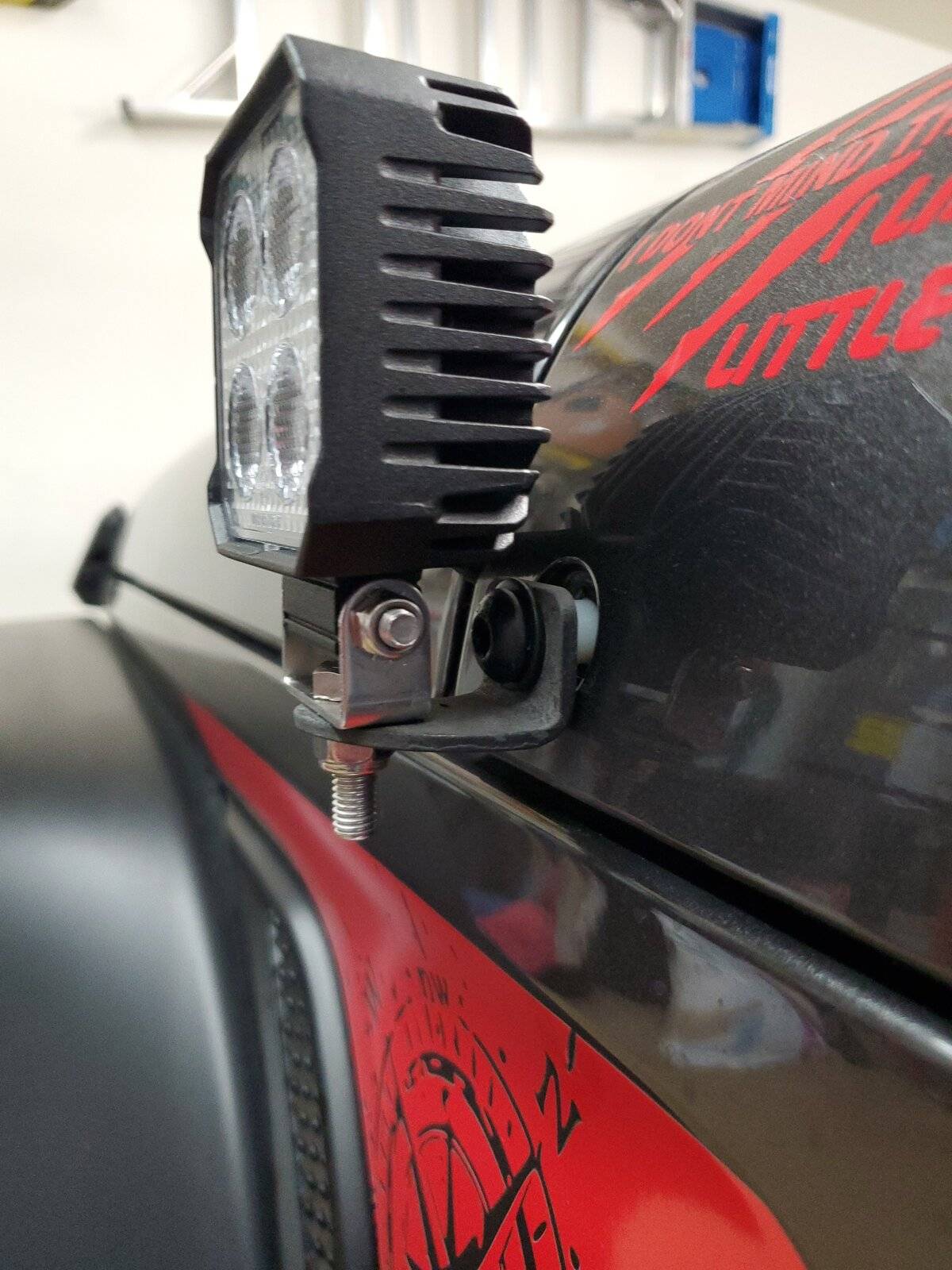

Not a cube, but I used light bar brackets for these lights. Used a 1/2inch spacer to keep it off the body. I used longer bolts to compensate for the spacer.
Jeep Wrangler JL Lower A Pilar Mount Using One Hole for a Single Cube 20211017_160821
Jeep Wrangler JL Lower A Pilar Mount Using One Hole for a Single Cube Screenshot_20211017-160947_Amazon Shopping
