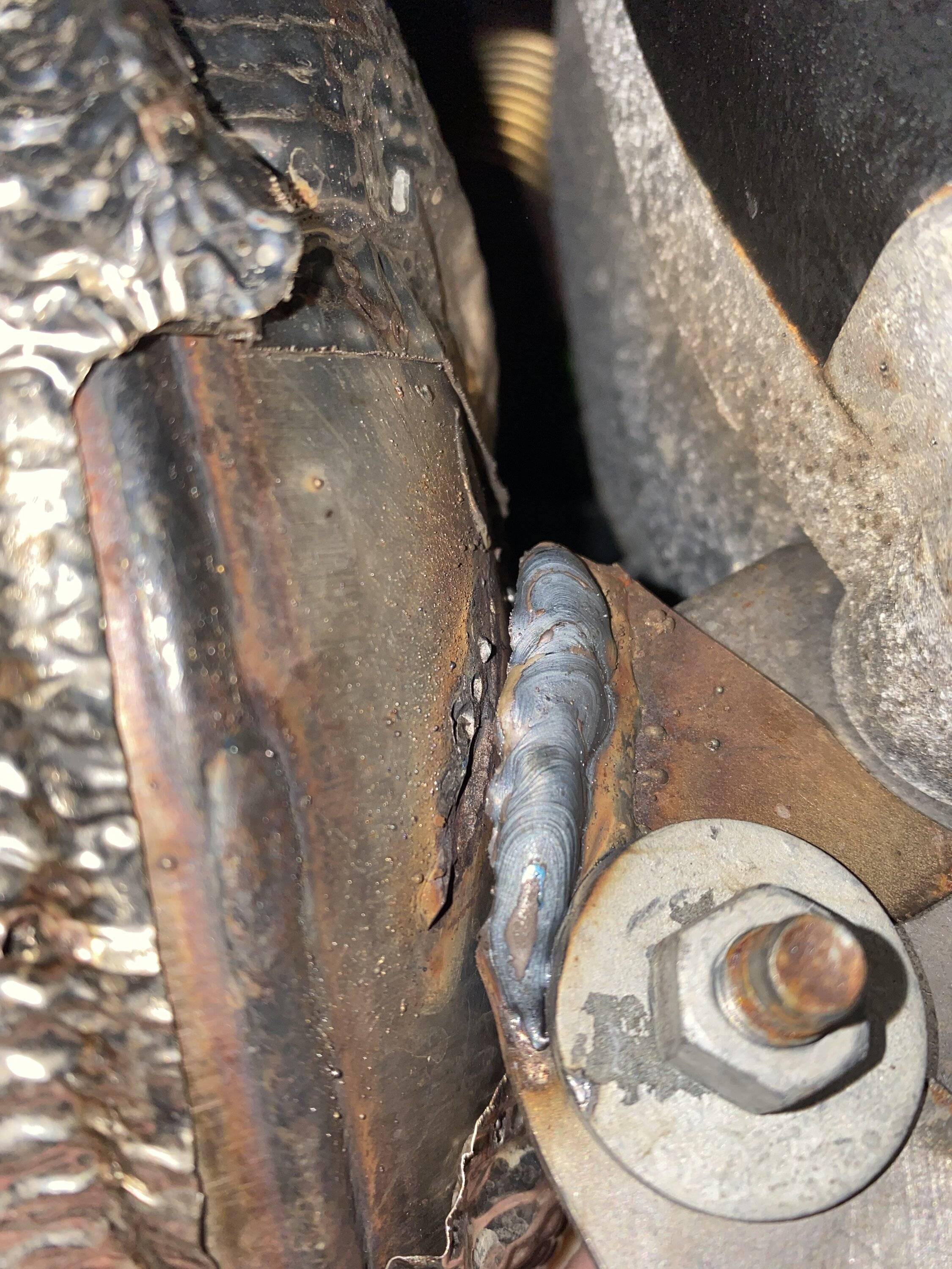

If you have the 4xe might ask over there in that section, this is DPF system that has a weak weld from the factory for the 3.0 diesel.

I just got my 2021 JLRUD back from the dealer and they said it was a broken bracket for the exhaust system. They are on back order because of the strike. Same rattling noise at idle.
